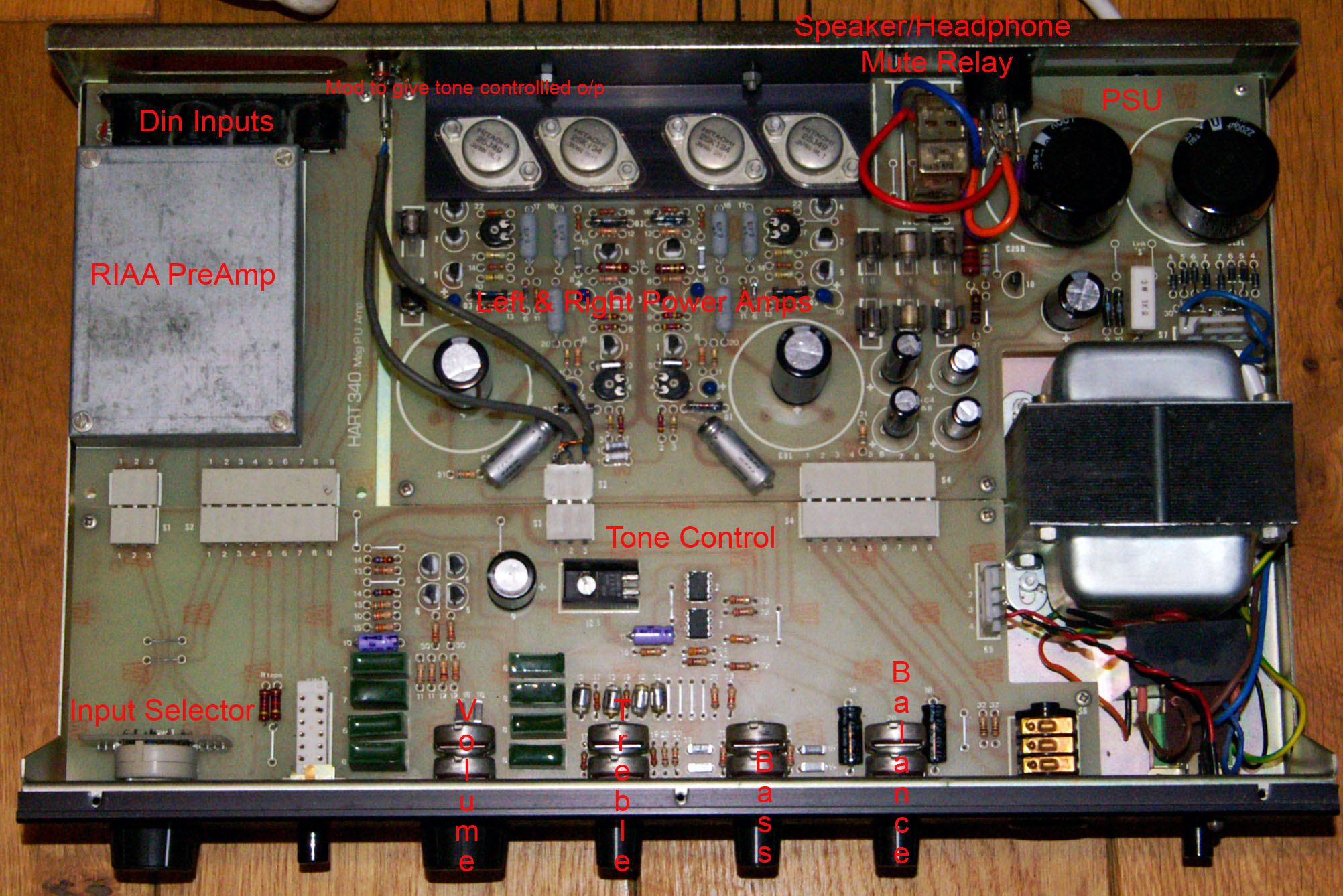

Do you by any chance have pics || schematics of your current setup ? You say you are happy with it's sound, maybe it's an idea to mod rather then to buy new ? As said by Ian, there are lots of modules available to do extra inputs or motorized volume knobs ...

I haven't any photos of my current amp but I will try and take some soon.
I have the original schematics from John Linsley Hood's articles along with the Hart Kit details. If I get a chance I will scan and post them.

Thanks for sharing, pnb. It seems a good build of a reliable design, as I knew of it.
With the main caps in good condition, it might be just great for the new preamp to work into.
Unless I'm mistaken, it appears that the front panel is removable so perhaps you could make a new one eliminating the tone controls, disabling the preamp and giving space for a display panel and remote sensor. You may then even be able to replace the volume control with a rotary encoder. A bit radical, but it would save the 2-box arrangement and duplicated controls...Thought?

I replaced the caps a couple of years ago so they should be ok for a bit.
Its only shortcomings, ignoring extra bell and whistles, are that PSU is too simple and there is audible hum and that the speakers are not 'protected' from turn and off thumps and burps.
Yes that may be possible to replace the preamp section, the outer extrusion hides the upturned steel chassis base so I could easily remodel the steel work and then cover it up with a new ali fascia.

Yeh, keep the PSU and RIAA and Output boards.
remove the volume/tone control stage and replace it with some buffered inputs and a +6db/+12db gain stage for any low level signals you might come across.
Consider adding a +5V PSU and a LED/LDR volume control.

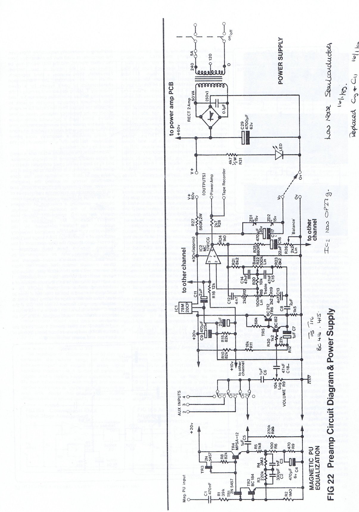

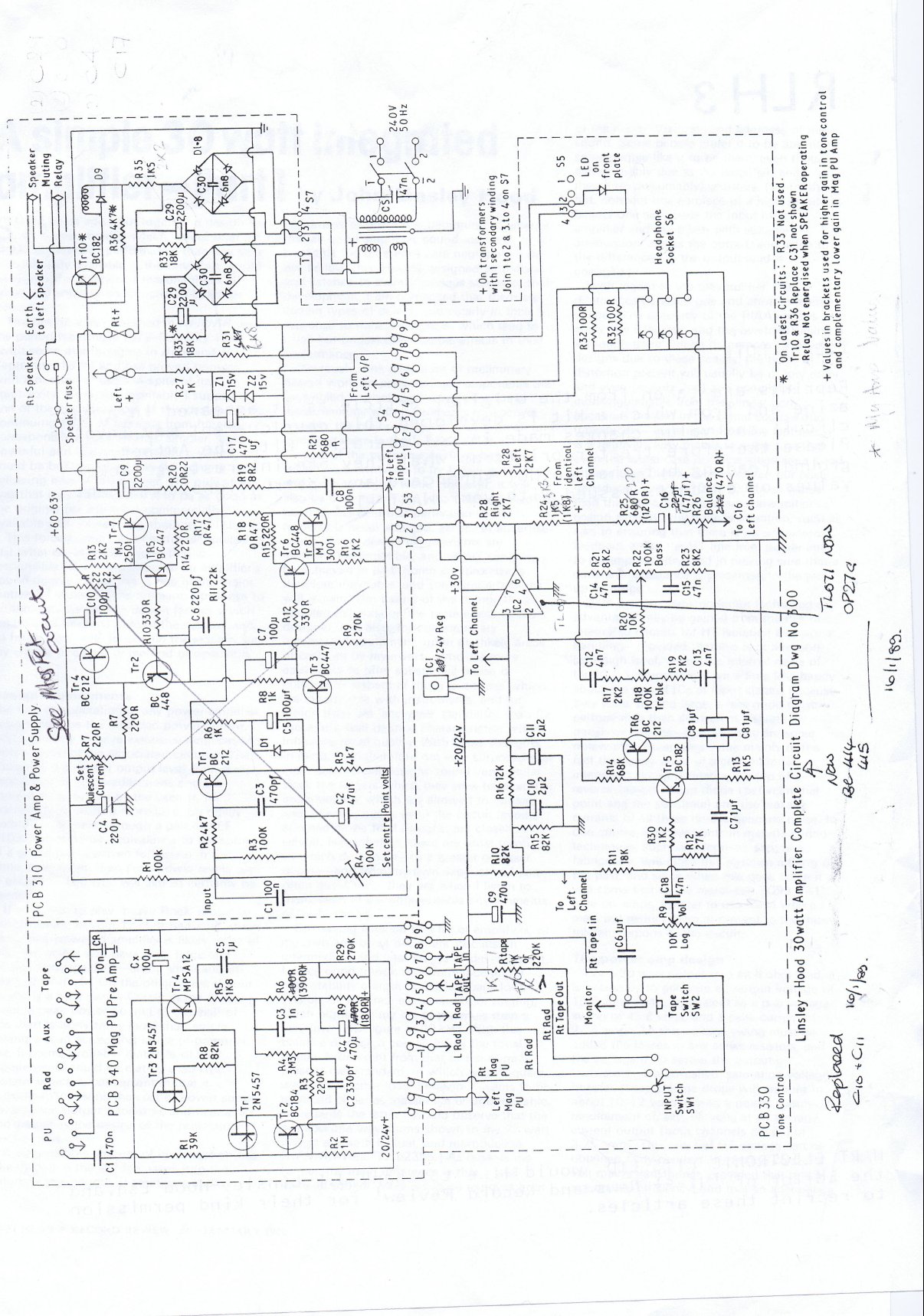

A friend has kindly scanned the JLH articles that detail the circuits I currently use. I hope it is of interest.
I can't believe they are 30 years old !!
The first is the overview with a complete schematic, except for the power amp. This is because JLH first designed it with epitaxal output transistors but then later in December that year converted it to use Mosfets.
The modification was slight but effective.
pnb
