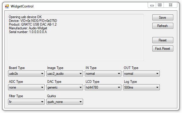

Could you post a screen shot of "widget_control"? (immediately after start-up, without changing anything)
Currently I have firmware audio_widget_20121004_AB-1.2.elf
However, this problem still exists.
Screen shot of the widget (with windows). In attachment...

Yes, there is a widget control program for Linux (and other systems, too). Though it will not work on the console. You'll need an X11 display (*).Screen shot of the widget (with windows). In attachment...
Is it possible to check this on the linux console without @#% M$ ?
It's the one written in Python: "WidgetControl.py" and related files. Download them from the git repository:

I use widgetcontrol. It is a gui less tool. You can list all the features with the -l flag and set features with the -s flag.

Oh! Interesting, thanks. I missed that one.I use widgetcontrol. It is a gui less tool. You can list all the features with the -l flag and set features with the -s flag.
Is it up-to-date with recent firmware changes?
