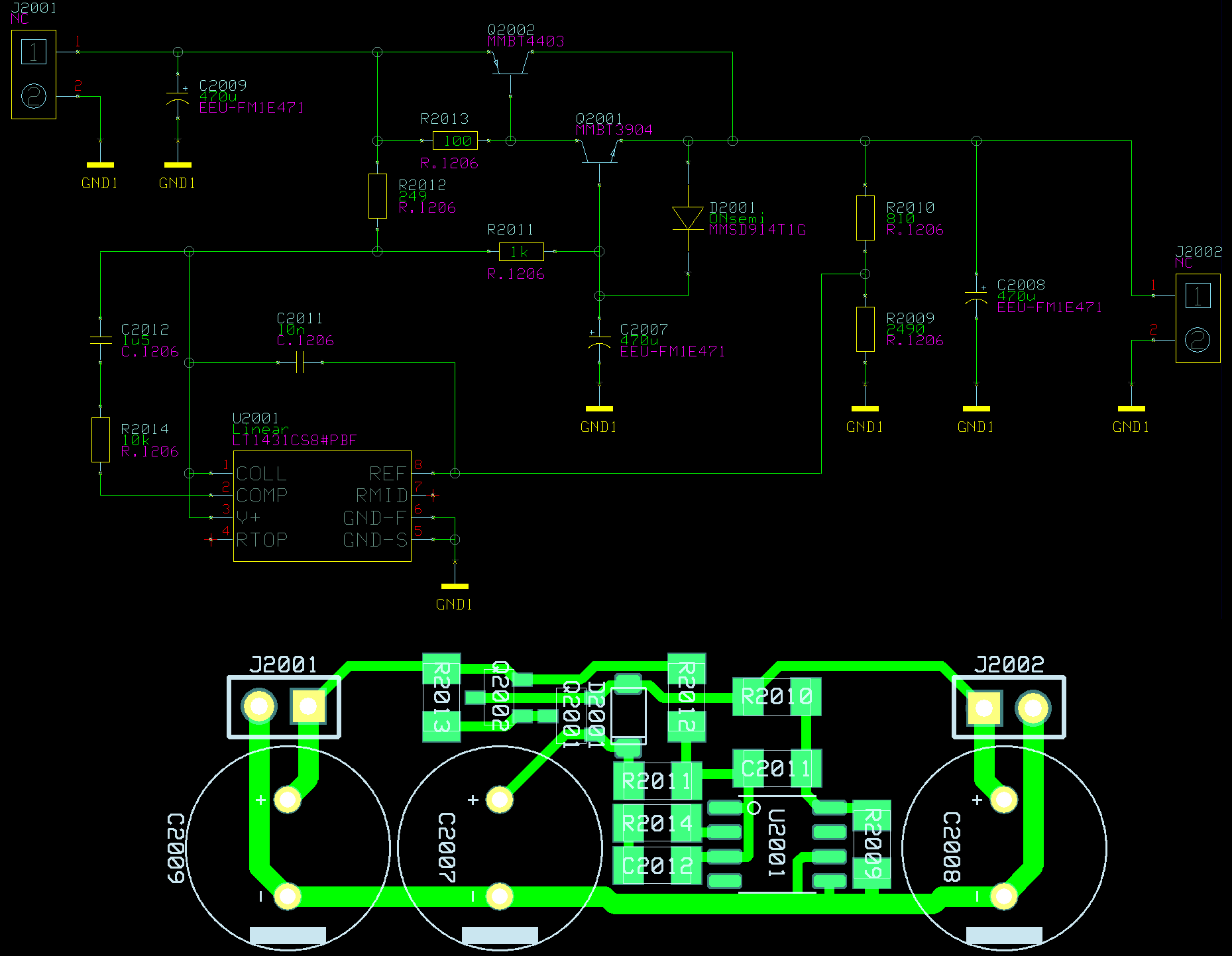

Regulator Update
Here is a draft sch and layout for the regulator which has been discussed here lately. Any comments?
I plan to put 3 such regulators on the AB-1.12 prototype board. The regulators will not be connected to other circuitry. It will be easy to patch them into points of load at the two XOs and at the DAC.
Børge
Børge
Please check on the power dissipation on the pass transistor Q2002. I would think 150 mA would be the max (the whole AB1.1 draws less than 250 mA). So 150 mA X 1.7V = 255 mW. I don't want anyone to have unpleasant smoke appearing so you may need a larger package and some PCB heatsinking.
