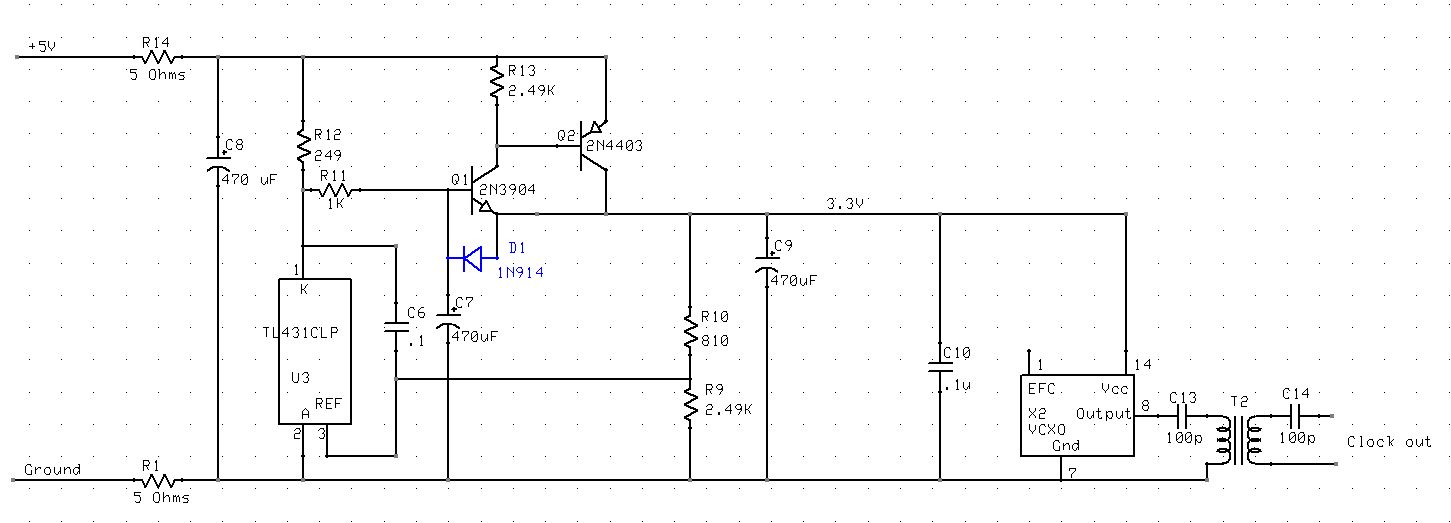

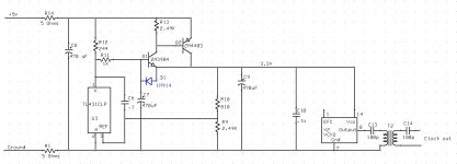

Latest version of the power supply + clock
Below is the latest version of the supply regulator as it was intended to be used. The transformer isolation is also shown. The idea is to remove as much stuff as possible from leaking back into the oscillator. The secondary of the transformer should be connected as close as possible to the clock distribution/clocked device. The 100 pF caps will probably need to be bigger.

Demian.
In version AB1.1 is impossible to put R1 5 Oh. : (
Unfortunately I just finished the boards without resistance R14. : Eek:
Do you think it is absolutely necessary? Is it for protection or improvement on noise?
I'd have to cut tracks and add in half if necessary. : (
Neither R1 nor R14 are necessary. They help to isolate the oscillator subsection from nearby noise. Without them you just need to be very aware of ground connections and currents on shared grounds.

Hi Demian,
thanks for the schematic. Do you recommend one regulator circuit per XO? Do you also recommend it for the DAC chip?
As you know, the XOs on the AB-1.1 are shorted together with 68R resistors while their enable pins are in opposite phase. I don't know how much is actually turned off in there then.
Børge
