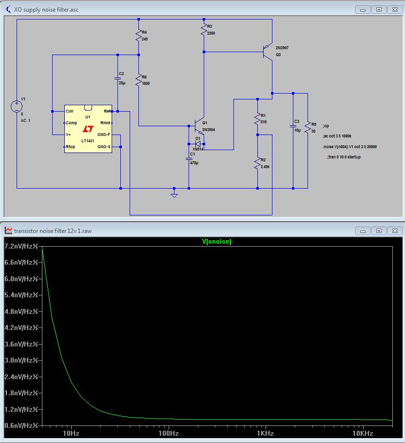

Hi Børge.
Why not add the regulator board suggested by 1audio and tested by oneoclock? At least settle for a set of connectors so it can be added easily afterwards.

Thanks for the link, but I think that paper has a few flaws.I have read through the paper on the J-test signal at http://www.nanophon.com/audio/diagnose.pdf
What strikes me is that this input signal is designed to fool a clock regenerator / AES3 receiver to generate its maximum amount of jitter. This is done by transmitting what is essentially the same fs/4 signal with mainly zeros or with mainly ones. A full cycle of zeros... ones... has a frequency of fs/192.
As far as I can interpret the paper, this signal only applies when the performance of the clocking circuit depends on the actual data bits. In the Audio Widget the clock stems from precision oscillators, not from an AES3 or S/PDIF receiver.
Thus, for jitter purposes, we might as well study the frequency-domain response of a pure tone as the J-test signal.
1) The square wave test signal described in 2.6 seems completely devoid of band-limiting, which means that it contains aliased signals. You cannot simply create a square wave in data unless you take steps to avoid aliasing. The proper way to generate a square wave is via summing the harmonics as pure sine waves, thus guaranteeing that no aliasing is created. I suppose it's possible that the test signal also corresponds to a pure sine wave with a period of 4 samples and a phase offset of 45 degrees (pi/4 radians), but then it's a bit misleading to call it a square wave.
2) The text in 2.6 seems to overlook the characteristic of AES3 where the preamble always starts with the opposite bit from the preceding sample. The last bit of each word is the parity bit, which means the preamble is modulated by the parity of the data stream. Parity includes more than just the audio data - it also includes the validity bit, user data, and channel status. I suppose it's possible that by carefully controlling the audio samples and zeroing out the user data, one could predict the parity. However, valid channel data would introduce a pattern that would affect parity, and thus affect the preamble pattern. The authors' characterization of the preamble as a "static, and therefore more stable, pattern" is completely wrong. At the very least, they do not explain enough details to prove that they have done anything to make the preamble static. What's more, that section of the text seems to refer to general designs for clock recovery which are expected to work with musical audio rather than just test signals, and as such there is absolutely no guarantee that the preamble is static at all.
One of the first dark and dirty secrets I learned about AES3 is that this bit flipping of the preamble causes nightmares for engineers trying to reconstruct a stable clock. To read the opposite in this article really strikes me as a sign that suspicion should be warranted for all of their claims. It would not be the first time that a published AES article was flawed - in fact, many published AES articles are refutations of flawed claims in previous AES articles!
Anyway, to get back to your closing remark, Borges, I agree with you. A pure tone will vary the parity bit, thereby varying the preamble, and thus varying the selection between rising and falling edges at the start of each sample word in the digital audio stream. This should be enough to challenge any jitter recovery system - at least in a way that matches normal use.
Note that some AES3 transmitter hardware violates the specification by only using one set of preamble patterns, thus allowing a DC offset in the stream. I do not know how common this flaw is, but some processor chips that implement an AES compatible serial port use this trick to reduce their silicon cost, with no regard for the full specification.
Note also that I have no direct experience with the task of trying to create the worst jitter possible. I think the linked article was a noble effect, especially given the time (1994), but I only point out the errors without providing the 'correct' test pattern.
I have been to AES meetings where local engineers (Mackie, Rane, etc.) demonstrated methods for introducing jitter into a digital audio stream. My recollection is that they merely mixed analog white noise into the digital stream to create the jitter. They used pure tones and a spectrum analyzer on the DAC output, and it was very clear (visibly) when they turned their "jitter generator" on and off.
Finally, you are quite correct that the Audio Widget is very different from a digital audio stream receiver. The Audio Widget generates its own clock and forces the USB Host to slave to the Audio Widget clock using the rate feedback endpoint. There's no way to alter the clock by changing software on the USB Host or even by adding noise on the USB lines. What's probably necessary to introduce jitter on the Audio Widget would be to probe the traces or parts pins in a way to introduce noise in the clock lines. Of course, there are many other ways to screw up the clock, but it would not be data related as with AES3, because clock is not carried with the data for USB Audio.

Feel free to use the circuit. We need to add a protection diode between the base and emitter of the sensing transistor. If that transistor is reverse biased to hard its noise will increase, just want we don't want.
I tried simulating with the LT1431 model. Its picky and wants to oscillate if the cap across it is less than 25 uF. I have not seen that on the boards with the TI431 but maybe its a difference in the parts.
I have attached my LTSpice simulation and a picture showing where the diode goes.
