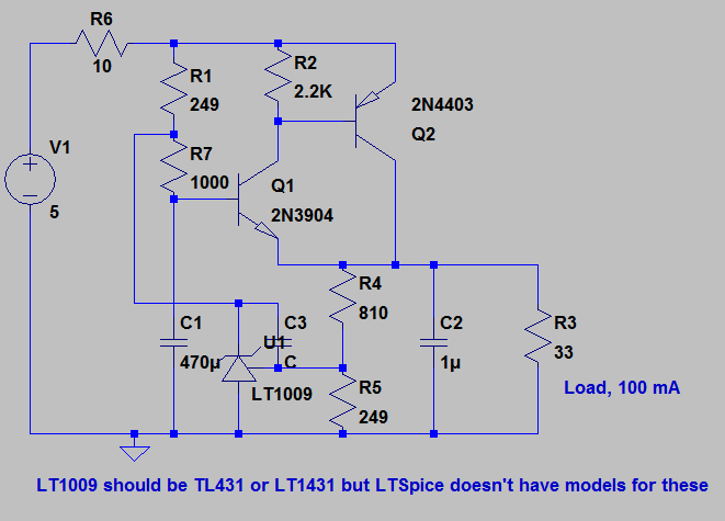

I posted a really good regulator circuit here:http://www.diyaudio.com/forums/digi...imate-weapon-fight-jitter-11.html#post2710526
Less than 1 nV/rt Hz noise and simple and cheap to implement. The output impedance is not as low as some other designs but the source isolation is really high. It can be "mapped" to negative use and even as a shunt with a little fiddling. Its ideal for crystal oscillators and works well in other applications as long as you understand its limitations.
I'm starting to implement it in some commercial products with good success.

I believe I understand which connections that are connected to ground in your schema for it to make sense but could you write them down so I can be certain... Intersecting 90deg lines in schemas can be hard to understand.

I understand your concern. Long ago I learned to never connect at a cross for the reasons you mentioned.
The TL431 was added to get a higher accuracy and more stable voltage long term which is why its below the ground.
I need to redraw it so its more understandable. I'll also fold it into a shunt version. I don't have the time to do the spice stuff.
I have attached a quick LTSpice schematic. They did not have a TL431 or equivalent so I used another device to show the connections.
I found the LT1431 under opamps but its so different I'll pass on revising the drawing for now.
This regulator is optimized for static loads that need really good low noise DC. It may not be ideal for an opamp that has high dynamic loading (driving a headphone). It may not be possible to meet both requirements (low source impedance and low noise) in one circuit.

In my experience the radiated noise from the rectifier/cap/transformer network is the hardest to deal with. My best experience uses a complex network in front of the transformer to limit the rate of change of the current through the network (power factor correction). But this requires heavy iron. Buy or make a pick up coil and watch the noise with a scope as you try variations on bypassing and arranging the wires. There is more technique than circuit involved ultimately.
JFet current sources are great but they have gotten more expensive. Linear Systems still sells them. Please use them liberally so they can justify making them still.
that's why I was suggesting to limit and slow down the charge currents adding a series R after the diode bridge (before the first filter cap). In principle using an inductance (inductive input filter) would be even better, but in practice there are also drawbacks. Fortunately in this project we are dealing with relatively little power and can afford to waste more power than we actually use. In higher power application it would be a really hard to solve problem...In my experience the radiated noise from the rectifier/cap/transformer network is the hardest to deal with.
