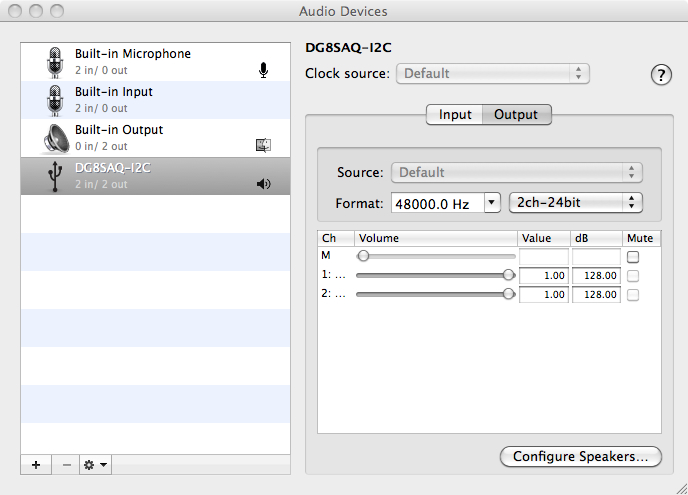

1. Yes, that's snow leopard. Switching to UAC1 I have the volume controls back but it is still mute.
2. No idea, I browsed the group data and messages but I have no clue how to download and run this widget. I am quite a cave man when coming to these very specific tricks.
Gianluca
I guess the GUI compatible with OS/X is only the Python-based one, "WidgetControl.py", not the windoze exe file. Likely you'll have to install all of its dependencies first (Python et all).
BTW:
have you checked what's in "Configure Speakers"?
The "clock source" can be changed? (which are the options?)
A/W have no volume, so I'd say that it's no surprise that the controls are either completely disabled or works in a "binary" way (zero/full) only.
P.S.: try mute/unmute and changing resolutions. Try using the same res. as the material being played (e.g., CD).
P.P.S.: to me, everything looks fine there... :-/
This is how it looks when i switch to UAC1: volume controls active but it is mute (i understand it is untested on Macs). On UAC2 controls are disabled and set to zero. Mute/unmute won't change the result, modifying the resolutions doesn't help.
I tried on a win laptop but it became unresponsive when the AB11 was plugged in. I don'y know if I need drivers or such.
Gianluca
You need drivers for Windows. Download from the code site I mentioned. AUDWDGT... And SDRWDGT.... Then run the Windows version of WidgetControl.
Btw, windows will HANG with a uac2 device such as widget, unless u have a third party uac2 driver installed.
U really need to get WidgetControl working first and show me a screenshot to see what you have set up in the widget.
