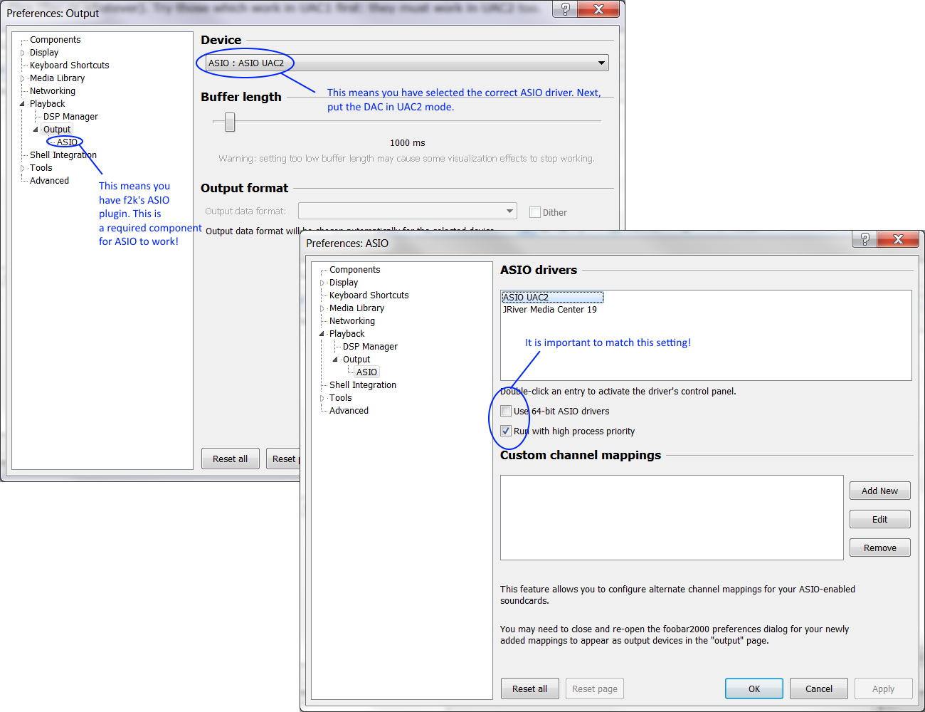

The widget does NOT support DSD, only PCM!I'm trying to play ISO SACD files but I don't get any sound in the speakers.
You may play those files only if the player (foobar or whatever) supports their format AND is able to read, decode and convert them from DSD to PCM.
Before trying something which may introduce unrelated problems, I'd suggest you to try playing regular PCM files (flac or whatever). Try those which work in UAC1 first: they must work in UAC2 too.
On Windows, an Audio Widget DAC in UAC1 mode is not reached by the project's ASIO driver "ASIO_UAC2" (but you may explore ASIO4ALL if you want.)
Also on Windows, a DAC in UAC2 mode is _only_ reachable through the ASIO_UAC2 driver.
For the ASIO driver to work, two things must be in place:
- The DAC must be in UAC2 mode / red light
- The player must support ASIO.
Foobar2000 requires an ASIO plugin and that you manually select ASIO_UAC2 as the output. See the attachment for how I have f2k running on my computer.
There may be two other issues. 1 - your computer is too slow or has too much to do. See if the DAC works on a >Core2Duo 2GHz computer which has nothing other to do than the music playback. 2 - Your firmware may be corrupted or out of data.
To install new firmware, read the text at line 508 of
https://github.com/borgestrand/sdr-widget/blob/audio-widget-experimental/AW_readme.txt
and follow it religiously.
