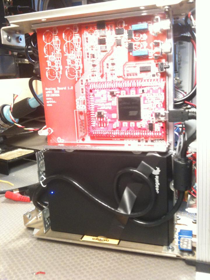

This is the hard disk player I built based on the Pi and AB-1.2 DAC. Too bad the BeagleBone didn't exist when I started the project and doesn't quite fit in the case. 🙁
