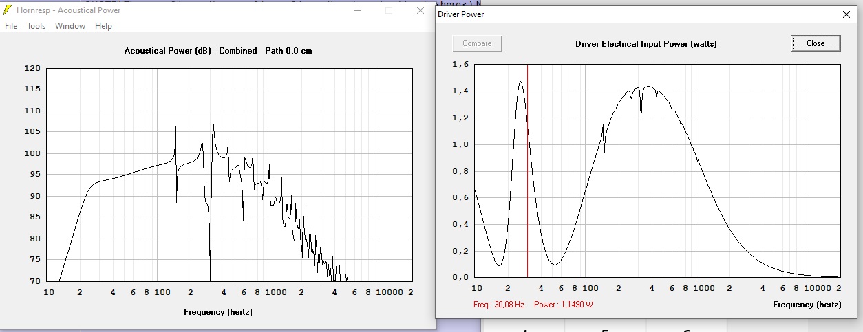

I've been looking at the numbers for a few minutes, simply tried increasing lower length of the chamber by 65.9cm. Quite a bit of resonances from 200hz up, but putting a layer of Melamine foam on the surfaces almost negate the issue, at the cost of tiny bit less output.
Resonance frequency 27.21hz, and 30hz goes just over 91db.
Suggest a round port centered about 30cm from the bottom, to get away from the floor. I used a slightly oversized 6" round 40cm long port in my calculations. Dip centered around 332hz might be an issue.

Kaffimann, can you show on overlay of the tower curve and the OSMC curve? It would be useful to see the difference as predicted from the Hornresp software. Or, thinking of it, it would be even more interesting to get two datafiles with the tower and the OSMC curves, so I could plot these along with the measured OSMC low-frequency curve. Just to see how the Hornresp simulation compares to the observed curve.
Melamine might work to reduce the resonance, but I am not sure it's effective enough at such low frequencies. How about a Helmholz absorber tuned to the relevant frequencies? Can Hornresp calculate this? Otherwise I might try to resurrect my AJHorn tool on my virtual machine...
What was the port measurements again? It's been so long, and I have lots of different simulations.
I only adjusted the height below the 12", because that's what everyone wants, and it's easy.
Tower is not the best solution for high bass quality, since you're more likely to trigger lower frequency modes. But it's not too bad, narrow-ish bandwidth resonances since the driver is closer to the middle.
You do not need an enormous amount of dampening material to take care of these issues, because the sound will bounce around a lot on the internal surfaces.

A resonance solution might work well enough, I'd suggest using a couple stuffed pipes instead of a tuned compartment. It is possible you can even out the pressure a little bit better.
Don't know how to calculate it properly, I will have to think about it.

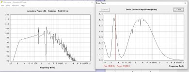

I was thinking it'd be a shame to waste all the effort on the MonkeyBox, we *could* make the box deeper to increase volume (to support more displacement), but if we increase SPL/w down low then we should increase mid and tweeter SPL as well.

Using the Faital 15PR400 and bumping the entire design volume to 223 liters helps increase 30hz output to ca 93.36spl/w, but it ruins the front baffle.
