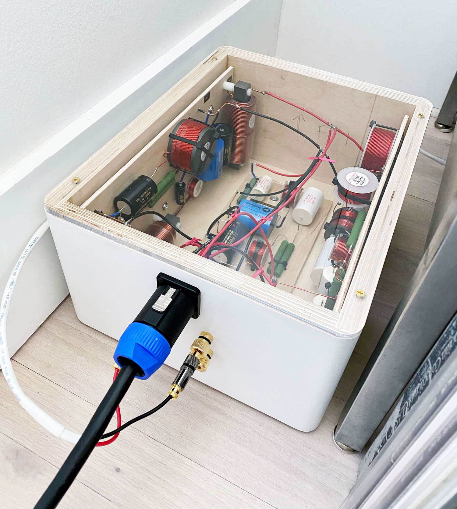

I put the Xovers in a separate box as you know, which I wasn't wild about when I first learned about the project, but now with more understanding—I think it's utterly brilliant. 1. because it's pure magic to me to be able to see how much copper the signal goes through—blows my mind every time—clear lids on my Xover boxes. 2. smaller cabinets and future options with other Xovers if I want to play. You'll have a bit more and less (ha!) to work out since you are putting Xovers in the cabinets. I had zero issues with crosstalk, that I can evaluate anyway. I did study what Matthias did—and reviewed the links that were posted about how to arrange coils for best results. Matthias also made some arrangement suggestions I followed from temp layout pics I posted back in this thread.
I jumped right in and made the Xover panels first. Then made the cabinets. Xover boxes were somewhat of a separate project. Test fit all the drivers—drilled all the holes—glue up, sand etc. Then finish paint everything before final assembly—which is when all the wiring happened as well. If you have exposed ply laters—expect them to telegraph over time under the finish unless you veneer them (and that will also telegraph, but less so with multiply)... unless of course you are going natural clear for your final—probably the move? I can highly recommend Bona Mega one-step. Totally brushable—lays down freakishly good. Not sure if I answered anything for you...

My xovers are within the overall length of the speaker cabinet but in a separate section below the driver volume. Maybe I should put a viewing port in the xover section.😉

I didn't get too precious about it—wasn't the initial plan either—but worked out.
attachment.php
