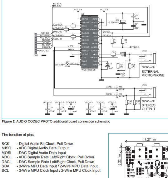

The MikroE looks ok, but no I2S? Looks to be only I2C and SPI
Please read the MikroE Audio Codec Proto Manual, figure 2. This is the schematic of the MikroE board. Obviously, MikroE has renamed all WM8731 digital audio interface pins. This is indeed I2S, thus not SPI, provided the ADC and the DAC are operating at the same rate.
Let's see what's happening when we define the STM32 F411RE I2S as Full-Duplex Master. Doing so, the I2Sx_WS pin of the STM32 F411RE chip is an output. Consequently, if there is a lot of jitter on the I2Sx_WS pin of the STM32 F411RE chip, the audio quality may degrade. For maximizing the audio quality, you will hook a high quality 12.288 MHz oscillator feeding the STM32 F411RE I2S_CKIN (input). The STM32 I2Sx_WS (output) pin needs to be connected, both to the ADCLRC (input) pin and DACLRC (input) pin of the WM8731. The STM32 F411RE I2Sx_CK (output) pin needs to be connected to the WM8731 BCLK (input) pin. Now comes the question of the WM8731 MCLK. You could hook a quartz on the WM8731 XTO and XTI pins. A more effective way is to have the high quality 12.288 MHz oscillator, also feeding the WM8731 MCLK (input) pin. This way you can safely connect more than one MikroE Audio Codec Proto board on a STM32 F411RE chip, using a single high quality 12.288 MHz oscillator.
Hi steph_tsf,
I only see SPI and I2C like the project page says.. no I2S. The top 5 pin functions I recognize as SPI and the bottom 2 are I2C.
Hi steph_tsf, I only see SPI and I2C like the project page says.. no I2S. The top 5 pin functions I recognize as SPI and the bottom 2 are I2C.
Clearly, you don't care the WM8731 datasheet. You should pay some time, reading it thoroughly. It is available here, now that Cirrus Logic finalized the acquisition of Wolfson in August 2014.
MikroE renamed the WM8731 I2S audio interface pins following the SPI standard.
Pretty bad move, IMO. This caused a generation of people confusing the I2S interface with SPI, not to mention those confusing the I2S interface with I2C. This caused a generation of people saying the MikroE Audio Codec Proto board doesn't work.
One need to remember that MikroE released the Audio Codec Proto board in August 2010, quite a long time ago, when the only affordable microcontroller featuring a I2S interface was the NXP LPC1768 (ARM Cortex-M3). Unfortunately, back in August 2010, MikroE had no development board featuring a NXP LPC1768 microcontroller. Unfortunately, back in August 2010, the only affordable development board featuring a LPC1768 microcontroller was the very first mbed board, the LPC1768 mbed board, released in September 2009, without any software support (no drivers) for the LPC1768 I2S interface.
Unfortunately back in August 2010, MikroE was still heavily promoting the Microchip PIC32 microcontroller.
It took nearly two years for MikroE (April 2012) to publish their WM8731 exemple software for their Audio Codec Proto board. You can find such WM8731 exemple software here.

USB Audio to Ethernet Speaker (using a ready-made module)
Raspberry PI having one USB2 port (used for high quality audio), and one Ethernet port.
Rotary encoder (volume control)
Rotary encoder (balance control)
Ethernet switch 4 ports (this is a stock Ethernet switch)
Port 1 connecting to Preamp
Port 2 connecting to Left Speaker
Port 3 connecting to Right Speaker
Ethernet Speaker (4-way digital xo inside) (using ready-made modules and jumpwires)
Olimex ENC28J60-H
ST Nucleo F411RE having one SPI for the Olimex ENC28J60-H and two I2S interfaces for two WM8731 MikroE Audio Codec Proto boards
One strap on a GPIO input line for selecting the Left or Right audio channel
Two such Ethernet Speakers required for a stereo system.
The first advantage of Ethernet Audio is that the endpoints (the WM8731 DACs) can operate as audio clock masters, explicitly requesting audio packets when they are needed. This is asynchronous audio. This is the only perfect solution for avoiding audio clock mismatches, buffer overflows, and buffer underruns.
The second advantage of Ethernet Audio is the possibility to send audio backwards, while the speakers are playing, possibly when reducing the audio resolution from 32-bit to 16-bit. This can be useful during the setup and during the selftest of the speakers, with a PC receiving the audio frames coming from mikes embedded into the speaker. If the transmission delay over Ethernet (possibly Internet) is stable and correctly compensated, the PC will be able to measure the Bode plot (gain and phase) of the speaker.
Very important is that the audio packets requests (possibly bidirectional), control data and status data don't eat the 10-BaseT bandwidth.
Can somebody confirm, that this is feasible in a diy-context?
48 kHz stereo high-quality audio = 48 kHz x 32-bits resolution x 2 audio channels = 3072 kbit/s
Ethernet bitrate = 3072 kbit/s * 1.5 overheads = 4608 kbit/s
This should be okay for 10-BaseT, indeed.
Indeed.
