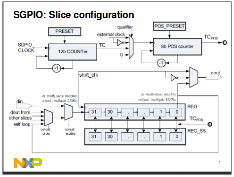

The exception is that in 19.8.1 example slice clock from slice D (SPGIO12) is used. I'm just wondering what's the difference? SCK input is however an external pin clock. Difference is that MCLK is divided by four but SCK used as such, I don't know if MCLK can be used that way, can pin clock input divided at all?
"SCK master mode: SCK is supplied at pin 8, this clock falling edge is used as shift clock for all slices. No MCK is used."
The PRESETi is "counter not used" (it says not value zero) whereas for slice D in MCK master mode PRESET is set to 3: f=MCK/4, but then the other slices are set to use "SGPIO_MUX_CFGi / ext_clk_enable = 0 :internal clock" mapped to slice D in slice mode.
PRESET documentation:
"Each register contains the reload value for one slice: PRESET0 to PRESET15 contain the reload value for slice A (register 0) to slice P (register 15).
This register controls the internally generated slice shift clock frequency: frequency(shift_clock) = frequency(SGPIO_CLK) / (PRESET+1)."
Now is this setting only available for internal clocks (meaning SGPIO_CLK or slice clock)? The slice D on the other hand uses PRESET value 3 (/4) and seems to be configured similarly as SCK otherwise so it seems it could work.
Yeah, figures 42 and 43 in the LPC43xx manual kind of disagree about how clocking works. 19.6.3 is pretty specific about CLKGEN_MODE so I suspect figure 43 is unclear in that external clock should read "clk_slice or clk_pin". Probably the manual just picked up some ambiguity around the definition of external clock through edits over time. This suggests PRESET = 3 in table 321 is incorrect---presumably that cell of the table should say not used---and the clock divide is accomplished by loading SGPIO12's shift registers with 11110000b. With an LPC-Link 2 in hand it's easy enough to check this with a function generator on SGPIO13 and an oscilloscope/logic analyzer/something like that on the outputs.
It is unclear from the manual if a slice can be used if its output is not assigned to a pin, though I don't see any reason why this would be required. So presumably post 543 could be implemented by making SGPIO11 a pin clock to any of SGPIO12 to 15 and then using the chosen slice as a slice clock for the I2S output SGPIOs. Worst case would be pin assignment is required, in which case SGPIO13 would have to be used.
It's clear from the Fig. 43 in User Manual that the PRESET does not affect to external clock, just to SGPIO_CLOCK. Wonder what the pre-divider discussed here does mean:

My reading is predivider = PRESET. For the configuration we're discussing here a DMA request can be raised by I2S0 each time a sample is received (section 43.7.3) and it's desirable to use SGPIO14 or 15 to do the same each time a sample is sent and the shift registers exchanged on I2S_SDO_x. In the default I2S case of 32 bits per sample this should be straightforward to implement by operating one of the GPDMA slices in self loop from the SCK slice clock. The default pattern of 0x4000 0000 mentioned in section 19.7.6 should be fine.
However, I think this approach is limited to stereo receive or stereo send. If I'm reading the manual correctly it doesn't work so well with multichannel audio as SGPIO14 and 15 are the only SGPIO destinations available (table 327 got glossed over in post 57 of this thread). One of those needs to be loaded with the pattern to trigger DMA, meaning only the other is available as a DMA destination peripheral. This is fine if the DAC is in one line mode but problematic when operating two or more I2S_SDO lines in parallel as only one line can be a DMA recipient.
Presumably multichannel data is moved via the combined SGPIO interrupt which fires when a slice's REG and REG_SS shift registers are exchanged. This seems to be variously referred to as the capture clock interrupt, exchange clock interrupt, FIFO full interrupt, and POS interrupt depending on which part of the manual one's looking at. Since all I2S_SDO lines exchange registers in sync with I2S_WS the result should be just one interrupt per batch of left or right samples whose handler copies the next 32 bit word to each REG_SS in use.

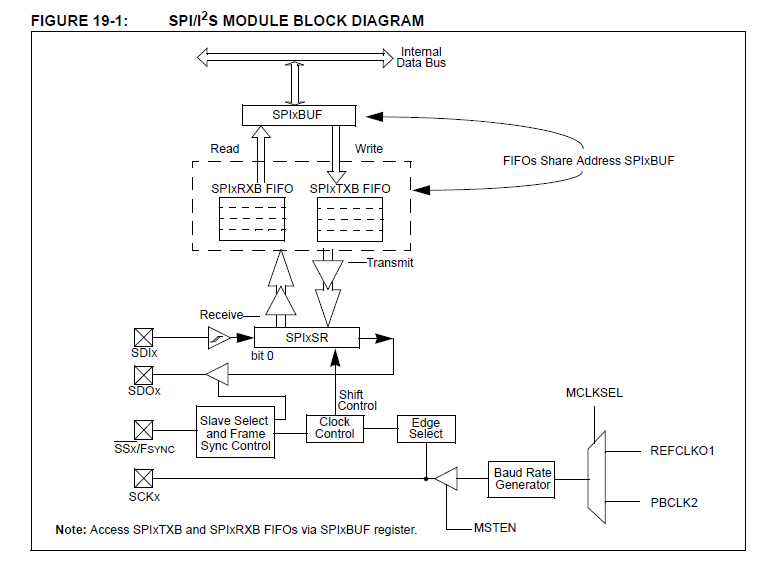

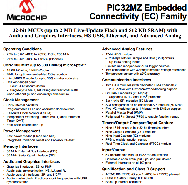

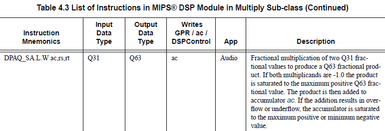

The Microchip PIC32 family has expanded. Here comes the PIC32MZ. 200 MHz. Six full-duplex I2S. New DSP instructions. New "MPLAB Harmony" development software.

Nice chip, also available in TQFP package (64 pin the smallest one). 512 KB RAM. Errata. 300+ DMIPS. PIC32MZ1024ECG064-I/PT-ND $11.57/piece.
