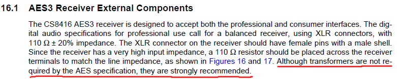

Pulse transformers is also a difficult matter, since a transformer is the very worst audio component at all, only second to disruptions and short circuits.
Measuring the shape of the digital signal in a SPDIF output with and without transformer is a pretty nice experience.
Transformer transmission completely corrupts the shape of the signal.
Hence they introduce incoming jitter.

Hurtig said:Well... feel free to suggest a pulse transformer that do not introduce any jitter or any other sonic performance issues.
We have tried quite a few, and the transformerless approach has always been the best sonic performer. Btw...: Crystal Semiconductor actualle suggest the transformerless version in their datasheet.
Sonic performanse issues....read that datasheet again and change PLL filter values if you want to to increase performanse issues.
Change phase detector update rate...another sonic performance issues.
Run CS8416 differentially, not SE....another sonic performance issues.
Stick line driver infront of CS8416....another performance issues.
You have tried quite a few transformers..... I suppose you run them into 75 Ohm transmission line? 😀

Kurt von Kubik said:Measuring the shape of the digital signal in a SPDIF output with and without transformer is a pretty nice experience.
Disagree.
Wrong impedance is corrupting your signal, not transformer.
Or wrong transformer, if you follow Crystal recommendation 😀
Lowest interwinding capacitance = highest leakage inductance 😡

@ Stormsonic:
What we did about the SPDIF is:
- Remove the pulse transformer i the CD-drive, and made a true 75ohm out put.
- Remove the pulse transformer in the DAC input, and terminate with a 75ohm resistor.
This has proven to be the best sonic performer. And trust me... we did try a few...
