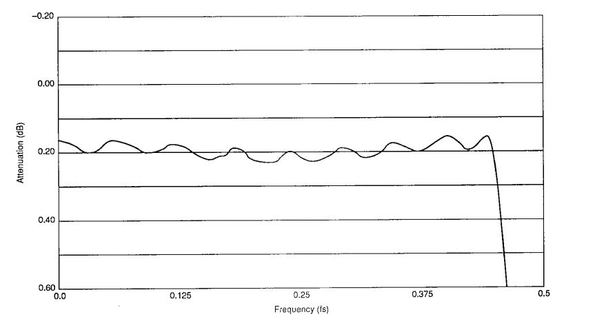

This question always bugged me, too...😕
Let's have a look at the frequency response of a classic digital filter (synch 4x OS, SM5841). Assuming this curve is generated using a full scale 16bit file/track and assuming that we can live with 0.2dB scaling to avoid overflow... then what about that pesky +/-0.03dB ripple...it seems that most of the output samples are new/rewritten.

Jan is correct an exact frequency multiple convolutional sin(x)/x interpolation preserves exactly the original samples. The sin(x)/x is zero at all the "right" places, If you think about it it could be no other way. It would violate first principles.

As Scott has pointed out, the sin(x)/x function ensures that the original samples get multiplied by unity and all other samples find a zero as their multiplier, thus preserving the original values. In the first filter, all even values will be stuffed with zeros and odd values (say) are the originals. The impulse response being sin(x)/x gives us the originals back for odds, and sin(x)/x interpolations for the even values. Rinse and repeat a further couple of times.
Yep, in the case of a 4X filter, it would indeed be the case that 75% of the samples are new/rewritten. Here, of course the 0.2dB scaling means all bets are off...
Hmmm, okay, I take your word for it.
It does leave the question though why the actual output of the filter(s) clearly shows that the original sample is also manipulated? It may not be manipulated by the actual oversampling process, but it does not pass the digital filter intact. I do not, in all honesty see the "factor one multiplication" applying even in pure theory, I'll have refresh my theory it seems.
Ciao T
Hi Scott,
Ciao T
You can draw the convolution process on a couple of sheets of paper and slide them past each other. What a particular implementation does is not of concern. People tweek filter coefficients to get what they want, you need to understand the underlying process and then move on to other possibilities.

The result in mathematical terms for a multi-stage filter should the same as for a single pass. As said, I still remember essentially identically working filters in analog hardware.
So, why do my measurements of sending an impulse to a DAC first without digital filtering and then with show different peak amplitudes? If the ooriginal sample is preserved, should I not get the same peak amplitude?
