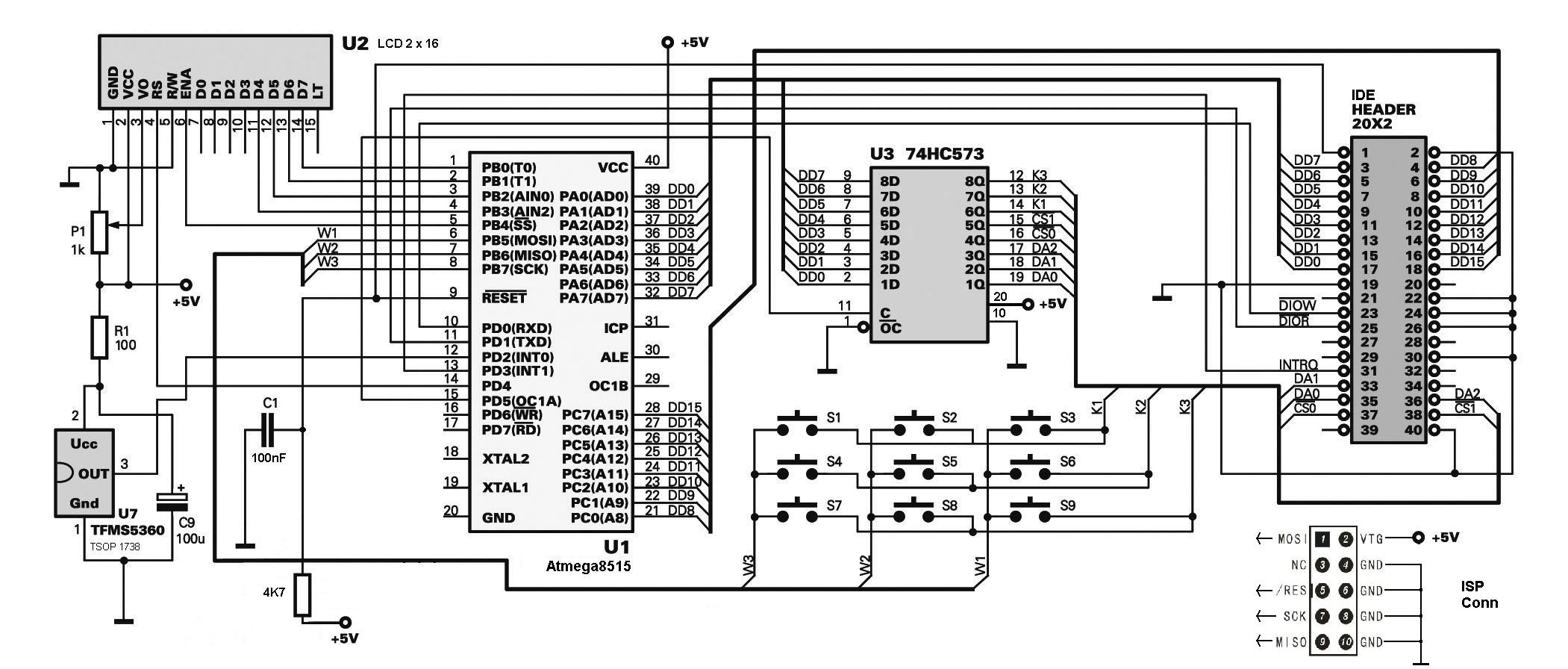

Open Source CDROM controller , soft and stuff
Danzup, dit you still have some schematic and source
For an cd rom controller
For that controller i have only .hex and schematics and NOT the source , but I have on my desk working on a variant of my own with atmega16 , but very very basic and not ready and with bugs . When i will finish the software i do not know now.
I think I will post after finish on diyaudio the firmware for atmega cdrom controller.
Danzup, i have some source for cd rom controller
written in bascom there are some bugs mabey you can
use these. Must i post it here
So cool : i want to see something like this , to compare with my own as I write also firmware in Bascom.
I propose to use this and what I have write myself to make an "Open Source CDROM controller" for diy people .
Ok with you ? Is this a good ideea ?
Sorry MacDLSA1970 for lurking in your thread .
If it is not ok we can make a new thread about it .
here the code I have

I open another thread for people to build their own cd rom controller for clone :
DIY CD-Player "Audio Analogue - like" or Unison Unico CD player like , wich use computer CD rom unit and some microcontroller to have CD player function. Output in spdif form .
On e-bay there are a lot of various CDROM Controller Kit for sale but this will be with software open source, for people to change the firmware for their whishes.
We will try to do our best here but in the end expect nothing....
So let`s begin.
Some threads that are related to this :
http://www.diyaudio.com/forums/digi...-cdrom-controller-soft-stuff.html#post3067217
Schematics used by me and firmware with RC5 rewrited
I have modified a little the schematics used and also i do replaced the Bascom AVR rc5 routines with another using Timer0 for remote RC5 to work.
I am using Spdif attenuator : 2 x 75 ohm one in series with signal one to ground.
CD-ROM used : TEAC CD-54 and TEAC CD-52W .
  • Odt_cd2NEW.zip
Sorry to brought up old thread. Danzup do you have additional code for eject/close cdrom tray ?
Didiet
This schematics not ,as the uC Atmega8515 flash is full and nothing cannot be added to firmware.
Here i was using the switch of CD-Rom for eject/close tray of CD.
I am working for some time on a Atmega16 version with more enhancements but still on halt and no time to finish.
Now I am involved in some other projects and do not know when I will be ready with the new firmware .
Maybe next year ?
