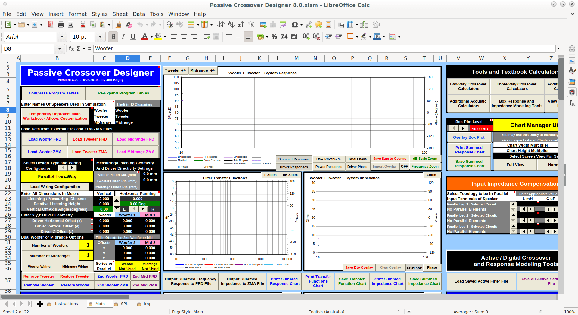

My computer is running PCD with W10 and an older version of Excell [ Office 2007] and it no longer runs.
Will PCD work with Open Office?

There's also native windows port https://www.speakerdesign.net/WinPCD/My computer is running PCD with W10 and an older version of Excell [ Office 2007] and it no longer runs.

PCD uses Excel macros extensively I believe. Jeff was big into those. Updates to Excel by MS have broken his work several times in the past. None of his stuff ever ran under Open/Libre Office.My computer is running PCD with W10 and an older version of Excell [ Office 2007] and it no longer runs.

I have the 32bit Excel, I did think it was working before I upgraded to W10 but I've had a 64bit OS for a while.The Boss is an expert user I guess I'll have to ask for help but it runs just fine on her machine using W365
I have 64 bit W10 and 32 bit Excel 2003. PCD works just fine.My computer is running PCD with W10 and an older version of Excell [ Office 2007] and it no longer runs.

- Open Office with Jeff Bagbys PCD
