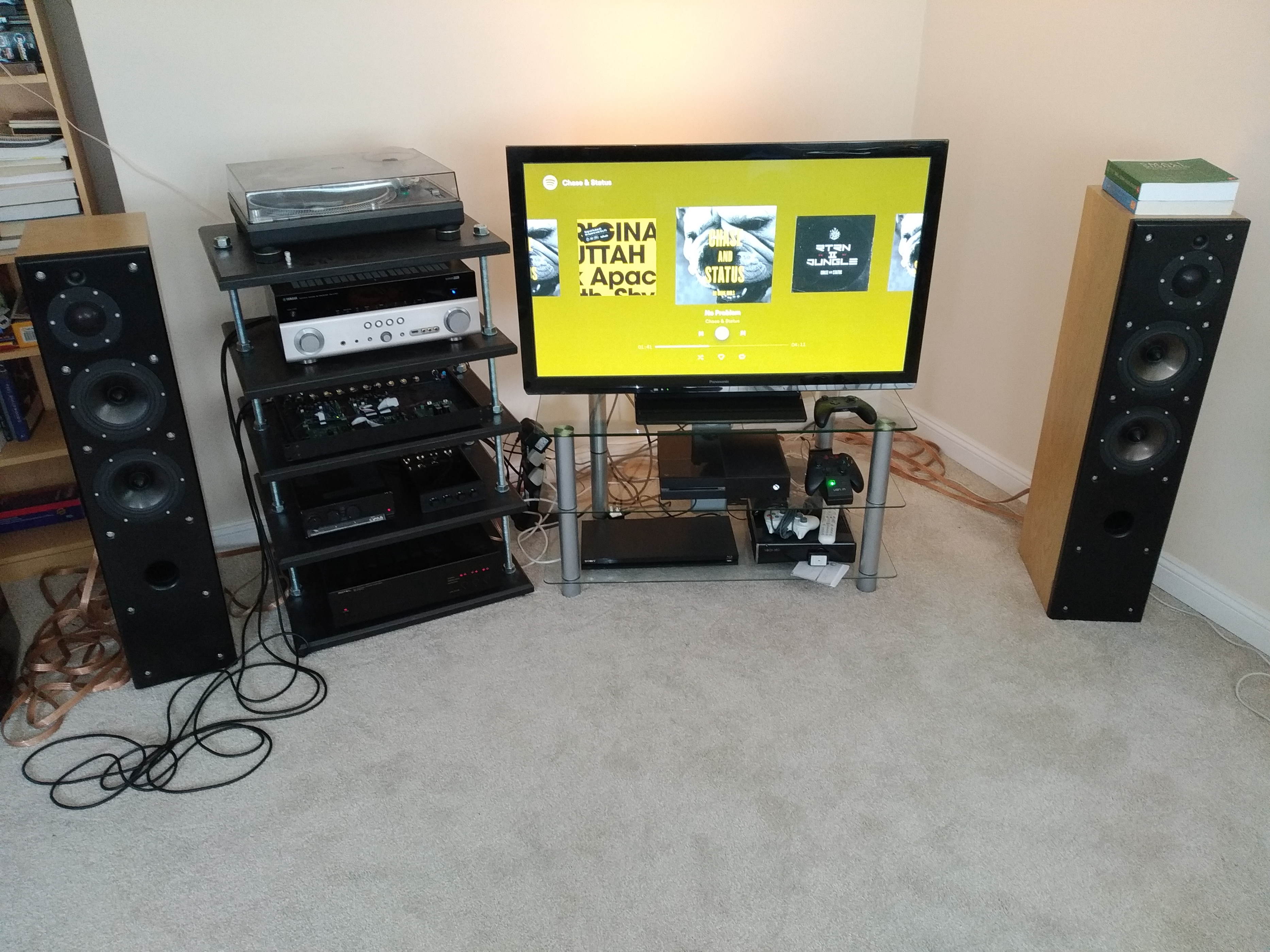

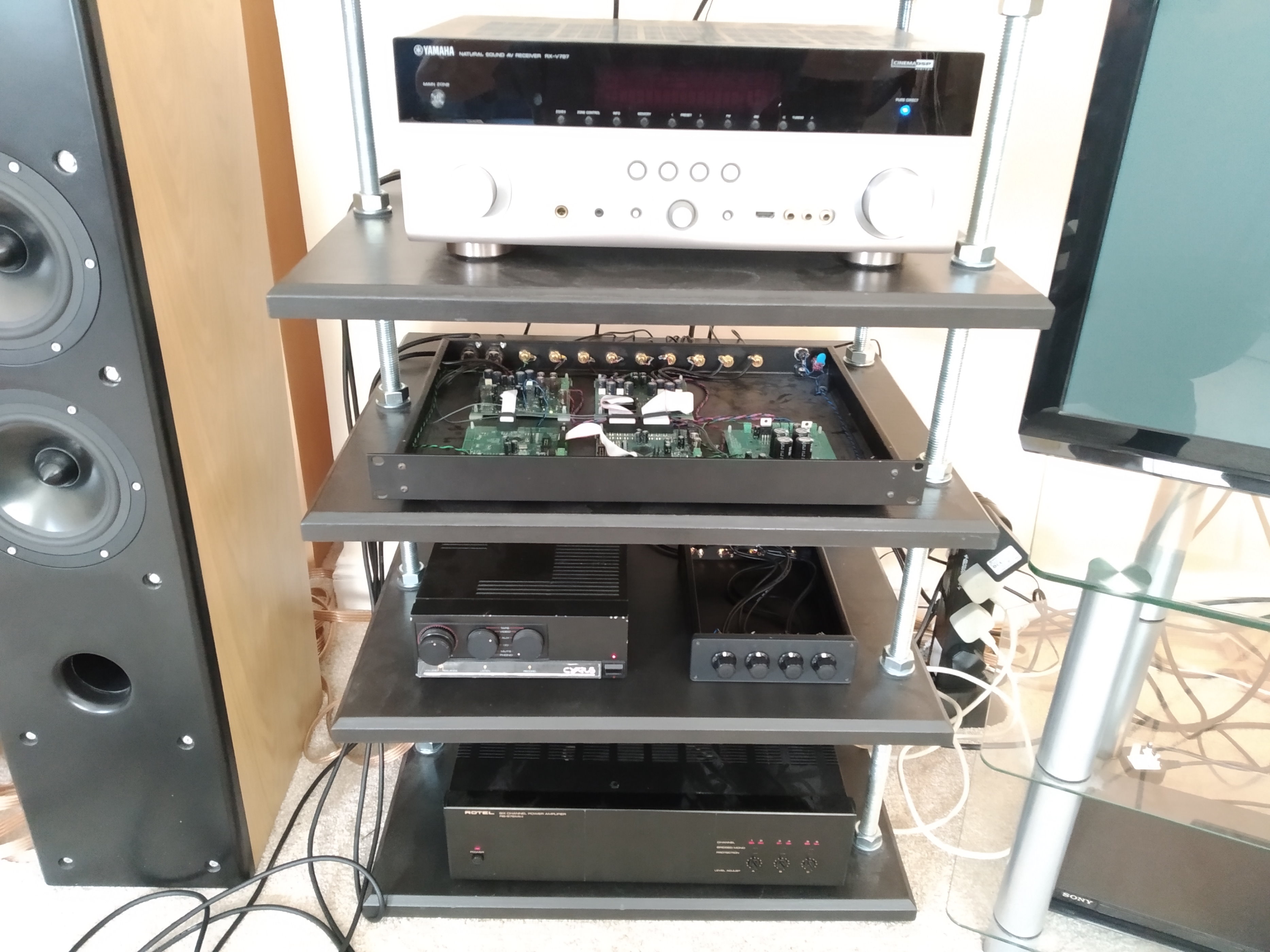

Finally after many years I have fully active ZDT 3.5 speakers with custom DSP box. Just "finished" today.
Some details, the DSP box is my PCM4202 DAC, with the ADAU1452 DSP, and the ADAU1966 DAC (despite it's problems), as on my website/gitgub (although needing more documentation).
There is a passive attenuator box so I don't blow up my speakers or amps and can run the low level side with the highest voltage level possible, because why not!
So far my tuning has been to approximate the ZDT 3.5 crossovers/transfer functions in the ADAU1452 using whatever I can find in SigmaStudio to do the job. So it needs a little fine tuning. But it still sounds awesome.
Everything after my Yamaha amp, which is acting as a preamp, has been built or fettled by me. Both the Cyrus One and Rotel (6 channel amp) have been completely gutted and refurbished (including every solder joint being reflowed as most on the Rotel were dry).

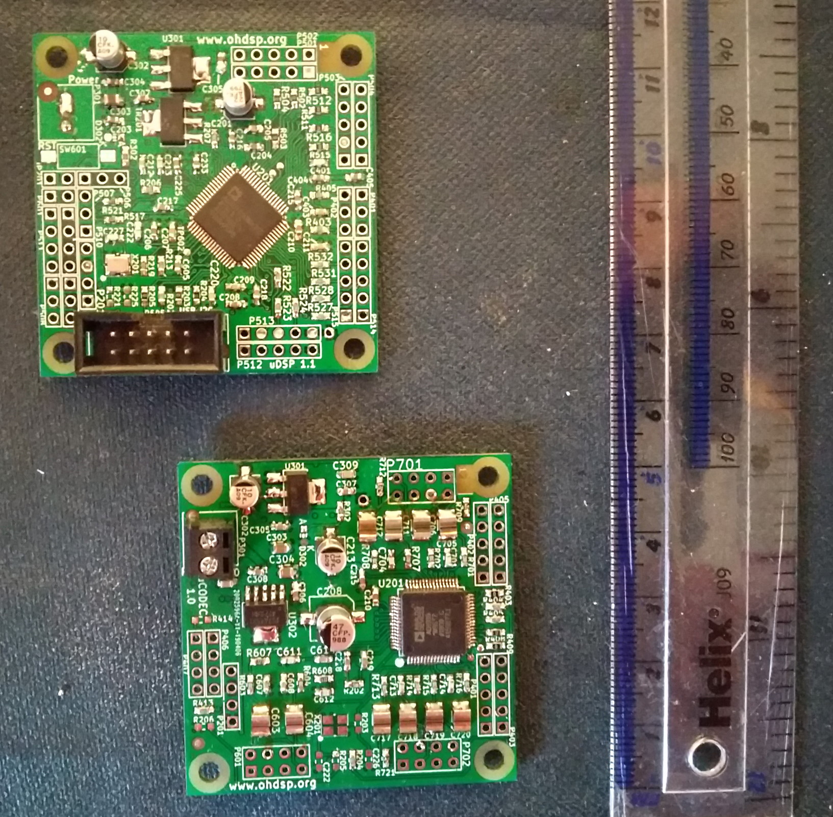

Wow, so I replaced the (questionable and suddenly obsolete) ADAU1966 DAC board with an AK4468 board, in my DSP box in post 41.
Specifically it is my AK4458 board fitted with an AK4468 chip as they are pin compatible. This allows me to run the PCM4202 and AK4468 chips in 192kHz/24bit mode.

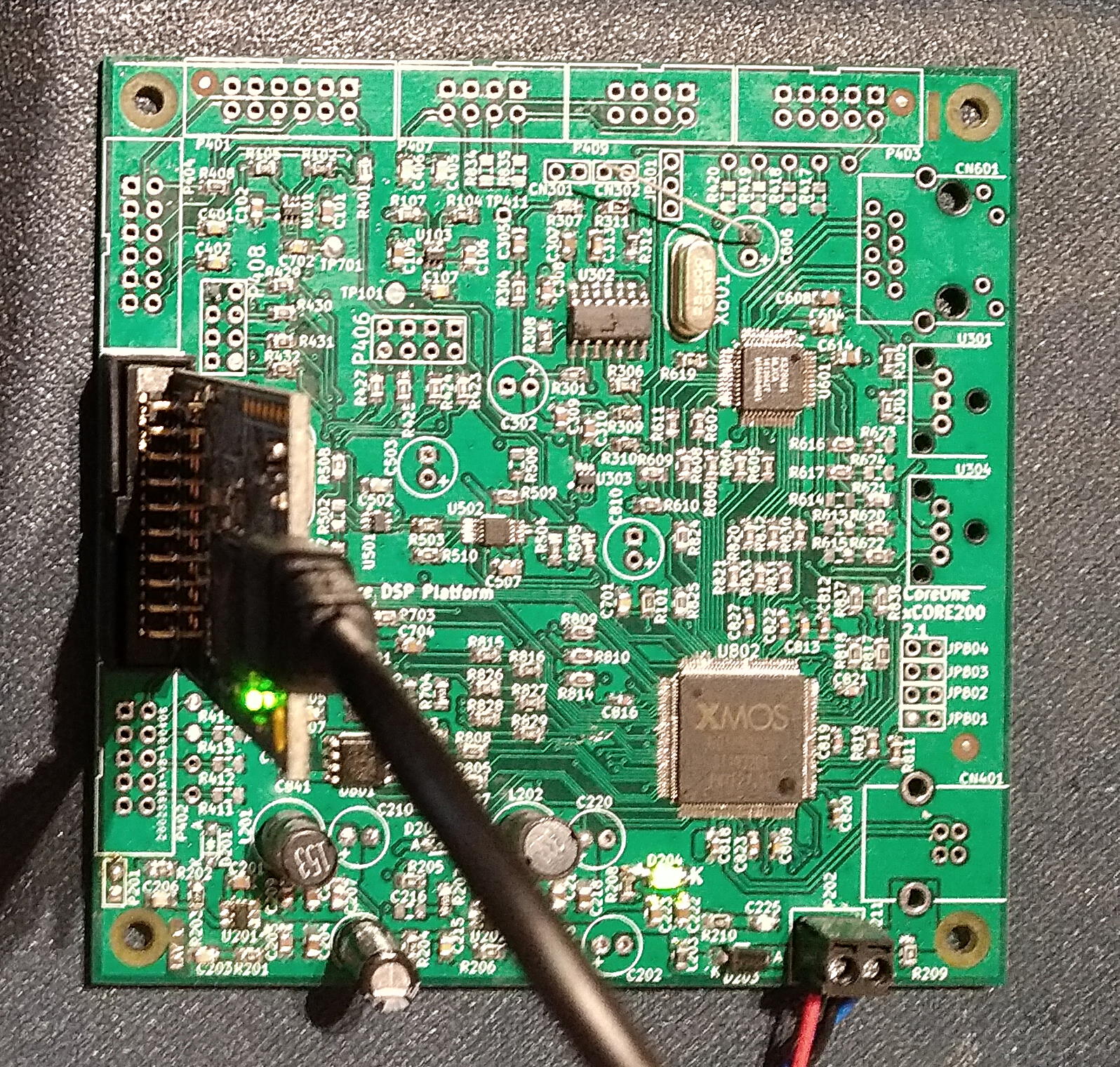

My conclusion is a possible silicon bug. Nothing wrong with the design from what I could see, but the CM voltage just doesn't change as it should for a 5V supply.
The ADAU1966 (not the A part) became unavailable and then obsolete/NRND very quickly. It's why I designed the AK4458 board, although that also has problems with supply as well now!
I've not tried the ADAU1966A. Should work on the same PCB if the AVDD is changed to 3.3V
