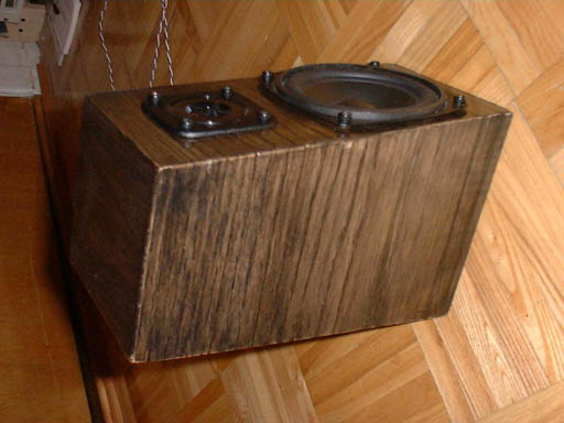

ok, well i made those lil satelites using 4" cambridge drivers and 1" tweeters, and i havnt put the back part of the enclosures yet, i wanted to try what will happen if i put damping material and leave em open from behind.
as the first test i just runned some Diana Krall... and i was like "whoa, that sounds GREAT!!!!!!!"
im really impressed,
then i tested some other musics, and found out that the open baffle makes the mids REALLY clear and it goes very well on latin/jazz, but really sucks on hip hop..
then made another test, closed the second satelite (it has a vent)as it was calculated.
and made the same test again, and i really think the open baffle one sounds GREAT on some musics way better than the vented one..... sucks on others like hip hop (not that i listen to that too much...)

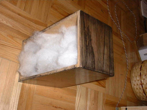

made another test, left the enclosure open, but whitout damping material, and it was awful, too much echo (room acoustics?)
actualy, vented has more bass less mids
open baffle has really clear mids, no bass
(i have a subwoofer taking care of the bass)
is this pure luck? or what?
i'll post pictures tomorow.

Well... i just add some poly fill for pillows and theres no more echo... just perfect mids and highs out of relativly cheap tweeters and somehow good mid drivers
sorry i didnt post pics today, still waiting for this varnish to dry before remounting the drivers 🙂

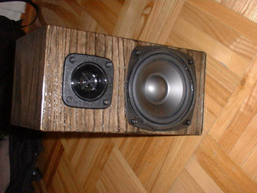

ok, sorry for the delay, heres the pics...
If you download the dipole XLS file at the link I posted above, you'll find a spreadsheet to calculate what is happening with your bass response.
From the looks of it (assuming 12 inch total baffle width) you'd be getting a 6dB per octave roll off below 400Hz or so. Hence3 no bass.

i guess it looks bigger than it really is...
the box is around 10x5x5
anyway, im not really trying to make bass out of a 4" driver...
i'll leave this part to the subwoofer...
im going to change the tweeter too... this one is lame...
i spotted some nice mb quarts
