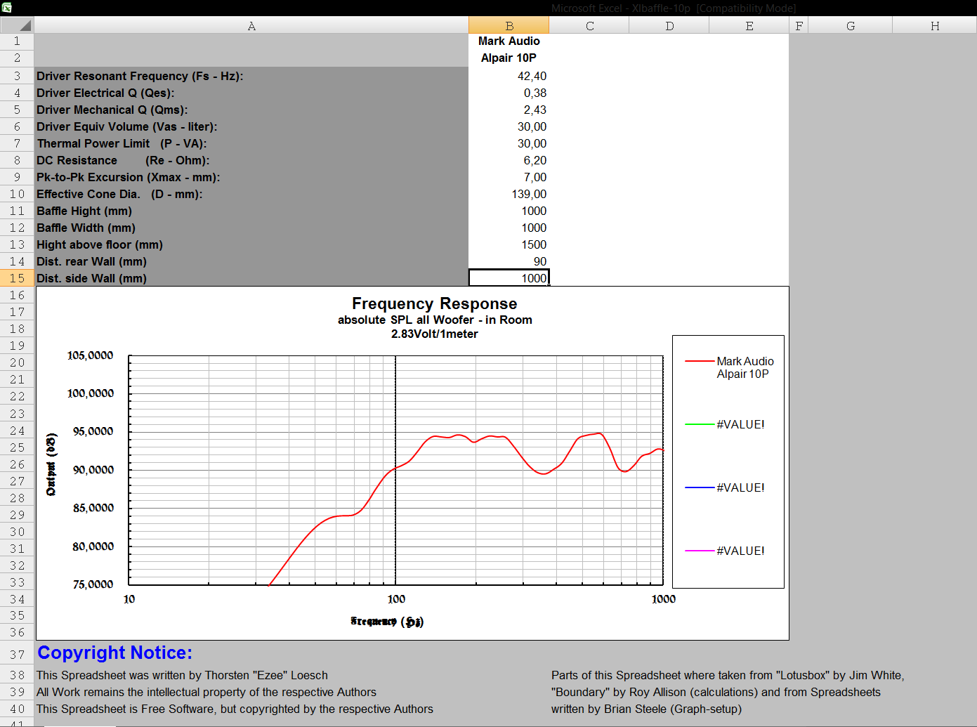

As far as i understand, i need to make sure to count the natural slope of the drivers, and make the woofer section double as efficient (+10dB) as the fullrange ob. I'm now thinking by using the alpair 10p till +/- 100Hz or a bit higher and add a H frame subwoofer that can at least go till an fs of 30hz. The Alpha 15A won't go that low, but other drivers may do it. Any suggestions (with a reasonable price)?
The 10p will not make 100 hz on an OB. I dont think it will do 200 either.
Read MJ Kings treatise on OB. Read it several times.

i've red it several times, and if the baffle is big enough, it should do it i understand. the freq plot free air on the Markaudio spec sheet says the driver start to drop just above 100hz if i can view right.
When i do a sim in Thorsten Loesch Open Baffle Spreadsheet i got even beter results.
I nowhere read that the bass is less than the driver if the baffle is big enough. And that is what i want to do, build a huge baffle.
What do i see wrong?
(edit: better printscreen)
