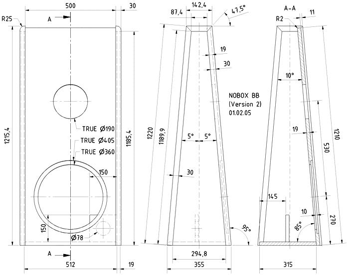

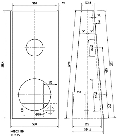

NOBOX BB
Hello Waxx
Good luck with your project
This NOBOX BB is an easy way to start your open baffle journey
It can be used with a lot of different drivers and it is also easy if you want to add a tweeter or a woofer This baffle can be made out of one sheet mdf or plywood 244 x 122 mm
In fact I still use this setup every day since i started using open baffles
Succes 😀
Enjoy 🙂
Ronny
Hello Waxx
Succes 😀
Enjoy 🙂
Ronny
