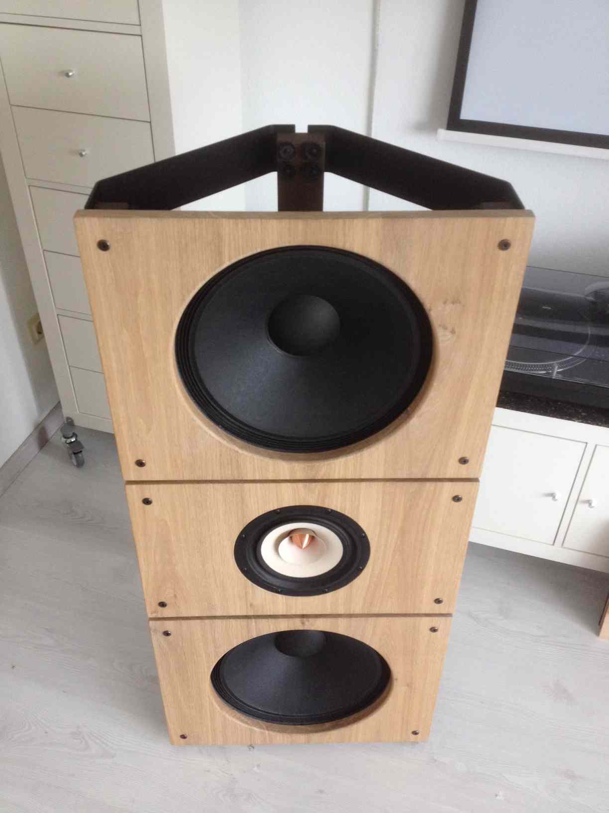

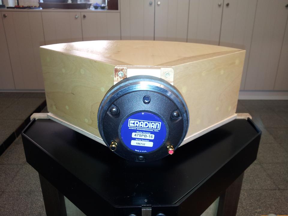

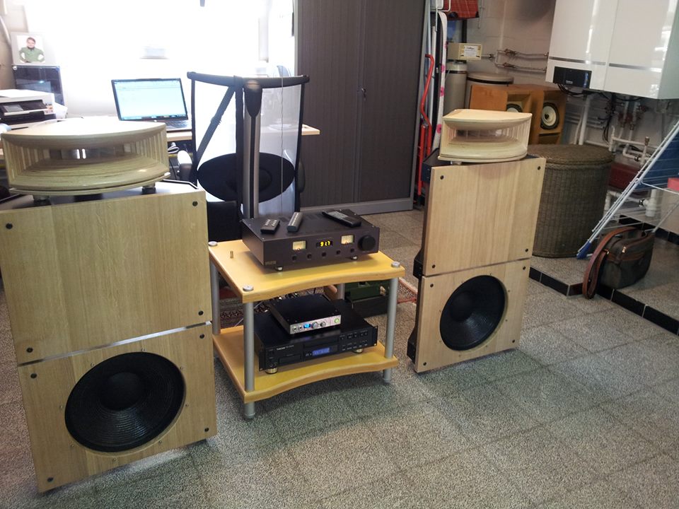

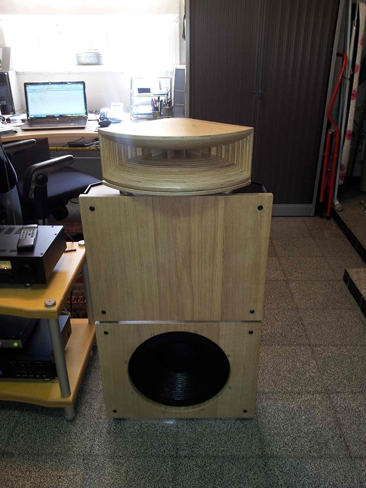

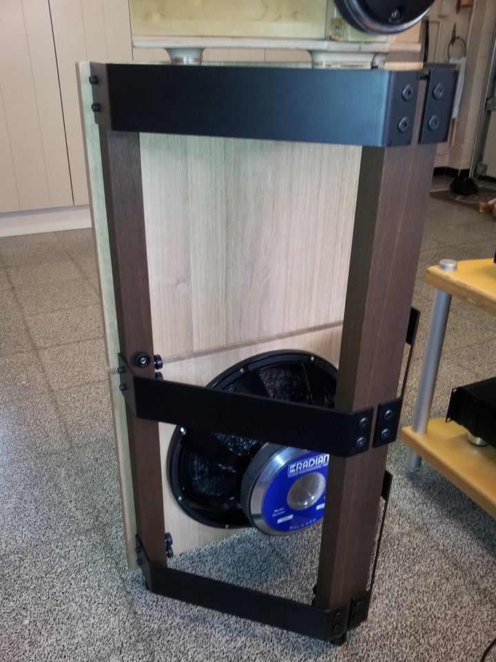

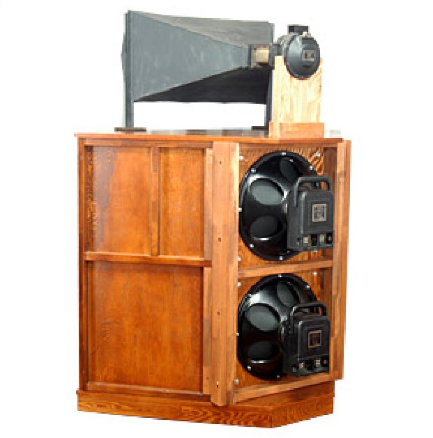

The project we present here is by Karel from Belgium.
Karel is a great guy, well experienced and a veteran of the high-end audio business.
His project was an Open Baffle / Horn set 😎
Karel used our Tower15 Open Baffle HW Kit and Baffles (that he could also build himself🙄) and requested a duet configuration with custom cutouts for the Radian woofers. He then cut a simple 1cm wood plate that has the shape of our inner frame, placed it on the three wood feet at the top, and put the horn on it
so clean and simple 😱
Here is a quote from Karel's concluding mail and photos he sent us of his project.
Quote from Karel's mail:
Music friends,
Enclosed pictures of my phantastic open baffle system.
You are always welcome to listening session
Kind regards
Tweeters are Visaton TL 16 H 8ohm - 95 db
Motor/driver is radian 475PB 16 ohm -111 db
The wooden Horns come from alg-concept.fr. Horn type Arai A-480.
By the way Ze'ev, I intend to use (buy) his Iwata type 1 which has the same width as your Tower10 HW Kit, the A-480 has only 480 cm
Subwoofer radian 2216-8 8ohm 95 db
Frame : PureAudioProject Tower15 HW Kit, German oak, smoked, white oil
Cross-over: Radian XD: extreme definition radian (2-way )
Radian, indicated not to use a tweeter, driver should go up to 22khz. Will soon try without tweeter.
I use a 1,3 µ f capacitor from mundorf . . .
Pre-amp : Passion Audio-synthess UK
Power amp ; loftin-white 2A3 (no capacitors)
as name lets call it KDL . .
kind regards Karel."
end Quote.
CONGRATS KAREL !!! and thanks for sharing.

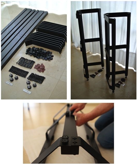

So why do these frames sound better than pine or solid maple?
I am not sure you asked me or IG81 who referred to the metal frame, however, here is a feedback of an enthusiastic music and well experienced audio fan that took the first step towards DIY with the Open Baffle HW Kit (the frame). He is also not a member here so I simply quote his comments on the 'frame' and few additional upgrades that might be worth sharing...
quote (google translate from German): " Here's a new photo, I could not wait and have built the Feets still on Wednesday.
The result: Stunning! The sound has improved by 50%. The baffles are stable, all the screws are tightened, no more vibration, the radiation is now correct, more high and mids. I'm excited.
Learn more about this on the weekend
Kind regards, also to Hansi, he did a very good job!", end quote
and few weeks after:
quote: "You made me happy with your mails and I would like to inform you about the newest modifications I arranged to improve the sound more and more 🙂.
Step 1 - the New Frames made the Sound more brillant and more clear.
Step 2 - add of 'Sound Tuning chips' from Albat (picture) for more dynamic, less resonance and a clearer expression.
Step 3 - 'moongel' damper pads (for drums) instead of spikes undock the speaker from the floor. With an amzing result, which creates more volume and a very Fine High mid ton...", end quote
see photo of his Trio15 TB, feat. PureAudioProject Tower15 HW Kit and German Oak Baffles, 2XEminence Alpha15a, Tang Band W8-1808 and point to point passive crossover.
