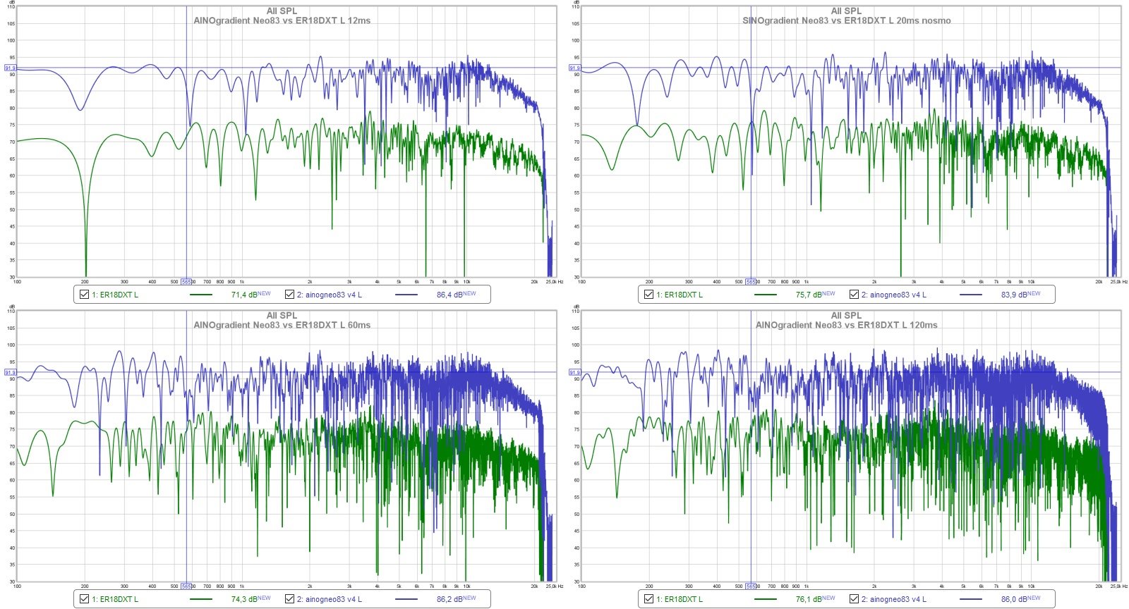

Here You are, Sonce!
AINO's are dipole only from 200Hz up. Cardioid between 100-200Hz and monopole below 100Hz. This is why graphics are shown only from 100Hz up.

This is the right speaker , the left one sits as mirror image to left of the 50" tv and it's measurements were posted yesterday. Willa is a wheaten terrier, weight 19kg (41lb)
Please be kind, i've performed a lot of measurements in order to have reliable results.
