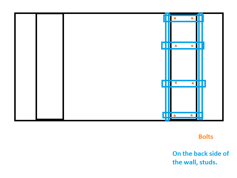

Well, my plan originally was to just do IB subs as an addition to some of my existing subs (I love effortless, extended bass) and the idea of trying some of my main speakers in the same arrangement was an afterthought that popped in my head. The idea to compare it to a dipole came about while I was looking at Troels' page and his OBL-11, considering it's almost the size of a wall anyway, when there's 2 of them together. I realize that the IB being closed wouldn't be dipolar, so a lot of his description of the sound probably wouldn't apply quite the same, except for "there's no box".
It was more like "well, in a few months I'm going to be putting subs in that wall, I wonder if the benefits of that would translate into the main speakers as well....and it would look drop-dead awesome to boot!"
As far as theater vs stereo system, I'm very much more concerned with 2 channel audio. I've kinda tacked-on the theater stuff as an "extra" for watching movies but my primary concern will always be having a great 2 channel system.
Thanks for all the advice, I'm a tinkerer at heart and a lot of the time I don't think things all the way through before I start cutting scrap wood to experiment with 🙂 In the end, I guess I'd just like to use this space I have here to the maximum potential, as I can do pretty much whatever I want to it, no matter how terrible the WAF ends up being, even if it's something like... 4 ficar18s and 7x OBL-11s, even though I'd be saving up for a few years to build them all, lol.

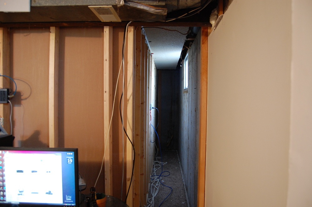

I have a couple of my surrounds and center in the wall right now (you can see em in my video sorta), but there's never much musical information coming out of them so it's tough to gauge what to expect out of IB mains.
Looks like you could build really big transmission lines in that space. Or, really big folded horns.
Interestingly, that's one of the things I considered, building something behind the wall that just vented forward. My T-TQWT subs almost ended up behind the wall with just the mouth section showing covered by a hvac register type vent.
This is all what got me thinking about IB, or OBL-11s while I was daydreaming about Cryolites. I was like...well, I've got the space...why not go big.

Ugh, don't remind me, if I had a dollar for every bass mode in this room I could build the space shuttle.
Still trying to figure out what to do with it, I've even considered switching to the other side of the basement where there's more room to build huge insulation traps at one end.
