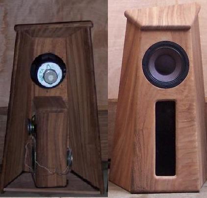

Here's a set that turned out great with a low Qts 8" driver (the Adire HE8.1) plus four cheap 6" TV drivers in a W manifold to help fill in the bass . The pics are before I added 3 cross braces in the back because the 1" hardwood still vibrated without bracing. Note that the maximum width at the bottom is 19" and these work out to the same added rear wave travel distance as a 45" wide flat baffle for bass rolloff purposes. The sonic difference between these and the recommended BR cab are a night and day improvement. Unprompted my 9yro daughter asked why the OB set sounded so much better when I was doing A/B testing.

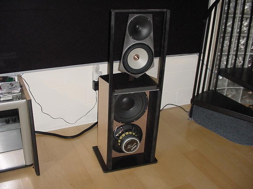

Actually many car speakers will work quite well for OB applications, since most are intended for IB type scenarios and feature high Qts. I suggested as much in a previous post and was scolded by someone - shall we say - less informed.:whazzat:. Another thing is that cardboard IS a great material to work with for baffle shape. Use a wood baffle just wider than your (mounted) driver, then add cardboard in every shape and direction to get your final shape. Measure away. Then build it in wood.
I'm working on an inexpensive OB/monopole modular speaker that will use computer, car and ceiling speakers. Thats right. Ceiling speakers!😀
I also have plans for a folding wing dipole PA speaker. Literally a fold-up speaker! Ah yes, the fun never ends.
Enjoy
AJ
