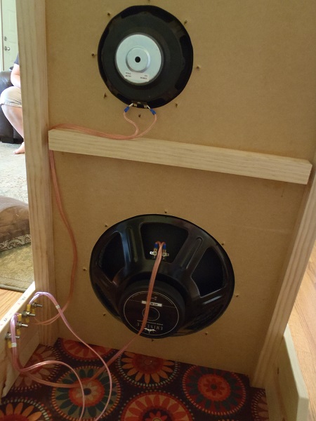

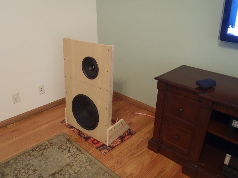

Thought I'd share my successful Open Baffle speaker project with everyone. I used WILD BURRO AUDIO LABS Betsy's for my full range and Eminence Beta15A for the low frequency. mounted in 24 x 38 baffles. I Bi-Amped the speakers feeding the Betsy with my AVA Ultralinier 35 watt tube amp and the 15A with an Emotiva UPA-200. The Amps are feed by a dbx 234 electronic cross over set at 200 hz. This allows perfect selection of X and individual levels.
Unsure of what to expect I just built prototypes, dang it, now I can start over and make them look as good as they sound... So good they permanently replaced my Paradigm Studio 100's.
Ed
PS They are pitched back 5 deg for full range axis alignment at my listening position...

I though so also that's why I got a 3 channel dbx that is capable of that...... It has NOT proved to be an accurate theory.

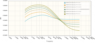

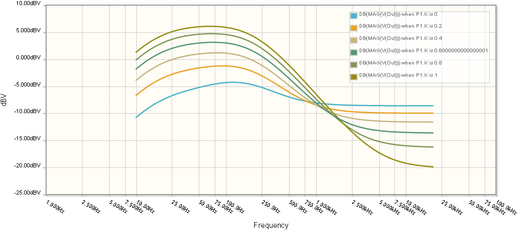

I also designed and built my own pre-amp its capable of frequency slope adjustment. See attachment. Like I said the Studio 100's are in the closet.... They have more than acceptable response, detailed bass, strong base punch when cranked, make you weep mids and acceptable top. The active Xover BiAmping is the secret IMHO.
As always, these sound awesome to my ears in my house with my equipment.

Thanks for sharing all this, your speaks look great! I have spent the last week trying to decide what the Non-Prototypes should look like...... Its driving me nuts! Do you think MDF adds any benefit over Birch plywood?
