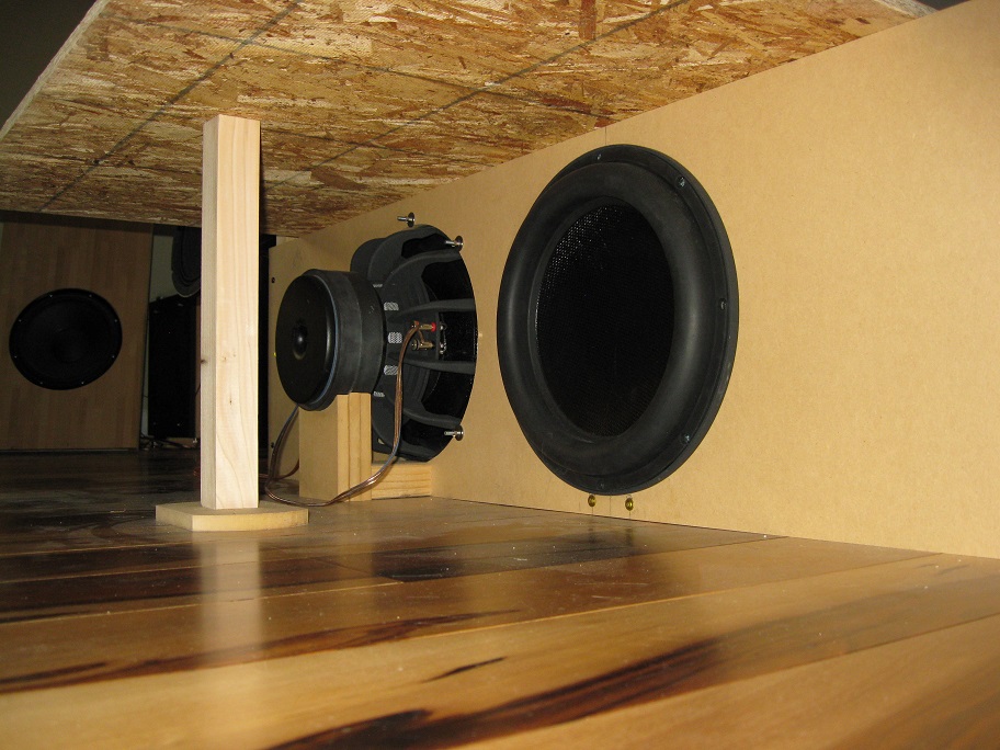

@Retsel:
I just built a system with a modified H-frame that has fantastic bass. Two 12" drivers are mounted to a 14" high baffle that stands on edge. To keep it upright, I created cradles for the magnets of each driver. One driver faces forward and the other backwards, so a magnet sticks out on each side and in the cradles the drivers+baffle is quite stable. Then I just plopped a 36"W, 40"D board on top to form a table, adding one leg in the front and rear on the midline to provide stability. I put my amps on top of the table, which helps to weight it down. The sides remain totally open, so it's not a true H-frame but more like a folded baffle. The "line resonance" happens around 150Hz but since it is the same front and rear I just EQ it out. The long pathlength (1m) makes for very good dipole bass response even though it is "open". Of course I do need to EQ the response and boost the low end but the quality of the bass is very nice (system is only 1 week "old" at this point).
Pic of underside is attached. This is only a prototype so please excuse the cheap materials and lack of finish.
