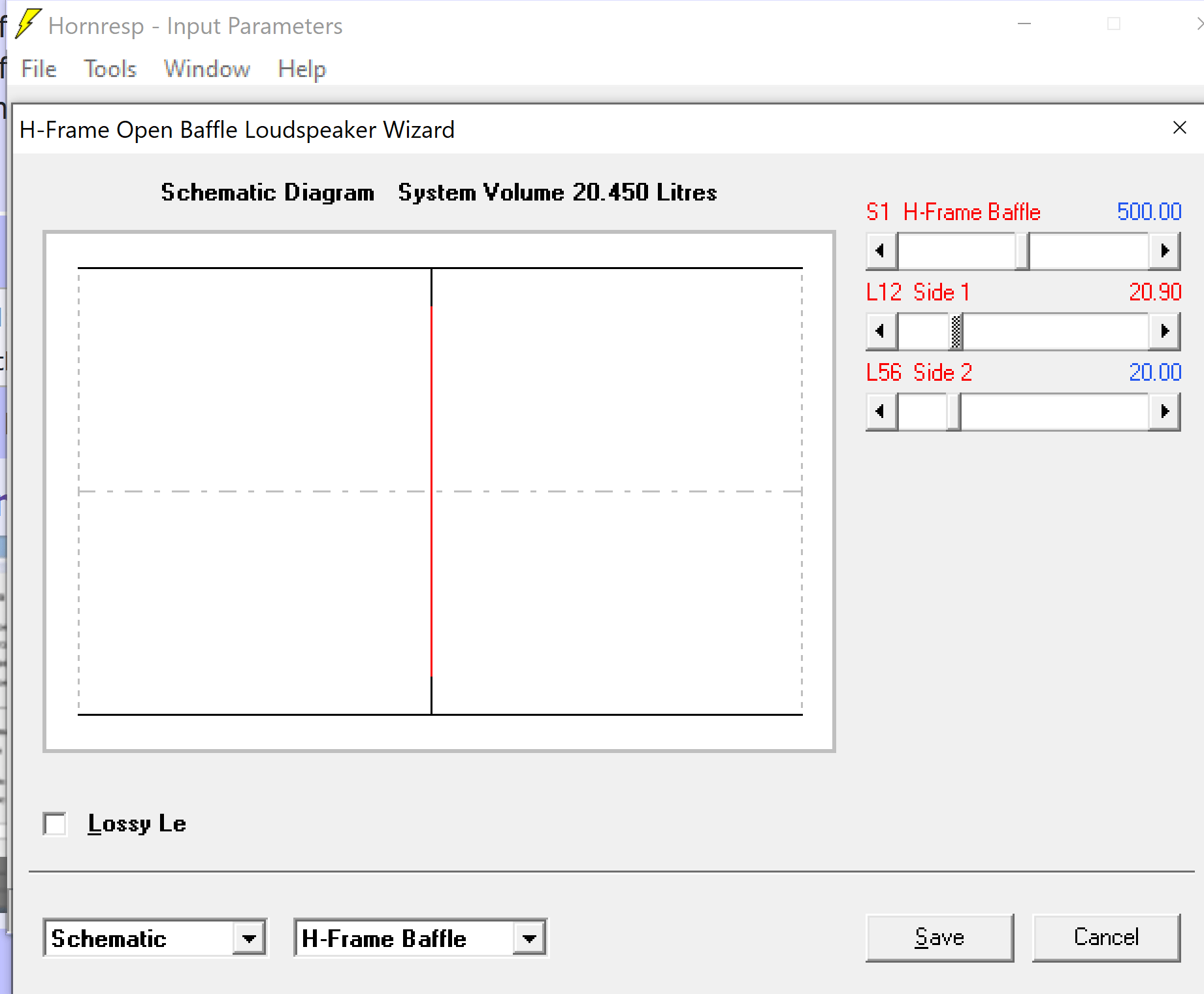

Open baffle sub

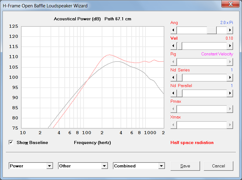

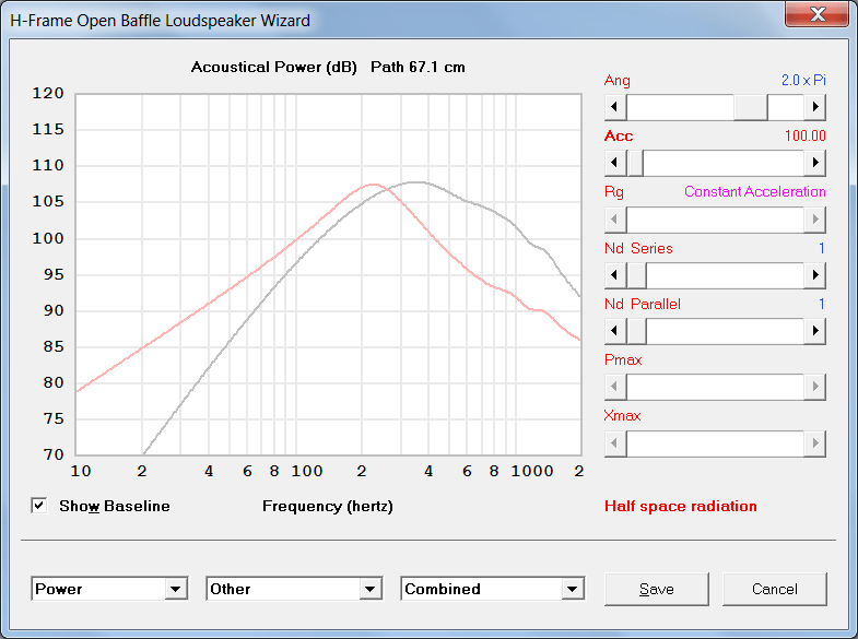

Simply adjust the S1, L12 and L56 slider controls in the Loudspeaker Wizard and observe how the response changes.
Thank you!!

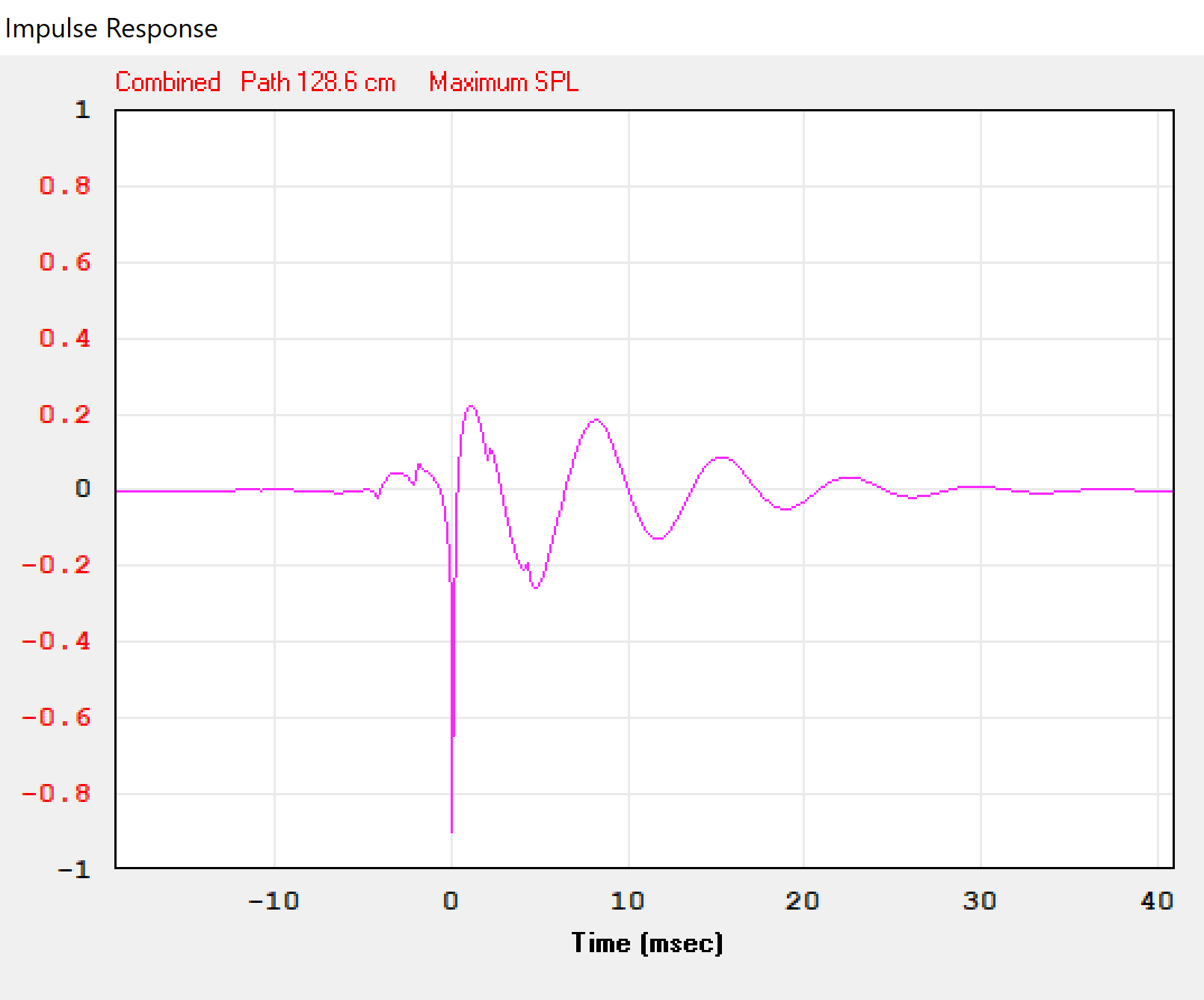

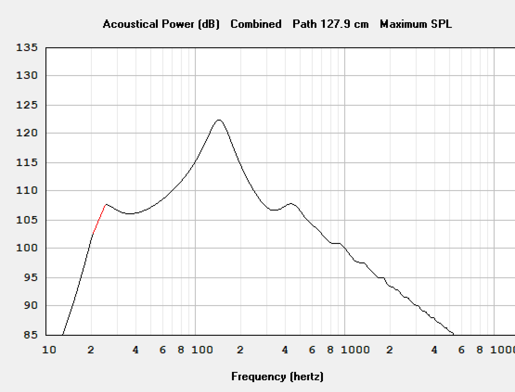

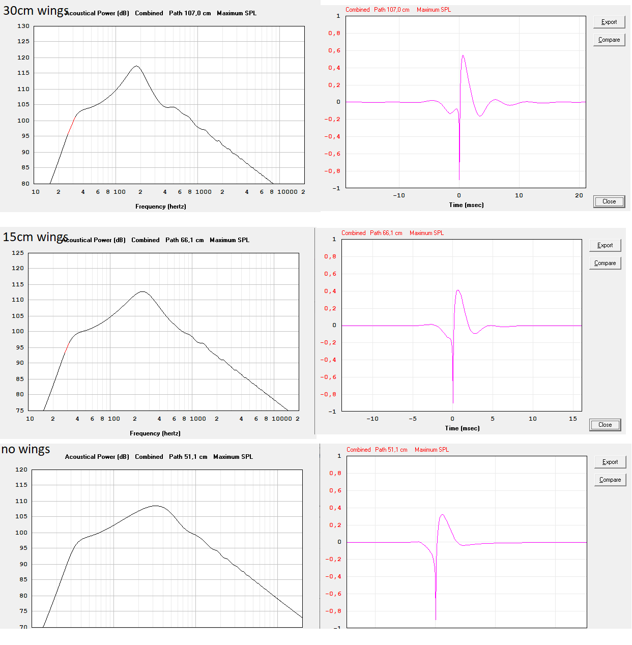

I modelled the same 18" in a 60x60cm baffle, with 1cm/15cm/30cm wings each side (so the box looks 2/30/60cm deep) to get a sense of how chamber resonances are portrayed. Here's the power response at 12W (because the driver hits Xmax around 31Hz) and impulse for the three:
Impulse seems to be telling: with 30cm wings there are still oscillations at 10ms, while with 15cm oscillations are gone by 5ms, and without wings they are gone by 2.5ms or so. Similarly for pre-impulse oscillations. Wether that can be heard at low frequencies it's maybe a matter to discuss, but is this the right way of looking at it?
From this excersice I'm taking away the shallower the H, the faster the settling time (from the impulse) and hence cleaner sounding (true?), at the expense of the driver reaching Xmax at lower SPL (like 93dB SPL at 30Hz with 1cm wings vs 100dB with 30cm).
Am I getting this right? A m I missing other key indicators to look at to come up with the dimensional design?
Thank you!

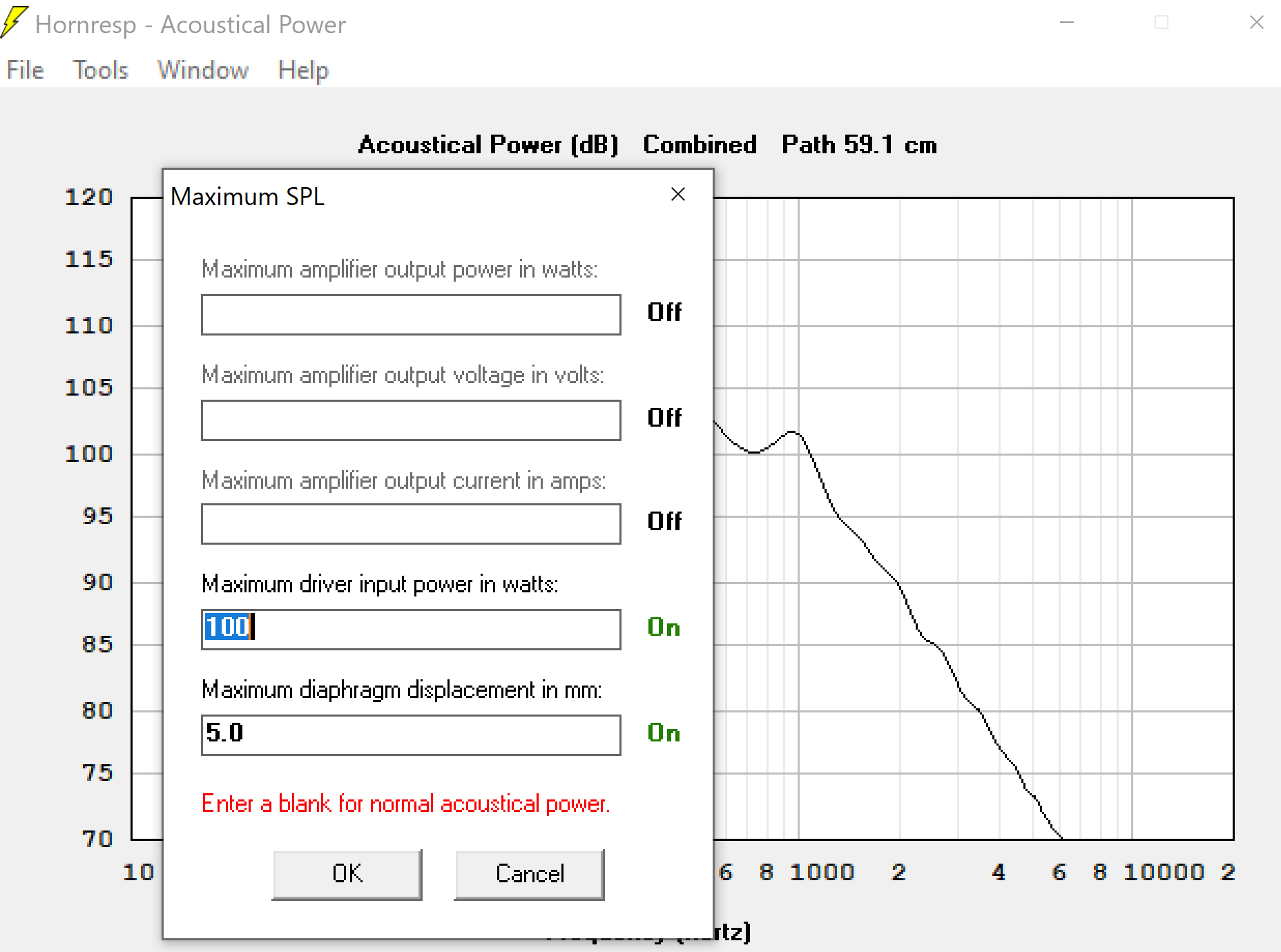

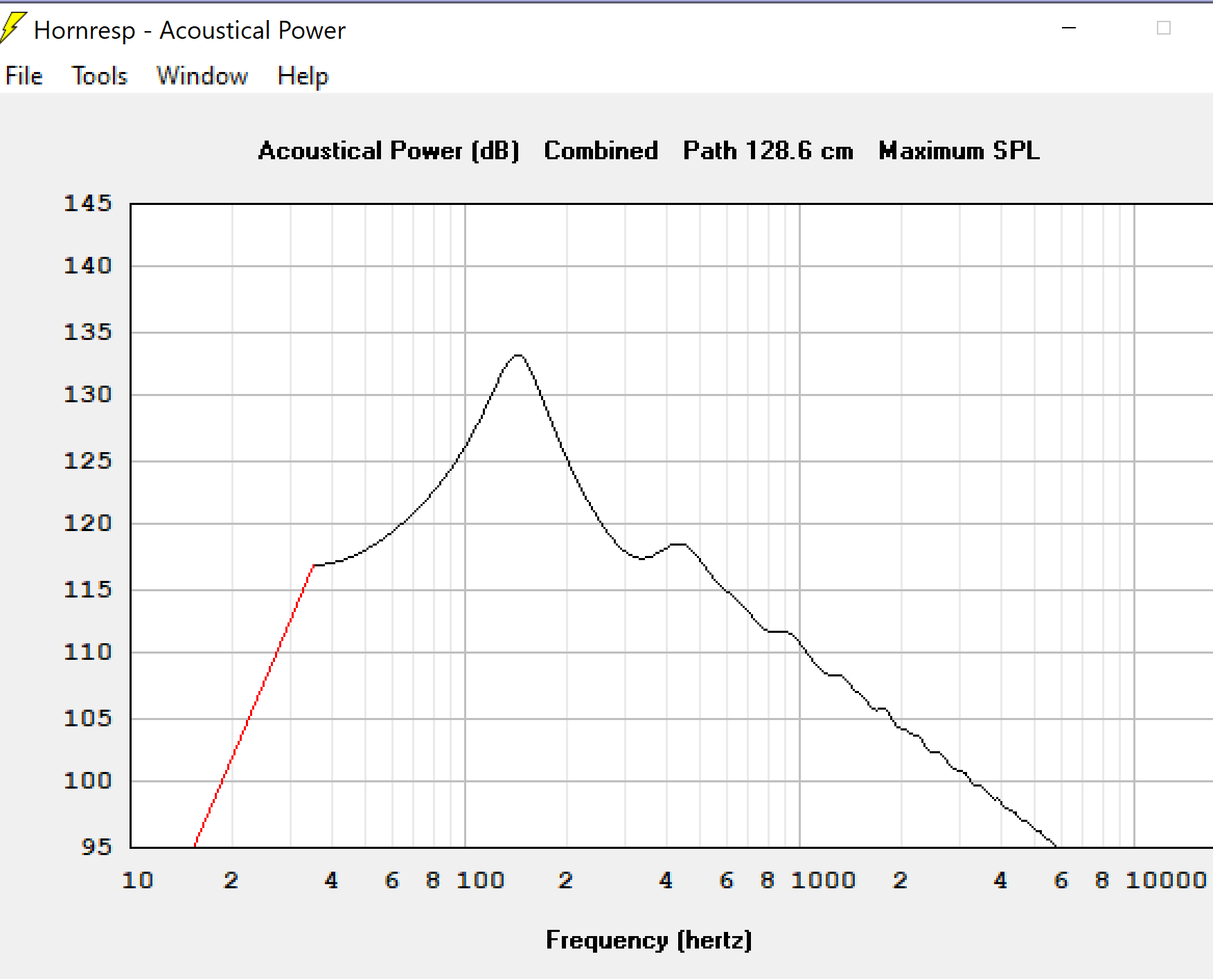

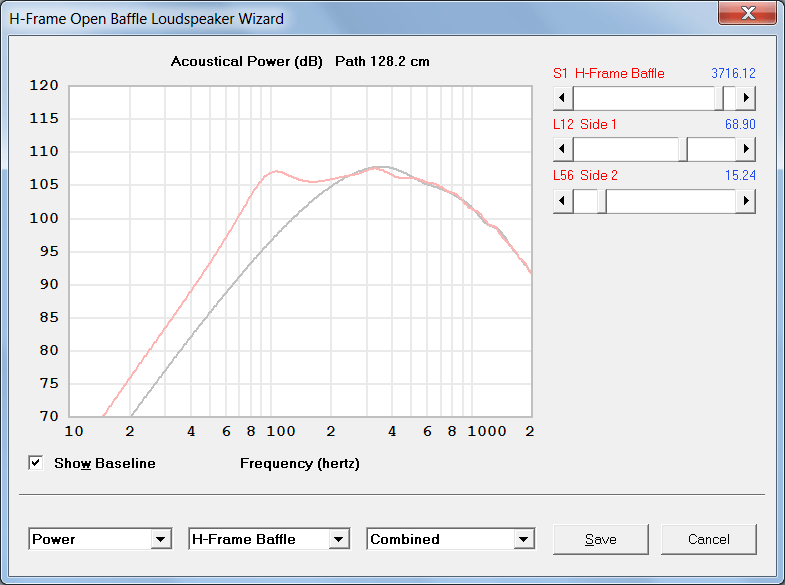

Can you plot the frequency response for 2.83 (or 1W or whatever) input instead of max SPL?
Hornresp appears to default to SPL @ 2.83V at 1m, so its the first graph that will come up for you but yields limited design info? For your H-frame:

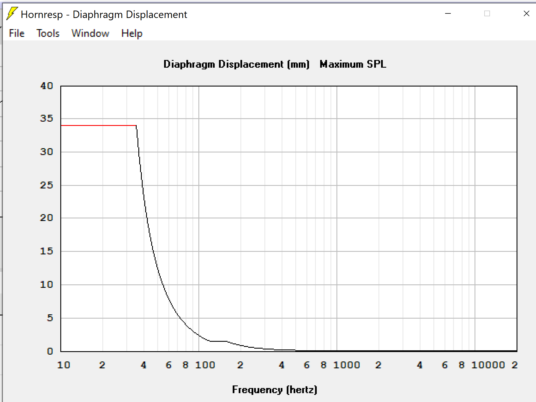

The max SPL feature is handy as it allows setting the power input to any value, which yields good design info on Xmax vs freq set points.
EG 100W
Outright Max SPL vs freq may be pivotal for those who want to design a bass response that delivers needed SPL freq without pooping out, damaging the woofer or exceeding Xmax and HD design limits.
Thats what I see. It makes intuitive sense too. Like a cave that is deeper echoing more. It suggests a plain baffle will generally give a cleaner response higher.
The other thing is the deeper the cavity the lower the peak. The peak is the quarter wave response. It limits upward extension. So a deep H-frame is like a subwoofer. Good for maybe 40Hz - 120Hz. So as you pointed out that then limits ringing into the midrange.
With the deep 30cm H-frame it looks bad pushing it under 40Hz. Theres that knee with a steep drop off under 40Hz. Pushing into that region is fighting a losing battle. Besides there are few musical genres with significant fundamentals under 41kHz.
So Id suggest redo the sim for the 30cm deep H-frame > Max SPL put in 1000W > check the power at 40Hz for Xmax > re-enter the W @ 40Hz > check what that does to the SPL at 40Hz - might just save needing a sealed sub for some

No. Honestly, looking at impulse responses of the raw system like this (without any EQ) is rather pointless because you would never use this kind of system without some major EQ and that EQ will have a major impact on the time domain response. The peak that results from the wings, or the H/U-frame sides, must be flattened. At the same time the LF end droop must be corrected by boosting the lowest frequencies or by limiting the LF extension. These changes will fix most of the issues in the time domain.

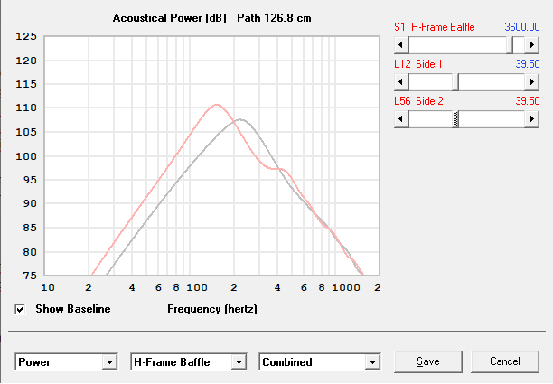

What I find to be most limiting is the internal 1/4 wave resonance. The deeper the cavity the lower in frequency it will occur. IMHO it is best if the peak of the (un EQ'd) resonance is located into the transition to the next higher band, e.g. at at least 1.25 times the crossover frequency. For example, if the peak is at 150Hz I would plan to cross over not higher than 100-125 Hz. So once you determine how high in frequency you need the 'frame to run you will have set the maximum depth of the H or U frame. This also influences how low the frame can be used (other factors like available amp power, Xmax, driver Qts etc will also influence the low end, of course).
In your initial post you mention you have subs that you will operate up to 50 or 60 Hz, and this considerably eases the LF demand from the dipole woofer that comes above that point. But I don't think you mentioned how high in frequency you wanted to use it.
Thank you Charlie!
Indeed, I have the two sealed subs to play the lowest and hope to add two dipole subs to play as low as possible to have a distributed bass array. On the higher end of the dipole subs, I'd like to experiment: I see people cross them at 100 to 120Hz, and Danny Richie (GR) recommending his servo dipole subs going up higher (150Hz if I recall correctly).
So if I hope to xo at 150Hz, then I should design so the resonance was at 190Hz: 1/4x30000/190=39.5cm. This is for each wing in the H, right? And for 120Hz xo then the resonance at 150Hz would call for 50cm wings. Seems longer than I expected.
Here's a simulation comparing an H frame with same baffle size and varying wings from 20 to 39.5cm each. The higher SPL at lower frequencies with the increased wings is evident here, but where do I see the resonance? Didn't find it on the acoustical impedance, nor the response...or maybe don't know what to look for?

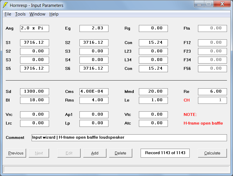

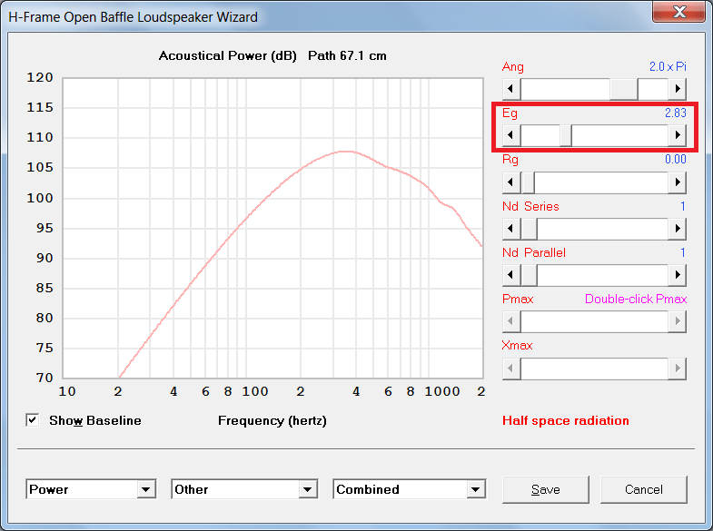

The default value for Eg is 2.83V (giving 1 watt into 8 ohms), but the value can be altered if required.
It is also possible to specify constant diaphragm velocity or constant diaphragm acceleration, rather than constant input voltage.

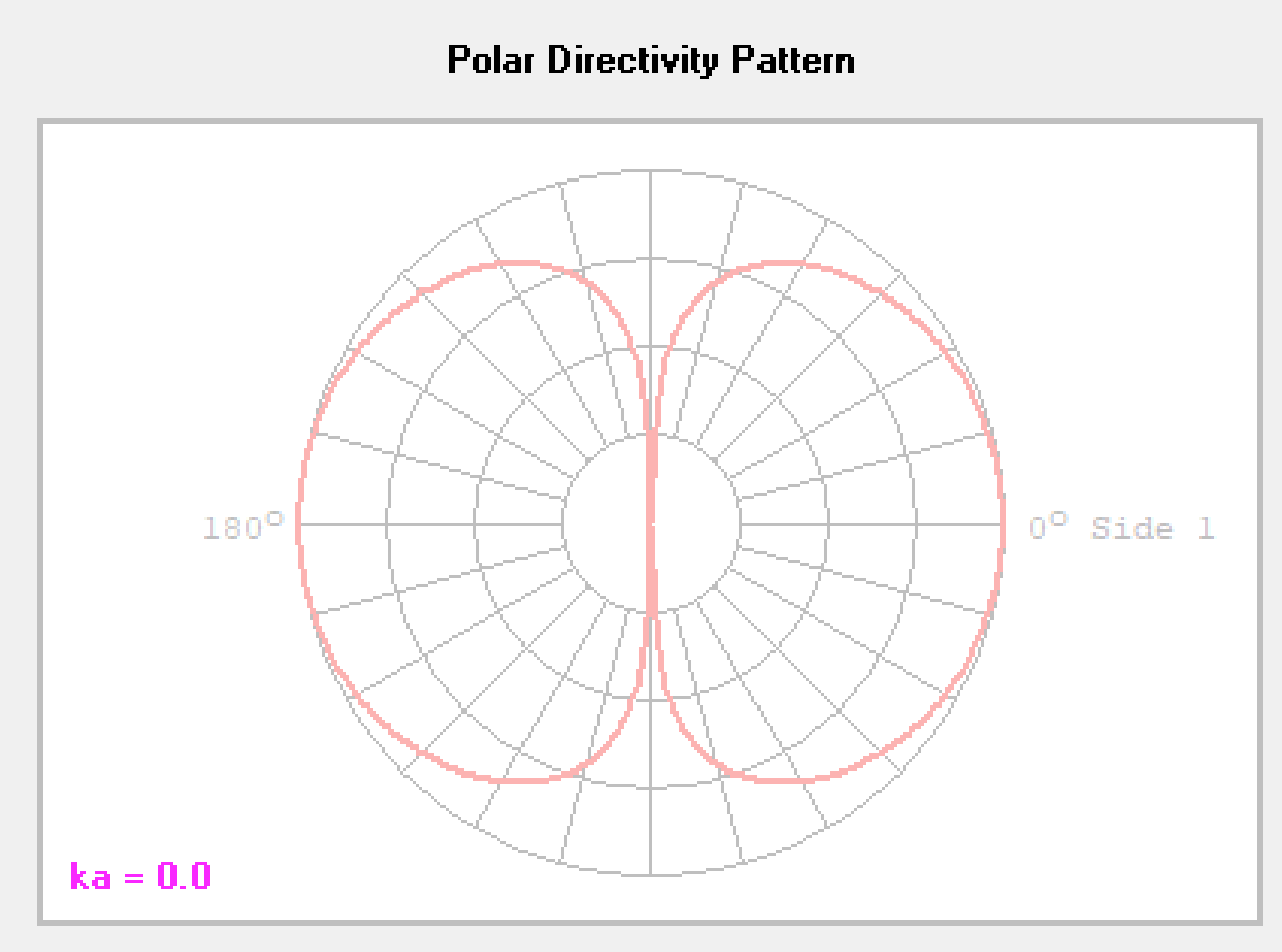

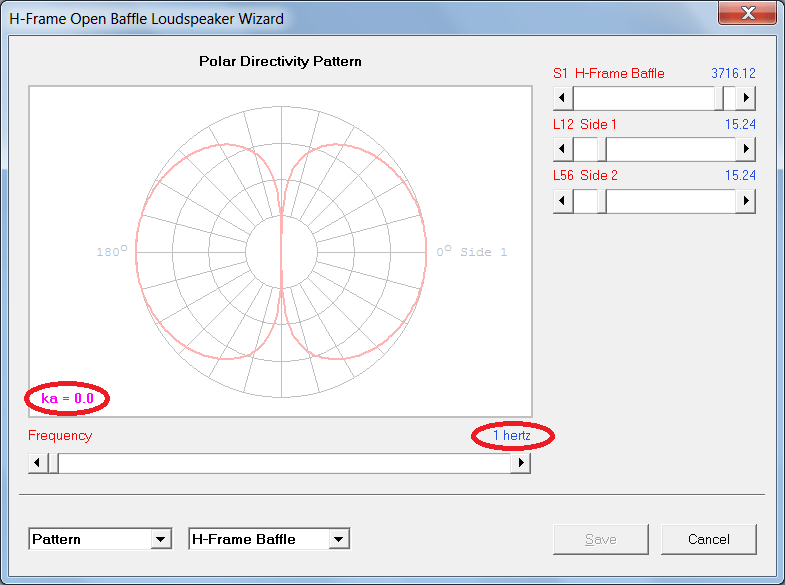

David, thank you for this wonderful SW! In post #22 you show also directivity pattern, but at what specific F is it?
Hi Juhazi,
kazap is the author of Post #22, but because ka is shown as 0.0 I would guess the frequency is probably 1 Hz. The frequency is specified using the slider shown in the attachment.
Kind regards,
David
