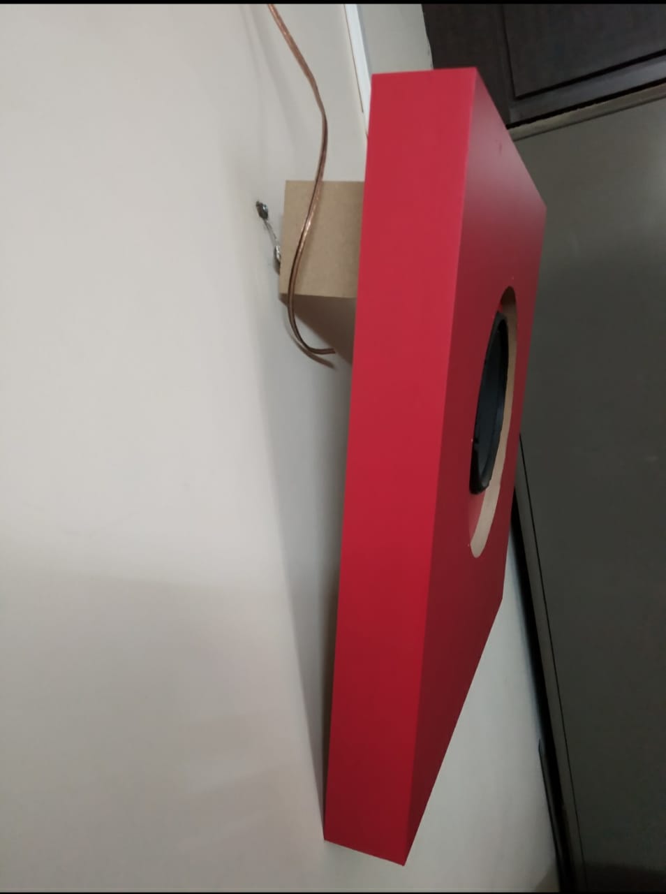

Im not mounting the driver on the wall. Driver is mounted on a wooden baffle (may be 2ftx2ft).
This baffle will be hanged to the wall behind the screen. Distance between baffle and wall will be 8 to 9 inches.
What are the bad effects of this arrangement. ???

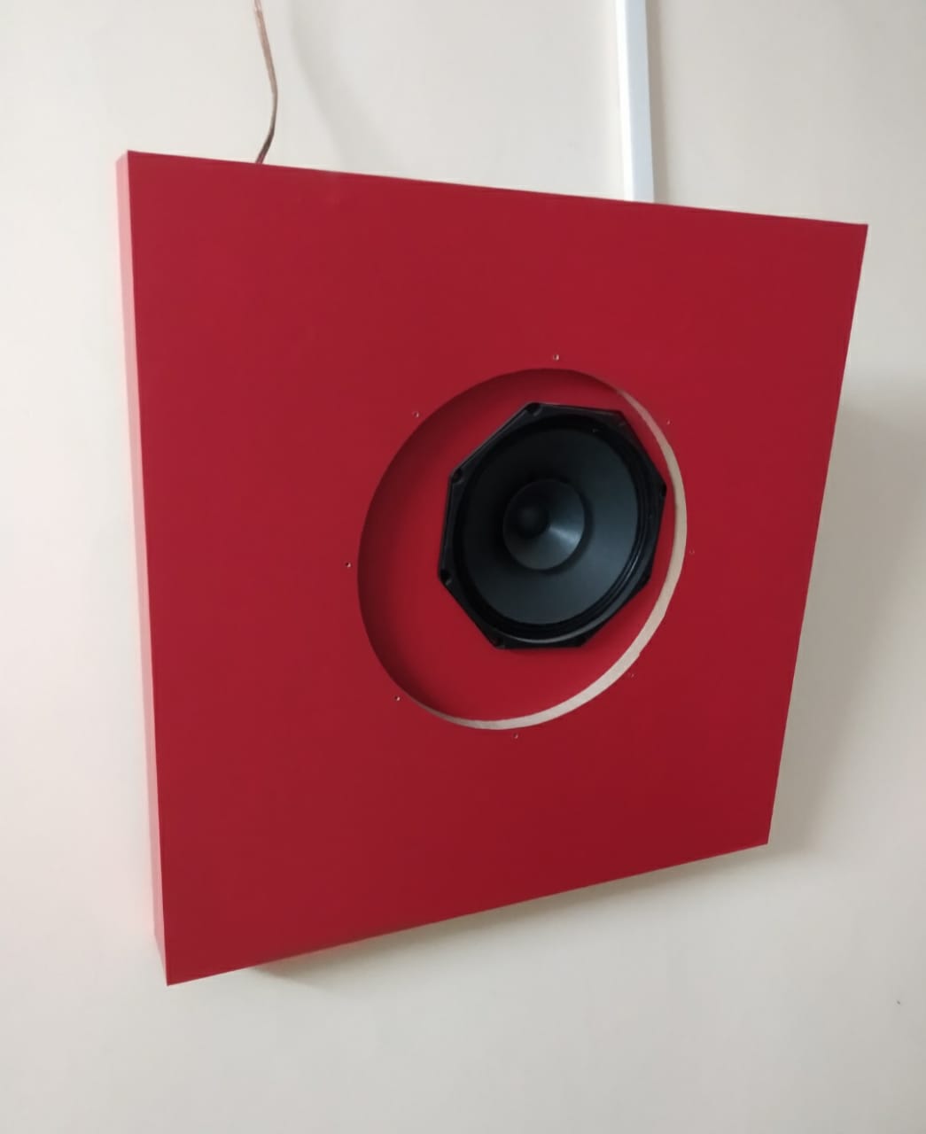

here we go with pictures.
these will go behind the screen for L C R channels.
Are there any illeffects like rear wall reflections, cancellation of frequencies etc etc .....
An open baffle implies abbundant fre space behind it ... at least few meters.Okay....in terms of physical construction, the driver is mounted on an open baffle.
The idea is that the back wave "gets lost".
But if there is a large wall 8 inches behind, while baffle itself measures 2 x 2 ft ... as I said earlier "it´s not an open baffle any more"
Soundwaves will exit sideways but first bouncing from baffle to wall, back and forth.
Do the test yourself, just grab the open baffle and place it 8 inches from the wall, play some nusic (or pink noise) , listen, then move it closer and further away.But technically it need not be an open baffle essentially. Im just concerned about the bad effects.

As a side note: a 2ft by 2ft open baffle is really *small* .
Not sure how much bass you can get .

The OP means the baffle front is behind the screen line, but obviously to the sides, right and left ... where conventional speakers might be mounted anyway.
Im not bothered about bass at all. Subs will take care. Issues with Mids and highs im thinking about. Mainly reflections as you said. This is for movies mainly. Not for music.
At a later stage i may construct a full baffle wall behind screen. But it takes some more months. Till then im just thinking of mounting the speaker as shown in the pics.
Just want to compare bad effects of this idea Vs sealed boxes behind screen.

Im not concerned about screen vibrations etc.
I have to make a decision whether to build sealed boxes or my baffles idea will work temporarily (till i build a proper baffle wall)
with my baffles near to the wall, ...Will there be any bad effects in terms of audio ??
Like....Resounds ..
Muddy or unclear mids and vocals, ..
Shouty highs or loss of highs.. Etc etc
If baffles mounted on wall is really a bad idea, .... Il build sealed boxes.

Go in wall if you can, not on wall.. It's behind a screen anyways so if you don't mind making a few holes and the walls aren't solid concrete or something, do an IB install rather than OB..
I agree with those who say just try it. If you could get someone to hold the baffle and move it towards the wall whilst you sit and listen, that would give you a very easy to judge situation. Because the open aspect at the back is compromised by the near wall, I would suggest putting quite a bit of foam or wool or other absorbent between the wall and the baffle. It will clean up the sound. Try it and see.
I dont mind holes in the wall. My wife does 😀😀Go in wall if you can, not on wall.. It's behind a screen anyways so if you don't mind making a few holes and the walls aren't solid concrete or something, do an IB install rather than OB..
