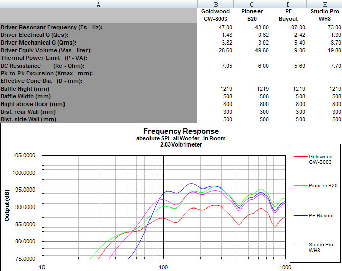

I simmed charts of the B20 on ob and will post them again next week when i get back to office... it went down to about 200hz. I have them on ob but with woofers beneath them so they sound full... without the woofers they still make music but are not reaching their potential. They also need a tweeter to sound their best too. It's a good driver and can be used successfully in many ways.

I simmed these drivers on open baffle to see if they made it to 200hz so i can blend a woofer in (also on open baffle). The B20 sounded great actually. I have been rolling drivers on the same baffle for the last month. The Betsy, B20, PE Buyout and TB 1808 all sound great. The TB sounds best, having the most expressive midrange.
