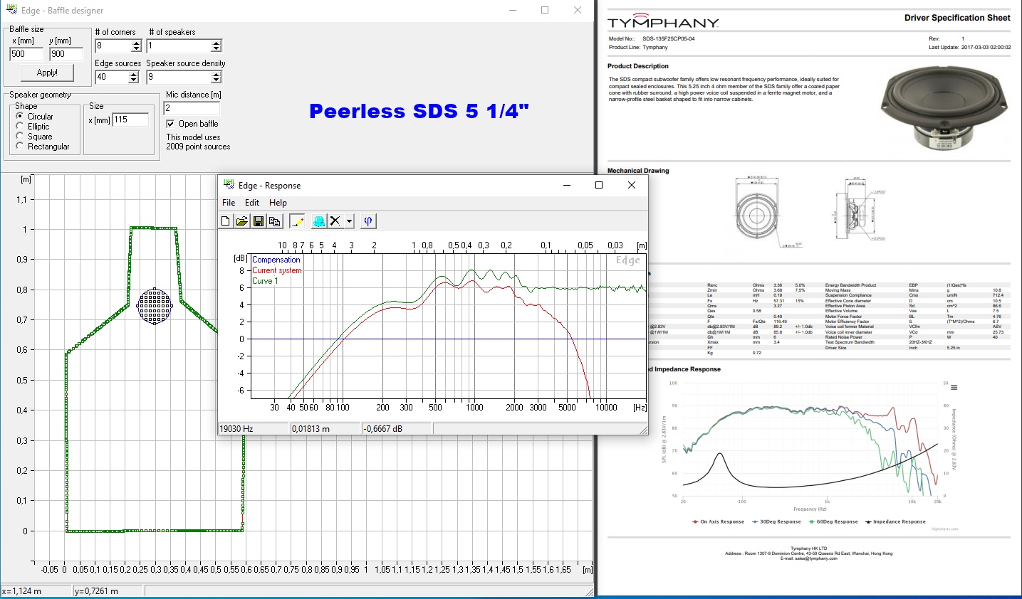

Peerless SDS is really fine and inexpensive!
Peerless by Tymphany SDS-135F25CP05-04 5-1/4" Paper Cone SDS Woofer 4 Ohm
Just replacing a 8" with smaller doesn't help much, you must cut a new baffle!

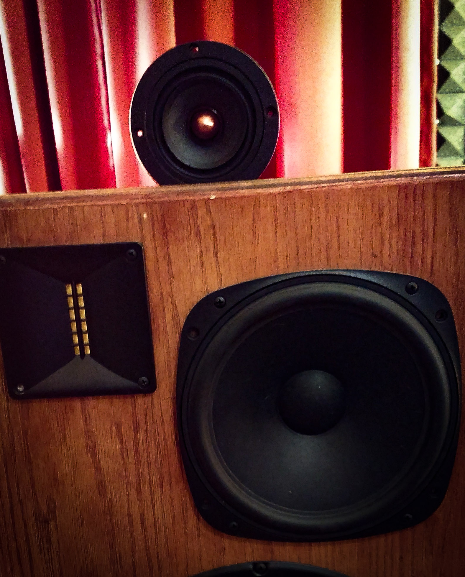

I'm not worried about going from 3 to 4 way. I've been doing this for awhile. My thing is: Is it worth it? I love my speakers. Maybe that time, effort and money would be better spent on some super-duper hoss-*** baffles. There is certainly room for improvement there. Also, I'm running a MiniDSP 2x4 with a cap and coil on the tweeters and the DSP on the mids and woofers. Perhaps I should get them into the same DSP realm. That opens up the whole time-alignment thing which may be more important to the task at hand.
Having said all of that... these SB 8" drivers are special. They are the stars of my OB show. I know I'm crossing them over way higher than a sane person ever would (at their rolloff). I know a lower X/O will change the imaging but how will it change the SOUND. I seriously love, love, love the vocals and highs that I have now.

The reason i mention simply swapping out the 8 for a well behaved 5 has more to do with the difference in the "sound" of a well damped cone in breakup VS a cone operating as a piston, and how that may match the ribbons character. Something I cannot explain well but I suspect it has to do with coloration's associated with well damped materials and their mechanical properties effect.
I have no doubt that 8 is a good one. In my own experience just about any cone that can be run basically without a crossover can have something "special" about its sound. I believe this is largely responsible for the attraction to single driver systems.
However to my ears ( years of developing ribbons etched into my ear brain thang), its a better match to have a cone that is not in breakup mode to match a ribbon no matter how well behaved the cone is.
When I first noticed this effect it was experimenting with a 2 inch dome between 8" cones and small ribbons. This avoiding the smooth BUT somehow less "clear" sound of just a good 8 inch with the ribbon. Eventually tried some planers in place of the dome and got a similar result. From there got rid of the dome and the planers and went to smaller cones in place of the 8. Eventually realizing that some small cones ( particularly metal) had a similar clarity without the use of the dome.
Some research into this leads me to believe that although some cones measure very good through their breakup region, there still seems to be something about there sound that is not as clear as a cone that not in breakup.
Anyway in the end IF you bought a good 4-5 inch driver you can experiment and use it in more than one way. You can simply replace the 8" driver , OR, you can use it as a 4 way and maybe make new baffle shape. Eather way there should be a good outcome in there somewhere.

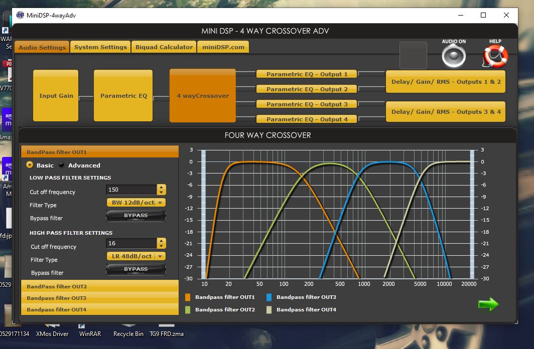

Whelp, I ordered another MiniDSP 2x4 last night. Getting rid of the cap and coil on the tweeters and moving them to the DSP realm will have immediate advantages. Also, my Ebay amp arrived today so I'll have all of the capability to investigate more 3 way and 4 way options. I also forgot that I have 4 Dayton DA-115's on hand from an earlier project. Time to start playing around. Thanks everybody! I'll keep you posted.

Maybe. It depends on whether you actually do any measurements and crossover development, or if you think you can tune "by ear". Which is it? DSP just makes it faster and easier to get the speaker up and running, it does NOT make any promises about whether the speaker will sound good or not. That is the designer's problem. DSP is just a tool, and it can be easily misused or misapplied.

DSP makes it faster and easier to really screw everything up. My approach may be unconventional but I still start out with a WinPCD just to see how drivers will behave. Then I start in on the DSP settings and then I measure from the listening position.

Just a quick update if anyone is still interested. These PS95's were on sale so thought I'd give 'em a go. That's a temporary mounting situation and hopefully this weekend I can get them mounted on the baffle under the tweeters.
Just ear-balling the X/O at this point but the results are promising. I think the major improvement at this point is getting rid of the cap and coil on the tweeter and going full DSP. Another 120 watts of power in the system doesn't hurt either. 😀
Current X/O settings. I do have some EQ on the upper mid; a very shallow Q 2dB hump centered at 2Khz. I think that may have something to do with their nakedness. Time will tell. Quick smart phone measurements (don't judge) show fairly flat response from 40 - 12 Khz at the listening position. I do have a +3dB high shelf on the tweeters above 10 khz but that may be due to my 53 year old ears. Anyway the imaging does seem to be incrementally better. Not earth-shatteringly better but at least now I have much better control over ALL of the drivers. Win-Win. Oh, and for the $20 a pop I paid for the PS95's: great little driver for the money.
