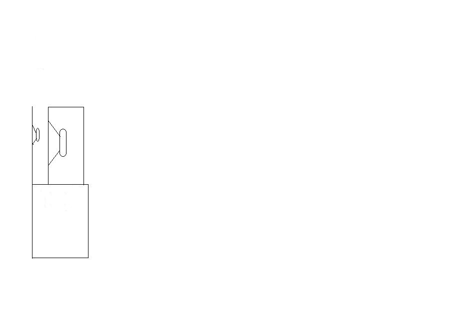

I am adding a pair of subs to the setup and was wondering if it would be
possible/sensible or what problems I would expect to hear If I placed
the subs on top of the open back box - behind the baffle effectively
almost blocking the back of the mid and tweeter drivers?
I understand this would interfere with the back wave of those drivers?
or maybe just the mid since I am using a ribbon tweeter with sealed
back as appose to conventional driver...
Is it a recipe for disaster? I am only tempted because the subs I have in
mind are a perfect fit...
Secondly.. assuming the first placement is an absolute no no...
if I placed the same subs approx 2" away from the backs of the drivers
so there was still gap all the way round, would that be a bad move too?
Excuse my vocabulary.. But I hope you get the sentiment of my question
In a nutshell I just wondered if it would completely ruin the sound.
Like this??
No you shouldn't, the pressure wave from the sub will hit the cone of the Mid setting it in motion..........
Note the example you have given, the Sub is near to the floor to better "couple" to the floor...and the distance from the subwoofer to the Mid cone is a measured precise distance. The output of the Sub will be diminished if it is "lifted" from the floor.....the backwave of the Mid "should" be unobstructed.

It is a bad idea because you create a cavity resonance in the midrange. You will ruin the sound.
