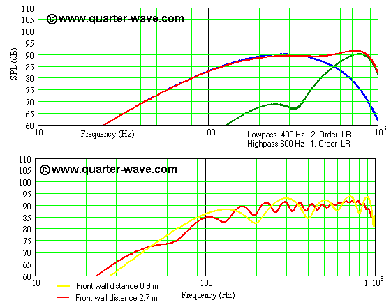

So this is what is my mind now :
Plain open baffle speakers with wings, total size more or less 20" x 50" (50x110 cm). Fostex FX120 placed off axis ~1/3 of the distance from the top. No tweeter, no filters. I'm not going to change this great speaker and all I really want is to reinforce the lower frequencies range. don't need want to force the fostex too low, I'm not concerned with on-axis peaks, eventually I'll only adjust the level, killing a few dB to make the woofer job easier.
Woofers ? I've been reading about this topic for a while and am quite confused. So, according to S. Linkwitz a low Qts woofer gives a better impulse response and is easier to design active EQ. Surely well implemented in his sytem, but it's a complex design to start with. Some people try to extend the range of one speaker only with EQ. Maybe it's ok for a high-quality and larger speaker, but I know my fostex's bass is poor in sealed and ported enclosures.
Others prefer high Qts speakers that will roll of more gently and this is what I want to try.
Eminence alpha 15" would be the best candidates, ~95dB low Fs and Qts of 1. Less than 60$ each.
But I'm also tempted to try two 12" or 15" goldwood speakers (9.50$ to 27$ each) per channel. they have a qts close to 2(!), small magnet, huge Vas and response up to 1-2kHz, ~same sensitivity as the FR. Ultimatley, crossed with a good fullrange driver they only have to do some sound "reinforcement" up to 200-250 Hz where the FR takes over.
Do you think it might be worth a try without active EQ? Or the dB drop on OB is too significant in that frequency range ? what about using woofers 10 dB more efficient than the FR ?
thanks,
Lorenzo

Lorenzo,
MJKs new Open Baffle worksheets at www.quarter-wave.com are a big help at looking deeper into your problem.
In the first diagram I have combined the FX120 (green) with the Eminence alpha 15" (blue). The resulting response is red. This simulation is calculated for a listening distance of 2 m and includes the influence of the floor. Crossing over at 550 Hz you can elegantly eliminate the floor bounce.
The second diagram shows the additive effect of a front wall behind the driver. The reflections from that wall can push up the SPL around 100 Hz, but you will need some kind of EQ for sure.
High and Low pass certainly can be further optimized. Please note that both drivers are running on the same level. There is no boost or attenuation of any driver involved.
If you could lead me to some TS parameters for those Goldwood speakers, I could look into that combination too.
