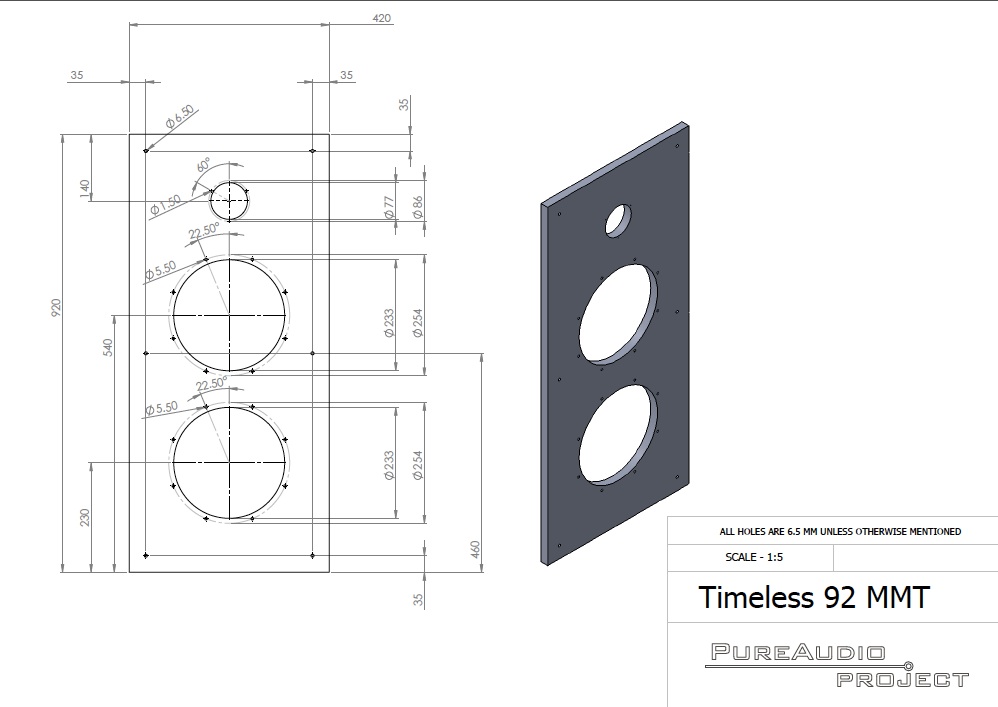

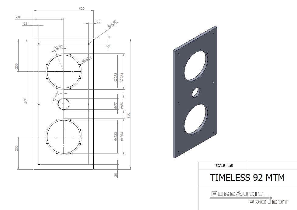

At first I wanted to try Morel Time less, but the midbass + tweeter is logically not completed construction. Clearly not enough mid driver. Now I want 2 x 10"midbass + 2 x 10" or 8 "mid driver and tweeter. Or without tweeter if mid driver go too high. And now I need help finding components

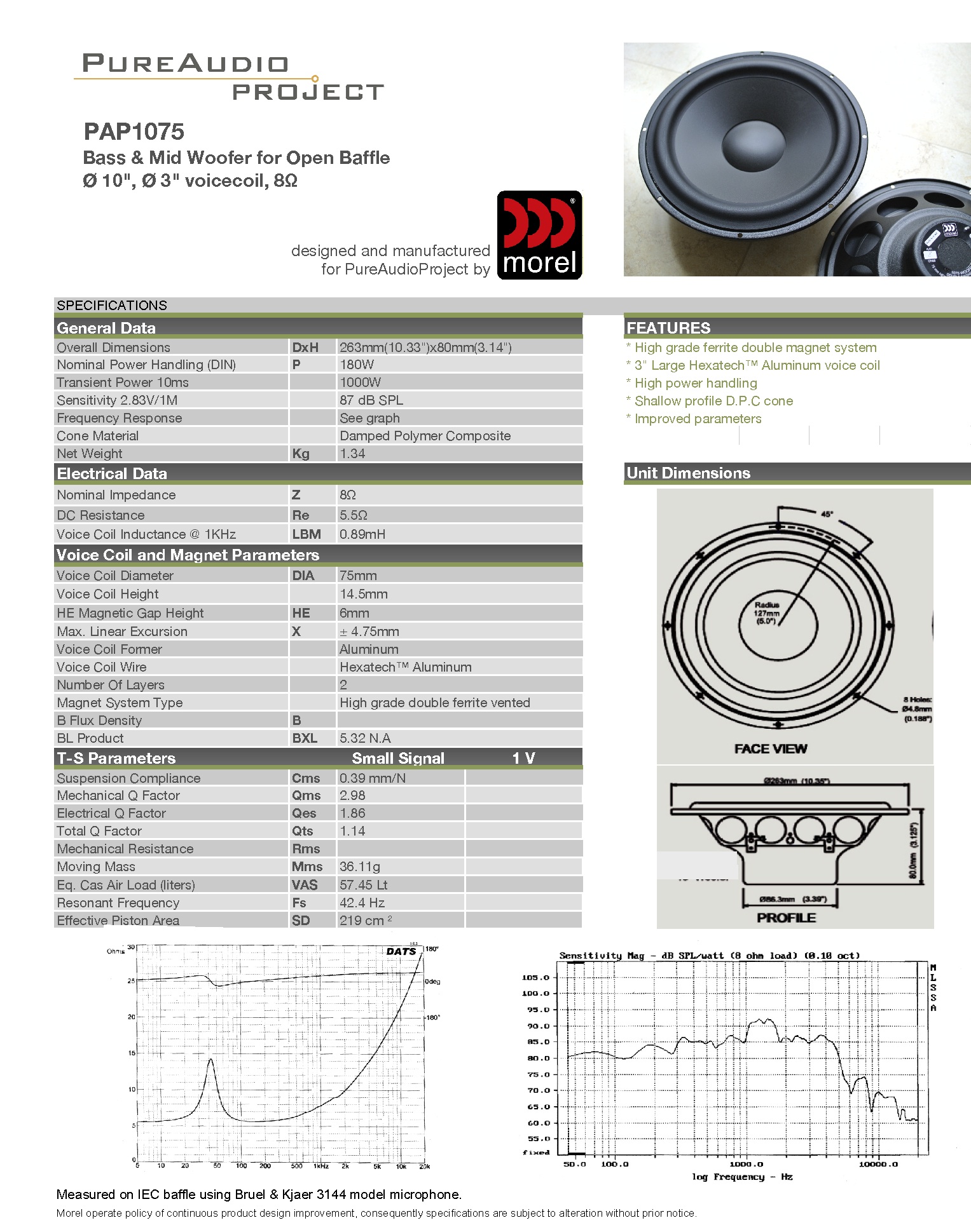

You wrote: " The 10FE20 is a surprisingly low price driver that plays very deep and effortless bass and integrates reasonably well with full range drivers, if you don't take it too high (up to ~200hz)."
I'm wondering if maybe you had defective drivers? I've used the 10FE200 drivers, and they don't extend below 50Hz but they make excellent midrange drivers with great clarity well above 3KHz!!

on WinISD with very large vented box it goes down to 33hz. and with 120lit vented goes down to 43hz.(120l) is not so large.
