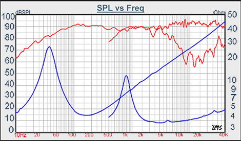

Coaxial MT should be nice for nearfield dipole, but it would have to be 3-way again. I would try that with new TangBand 8" coax, because of moderate cone resonance allowing high xo. The tweeter doesn't radiate backwards, LR2 around 4kHz might be worth trying. Yes there is cone resonance 3-5kHz, but xo smooths it quite a bit. I recently listened to SEAS MR18 as dipole MT, it has more resonance but I couldn't hear it. WM xo depends on how much distortion is allowed for the dipole midrange, the lower the better, around 300Hz.
TB new line of Coax FR drivers
TB W8
