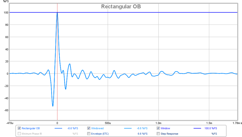

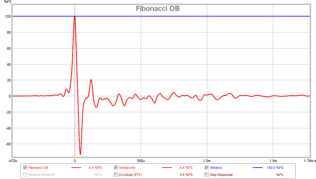

Measurements of Fibonacci OB vs Rectangular OB
I took my OB from this thread as a test case with the Vifa TC9FD: http://www.diyaudio.com/forums/full-range/249984-cheap-fast-ob-literally.html

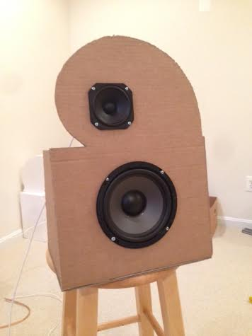

Here is the original speaker:
I then proceeded to modify it to look like this:

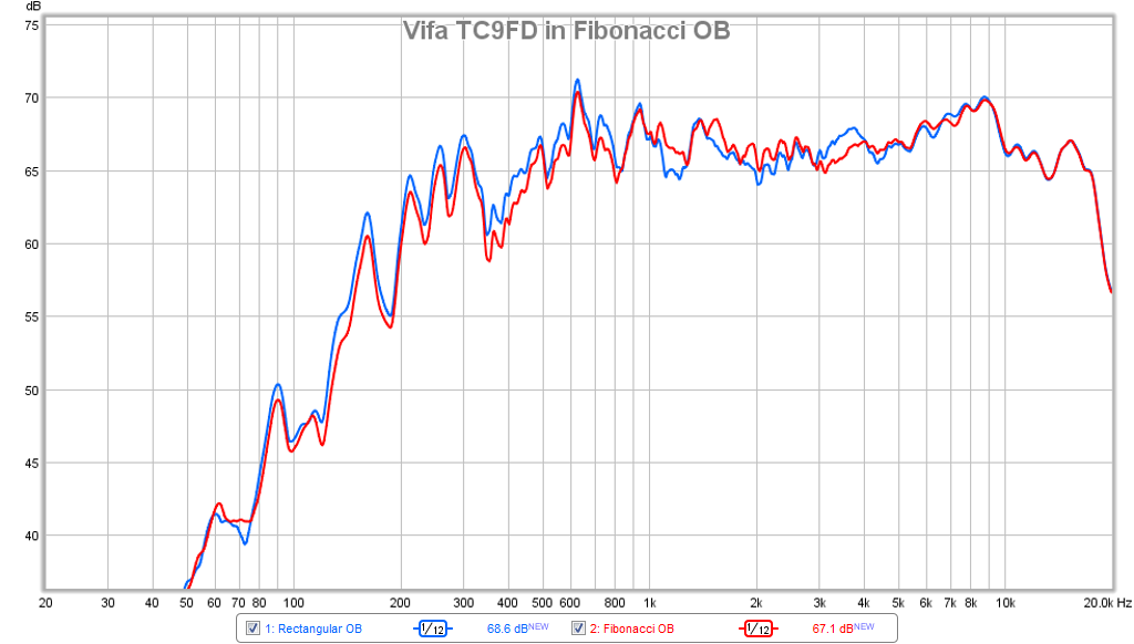

I measured the frequency response on axis at 1 meter away using a calibrated UMM-6 mic and REW software before I cut the cardboard. The I cut the baffle as prescribed by a rough hand sketch of the Fibonacci spiral. Being careful to replace the speaker exactly to the same measurement location as before, I measured the response after.
Here is a comparison of the frequency response before (blue) and after (red). The bass extension decreased slightly as expected but not much, which is good because there is still plenty of room to XO with woofer around 250 Hz to 350 Hz. There is a reduction in the dip at 1.16kHz and reduction in the peak at 3.64kHz by about 1 dB which is not much. The frequency response could be called slightly smoother looking I suppose.
The more visible change is apparent when you look at the impulse response which I think is better. It used to have a mild pre-ring followed by a major peak, now with the Fibonacci, it simply goes up to to a peak and has a large overshoot down and settles. I think this will translate to cleaner sounding dynamics for delicate percussion like piano, wire snare drums, high hat, bells, etc.
I did not get a chance to measure off axis or look at imaging as I only had time to do one. I would imagine imaging will be improved with a smaller baffle width.
Anyhow, there is a measurable effect and I think it is a good thing not to have any edge distances the same to reduce diffraction effects.

Good job!!!
I'm very delighted to see how they actually perform based on objective real data, thank you so much to have provided this measurement, very nice 🙂
In your first test article, the driver was placed at distance from left, top and right edge in the fibonacci sequence, the spiral is just a refinement, that's why data are similar.
I can't provide any scientific support to my idea about the Fibonacci sequence, it was just an experiment, but in the end it seems not so flawed I guess

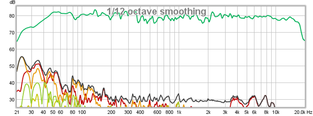

Btw, for comparison, this is what the TC9FD can do in a good sealed cabinet like the Nautaloss.
Damn that's a good curve! Now add a Sub for a stand and a Supertweet for a crown and you're there baby!
The $12 Vifa TC9FD, IMO is the best (at any price) full range driver for smooth response and uniform directivity for 200 Hz to 18 kHz, if you don't mind 85 dB at 2.83v sensitivity. Look at the Nautaloss Ref Monitor thread if you are interested. I paired with a sub from 40 Hz to 200 Hz and this thing rocks. -50dB THD above 200 Hz.
Here it is with subwoofer:
😀 No, bragging is to add that the above measurement was made on a set of speakers that was made using under $70 worth of drivers in cabinets made out of $10 worth of dollar store foam core sheets. 😀
