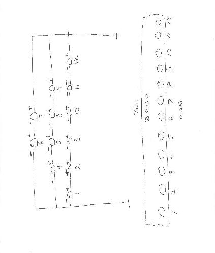

This is a new thread to address some questions I had in a different one. My idea is to use 16 Tang Band w3s-881s (each side) in an open baffle (dipole) line array. This would be mounted above a 10" sub of some sort, in a transmission line. The mid drivers will be mounted as close as possible to each other to help lessen comb filtering effects as much as possible.
So my questions are:
-Is this an idea worth pursuing?
-Am I going to be looking at any nasty artifacts by coupling a line array with an open baffle?
The ideas behind the Phoenix really intrigued me, and I was thoroughly impressed by a friend's DIY line array I heard a few months ago. I'm hoping the marriage of the two will give me a room filling sound that other speakers have lacked (I have a loft with 12' ceilings and an enormous amount of space).
I did some quick 3d mockups of the speaker i'm envisioning. Any feedback would be appreciated.

Parallel connection soloution - Line Arrays.
In this configuration, drivers recieve different power according to their position in the array - an attempt to to make a point source I think.
In my experience, to run different drivers in parallel, a zero inductance connection is needed between the drivers, and impedence (series RC network) correction is also required.
Eric.
Line array series/parralel connection.
I've just held my head vertical, and the center stereo-image disappears, and the closest / strongest source is the point where the brain think it's coming from. But: is that a problem? All the same drivers could be in complete parallel, so the energy is optimally divided.

"All the same drivers could be in complete parallel, so the energy is optimally divided."
Yeah, except that 12 8 ohm drivers in parallel will give 0.6 ohms total load.
This is ok if you have a <1 ohm capable amplifier, but most amplifiers are not.
An economical soloution would be to run multiple, say gainclone amplifers in each cabinet, and load then appropriately.
Eric.

The wiring I'm going to use is a series/parallel mix that should present each speaker with the same amount of power and keep the load at 8 ohms. Turning the line into a point source sounds like a Bessel array and that's not really the effect I'm looking for.
