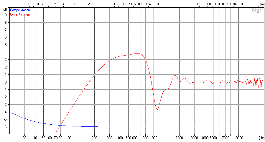

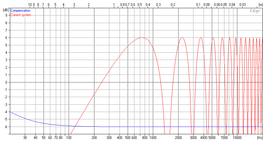

Never mind the guitar amp or guitar speaker, open baffles themselves have absurdly bad frequency responses of their own, unless infinitely large...this was the main reason why they fell out of favour so very long ago, even in a time when their large size wasn't a major handicap.
The first attached image shows calculated frequency response of a point-source loudspeaker centered in a circular open baffle...it's far worse than the worst guitar amp frequency response I've ever seen.
Yes, a circular baffle with a central speaker is the very worst shape, and that horrid comb-filter frequency response can be improved a little bit by reshaping the baffle and offsetting the speaker from the centre, but it is still pretty horrid. The second image shows measured frequency response of a roughly 5" speaker in a rectangular baffle - and it's quite horrid too.

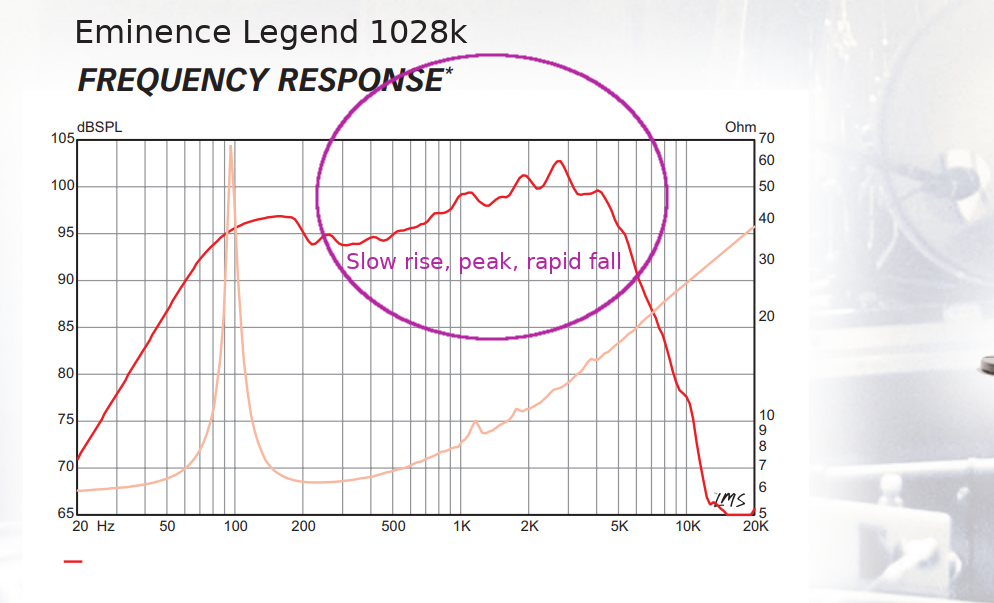

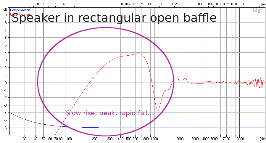

I have an idea: can we use the big peak in an open-baffle's frequency response to take a small midrange speaker, scale the baffle down to the right (small) size, and so give the speaker the peaky midrange response appropriate to a guitar speaker?
The midrange would then be married to a suitably larger woofer, and some sort of passive low-pass filter added to filter out the treble above the midrange peak caused by the baffle.
If it works, this might solve some of the severe treble dispersion problems that go with big 12" and 10" guitar speakers, while retaining the mechanical EQ curve they produce, which is part of good guitar sound.
-Gnobuddy
