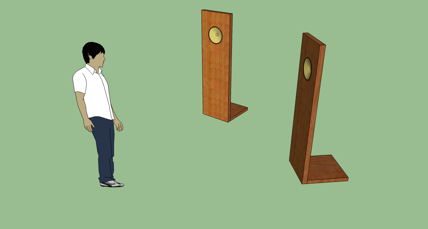

I am looking for ideas for an open baffle pair of speaker, that utilizes a single pair of full range drivers, and is simple i.e. no XO.
The application is surround speakers mostly for home cinema and occassionally for music (therefore quality must be descent).
Has anybody tried this? Any links to high-quality projects?

Unfortunately you are not going to get much bass response from a single full range driver on an OB. Depending on the size of the baffle, you probably should not expect much output below 100 Hz. The roll off will start even higher if the full range driver has a Qts < 0.5 and the baffle is of a reasonable size (< 24" wide).
a fostex fe167e may work well, based on an ifinite sized open baffle it will roll at 165hz (Fs/qts), also you need a large enough baffle to get anything below 200hz.

That is a problem as I also want to keep the baffle at minimum width due to WAF. A sub will take care of those low frequencies, but there might still be a small gap between 100-200hz.Unfortunately you are not going to get much bass response from a single full range driver on an OB. Depending on the size of the baffle, you probably should not expect much output below 100 Hz. The roll off will start even higher if the full range driver has a Qts < 0.5 and the baffle is of a reasonable size (< 24" wide).
Okay if we assume an infinite baffle then here are the options:a fostex fe167e may work well, based on an ifinite sized open baffle it will roll at 165hz (Fs/qts), also you need a large enough baffle to get anything below 200hz.
Driver Fs/Qts Power
FX120 70/0.45=155hz 30w
126E 70/0.25=280hz 45w
127E 70/0.43=163hz 45w
166E 50/0.21=238hz 65w
167E 51.5/0.3=172hz 65w
206E 39/0.18=216hz 90w
207E 39/0.26=150hz 90w
208ES 42/0.18=233hz 120w
So it looks like the winners are 127E, 167E and 207E.
Funnily enough the 167E is a good compromise between roll-off freq, power and cost. I would prefer the 207E due to the lower theoretical roll-off freq but it's too powerful for a surround speaker...Maybe will settle for the FE127E then
The budget I think should be around max £100 per unit, basically enough for a driver and some wood for the baffle. I aim for a very simple L-shape "enclosure" i.e. baffle, base, screws and spikes.What's the budget?

Alternatively the Jordan JXR6HD rates well at 80/0.495=163hz.
But the Jordan JX92S is the best of the lot at: 45/0.40=112hz infinitive baffle roll off. But quite pricey.
I am tempted to go for the cheap and cheerful 127E.
i don't think the jordan 6hd will work if not sealed, same for MA A5...
by my humble experiments a single driver farfield with that baffle is not going to work, unless the sub will go really high but then still you will have problem blending them... with some woofers you can go down to 40hz zone, than blend a sealed sub for HT duty, if you want narrow take a look at gainphile staff (mainly in multiway forum)

Thank you for your 2 cents.
I appreciate the baffle width concerns and I am prepared to compromise. After all the home cinema application is not super critical.
I will be tempted to use a driver that goes low enough. The FE127 or FE167 will start rolling off at 100hz so i guess it's not hopeless.
I had another idea: what if I used e.g. 2 drivers per speaker eg the HiVi B3S which is cheap and cheerful. Would it remedy the bass response issues?
cheers
um, 2 x b3s = 60in2 while a fostex 167e has a little more than double the cone area.
It (b3s) will sound blurry at lower volume levels than the 167e, even though the qts is more open baffle friendly.
