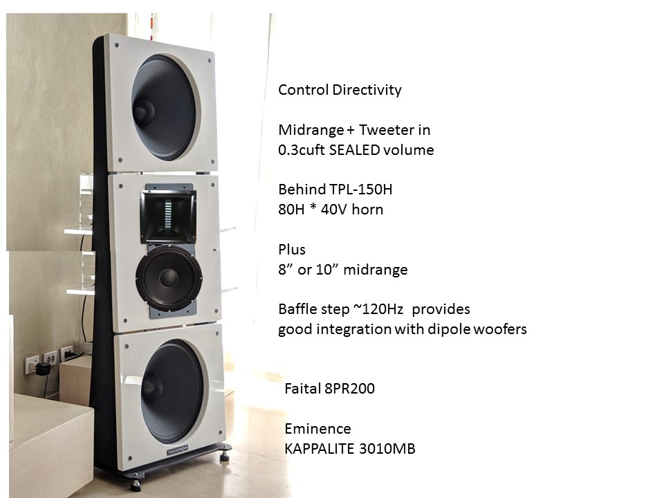

Horny? (strike 4)
The latest "Trio15 Horn1" design uses and LOVEs a HORN mid-bass!
Investing some study time on 3-way speakers blending dipole woofers with a horn tweeter and a sealed midrange can get you great sound in your room. A LARGE horn with a coaxial compression driver is the next expensive leap of faith.

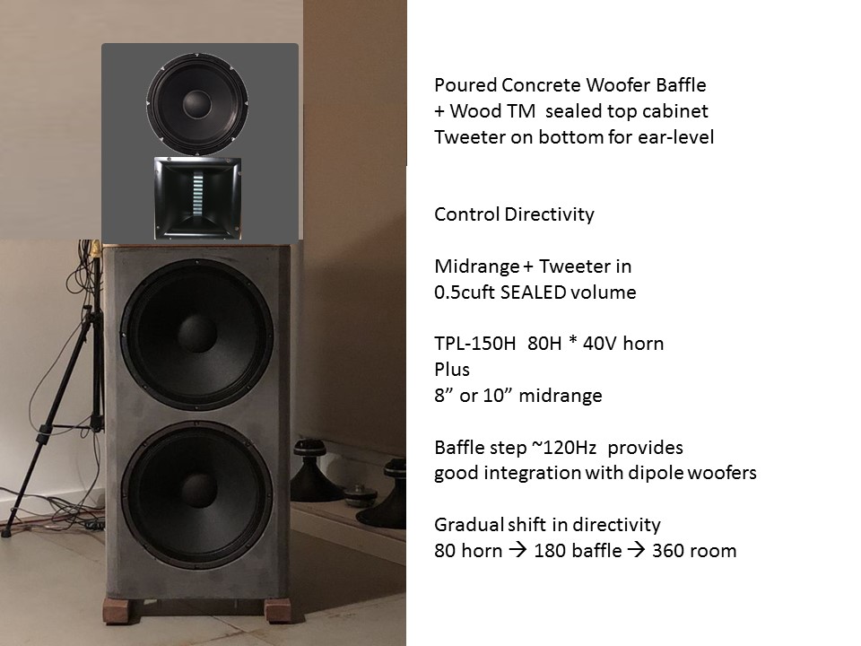

Both dipoles and horn designs control directivity to reduce early reflections from hard walls and floors. Draw your room floorplan and overlay Left+Right horn 80-degree H-polar patterns directed to the listener to see if early wall reflections can be reduced. A tweeter horn with a 40-degree vertical polar pattern will reduce early reflections off your hard floor and low ceiling.

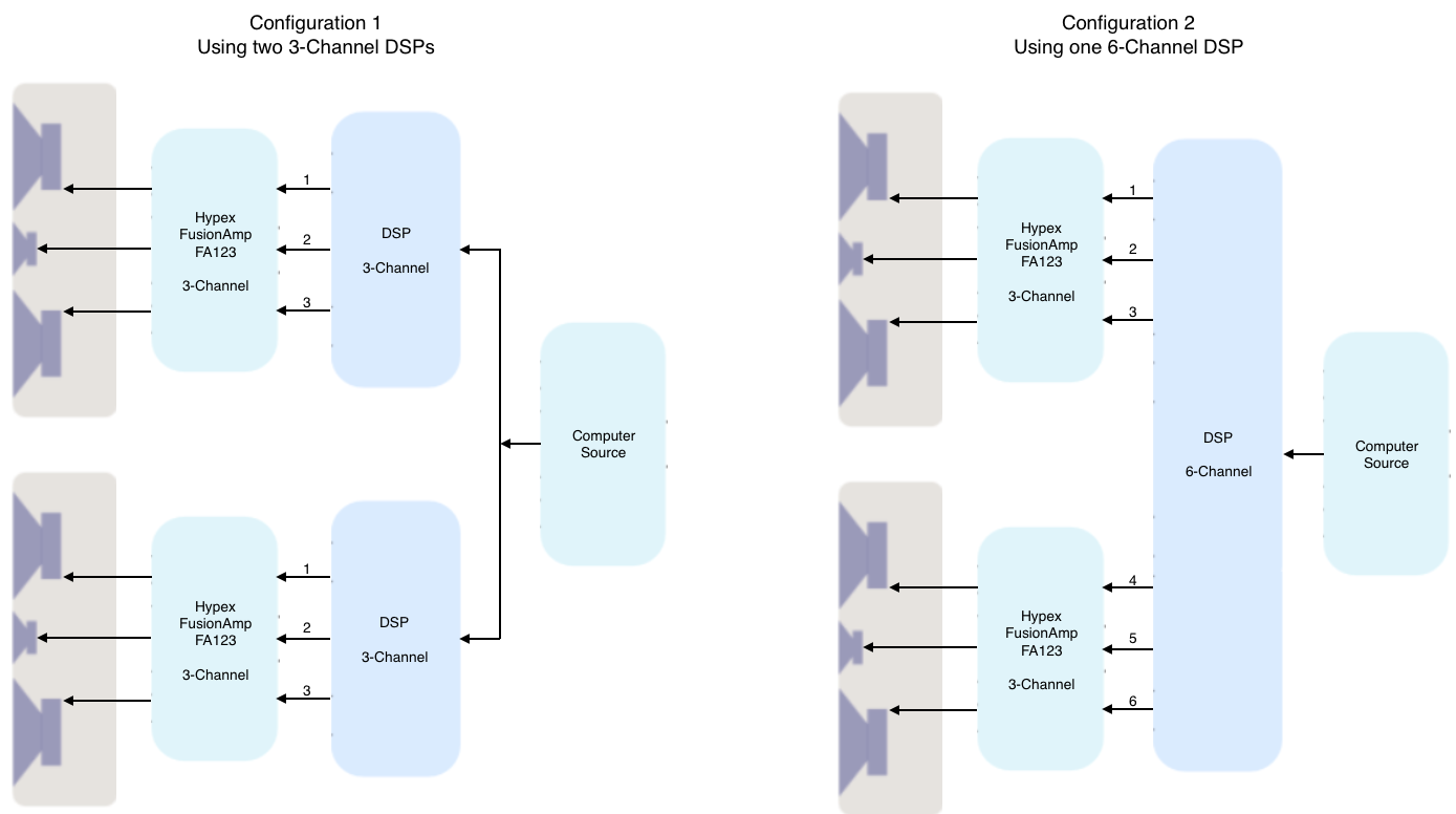

Progress!
The Hypex Fusion FA123s arrived.
Amps mounted to the base of the open baffle speakers.
Hypex Filter Design software loaded to a "new" PC laptop.
"Master" amp and crossovers configured (these will need a bit of tuning).
With just one speaker playing and no room measurements yet, the project has begun to sound very promising!
Some background for a few more questions...
As I stated early in the thread, I use a Mac Pro as source for all digital music.
I currently connect the Mac Pro to the "Master" FA123 (just the first one I've configured) by a TOSLINK fiber optic cable.
Source to amps connections?
It appears that I can hook up the speakers by using a splitter on the end of the TOSLINK cable and then run two short TOSLINK cables from the splitter to each FA123.
Rather than that, does anyone know if I can go from the Mac Pro - TOSLINK - Master FA123 - S/PDIF - Slave FA123?
If they both work, does one have any advantage over the other?

...does anyone know if I can go from the Mac Pro - TOSLINK - Master FA123 - S/PDIF - Slave FA123?
This works.
