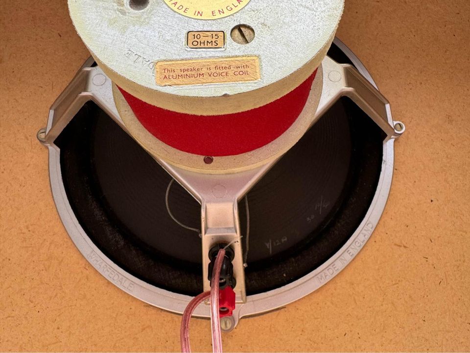

I have the opportunity to purchase a pair of Wharfdale Super 12 RS DD full range speakers . Would they be suitable in a two way open baffle design.

As a midTweeter. With helper bass driver.
If it has the same metal foil dustcap, that should probably come off and phase plug intalled.

This driver looks to be happy in a ported cabinet. A Q that low means it might be fine OB if you add a woofer like Dave says. Without, there will be no bass.

For the price offered I might get better value from more modern drivers. I’m looking to possibly go 3 way.

The Super 12 probably offers better dynamics and more ensitivity but even the cheap CHN-50 probably sounds better, and the CHN-110 sounds good and would bring better dyanics than the baby one, If the budget is large they still have some of the fabled MAOP 10.

In an OB with woofer support the XO to the midTweeter is high enuff (dictated largely by the baffle width) that smaller i a big asset.
