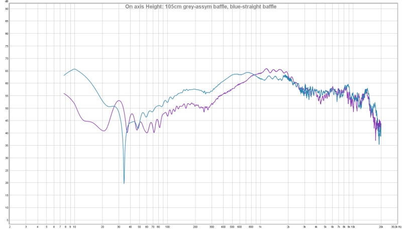

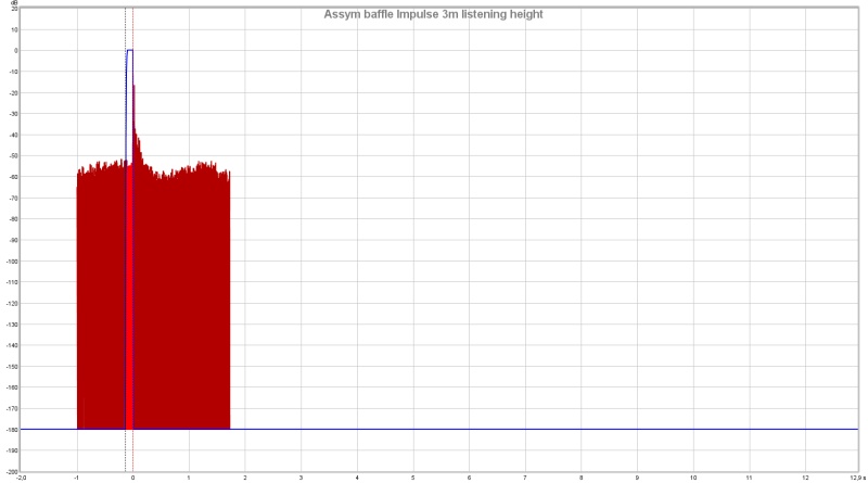

Yes, I suppose so. It's about finding the right cover i guess. But still - any opinions out there on the combination array/assymetric baffle sides?
Progress!

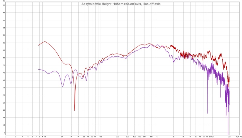

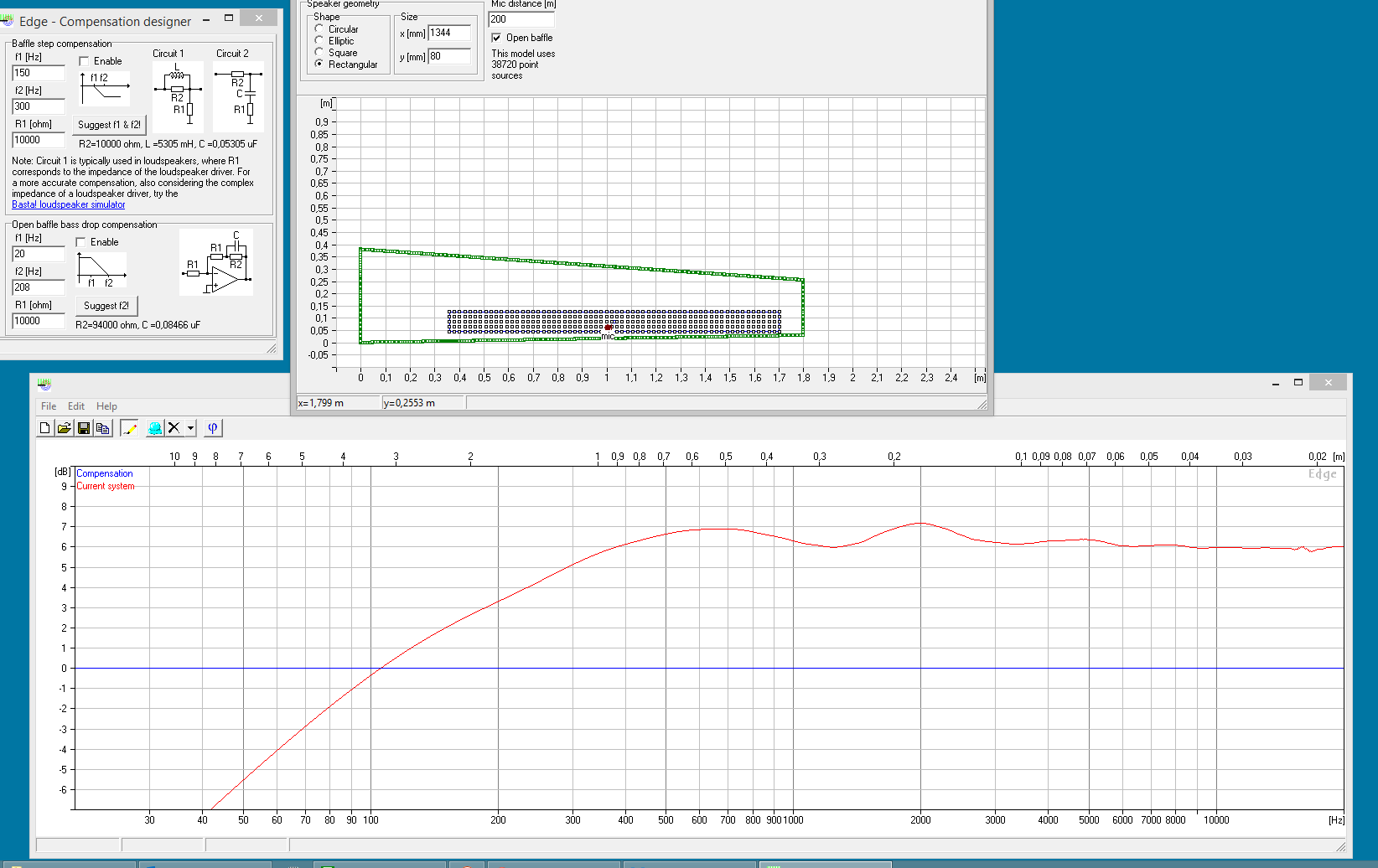

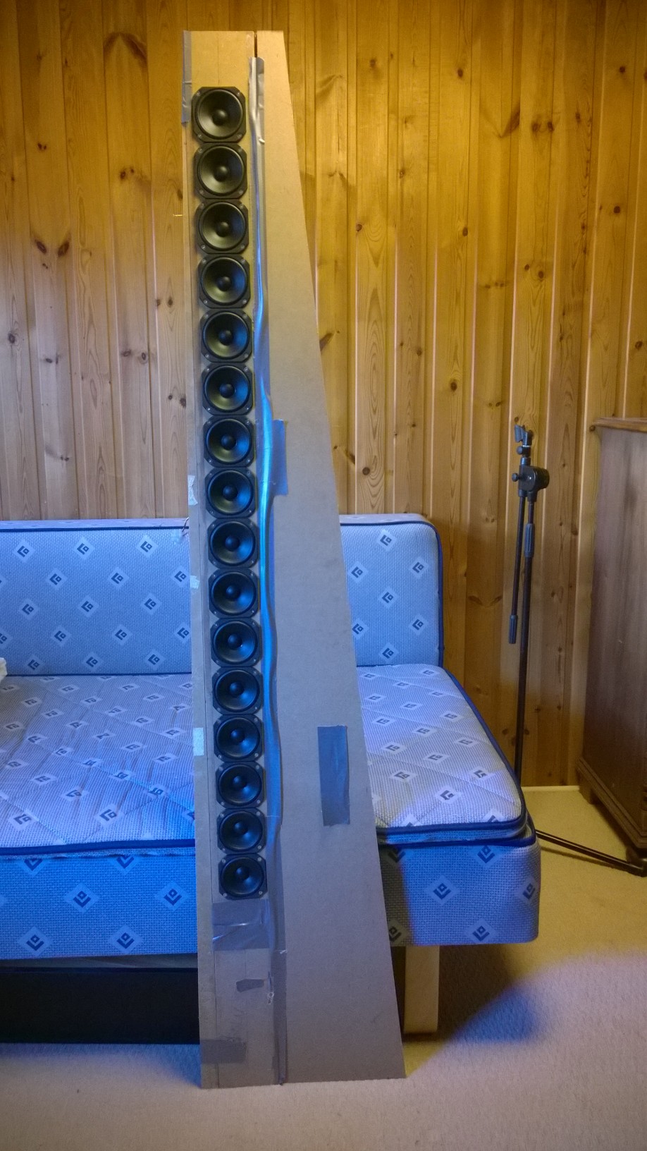

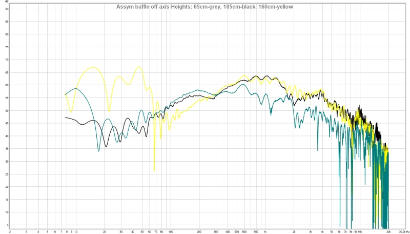

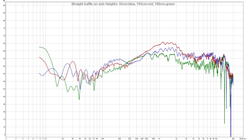

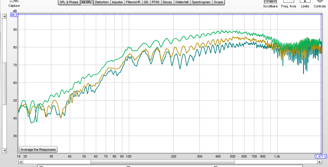

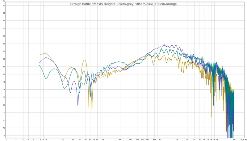

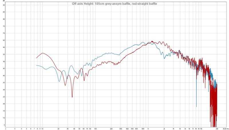

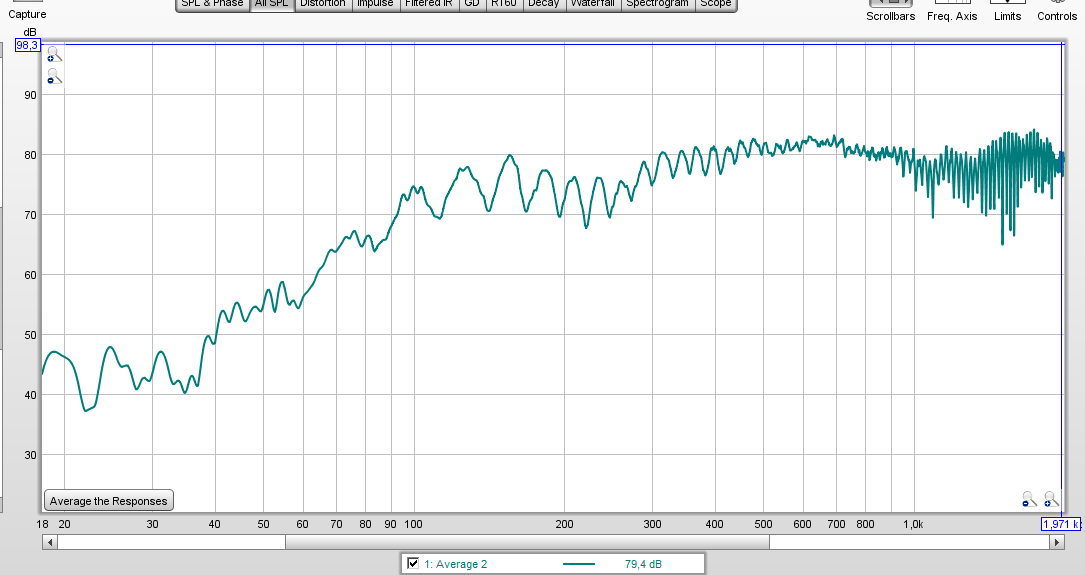

Now I have abandoned the assymetric baffle shape for a more traditional. It's still dipole/open baffle and new dimensions are: 180x26cm. The array is offset so cc of the driver to the small side is 8cm. I've experimented before quite a bit with different sizes and offsettings, and became so fond of the (possible) soundstage with one very small side (facing towards center). The more centered array on the baffle, the less depth was my impression. So aiming for this I came up with these dimensions in edge. It's made to get a good dispersion as high as possible and still not loose too much bass. So according to the excellent paper of Rudolf Finke (thanks Juhazi), off setting is a good way of handle things when the baffle needs to be a bit more than 3 times the driver size. Maybe you gain a bit both low and high then?
So, big questions are:
1. Will this be ok from about 100-200Hz up to 4Hz EQ'ed?
2. How to think about the small vs the broad side? Good or bad with offset?
3. What sort of filter/EQ (if this is a good start)?

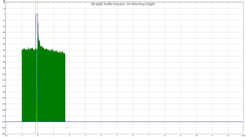

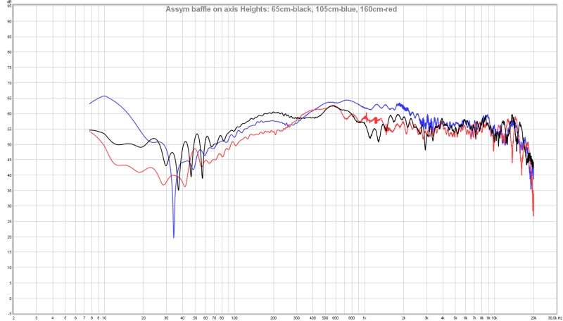

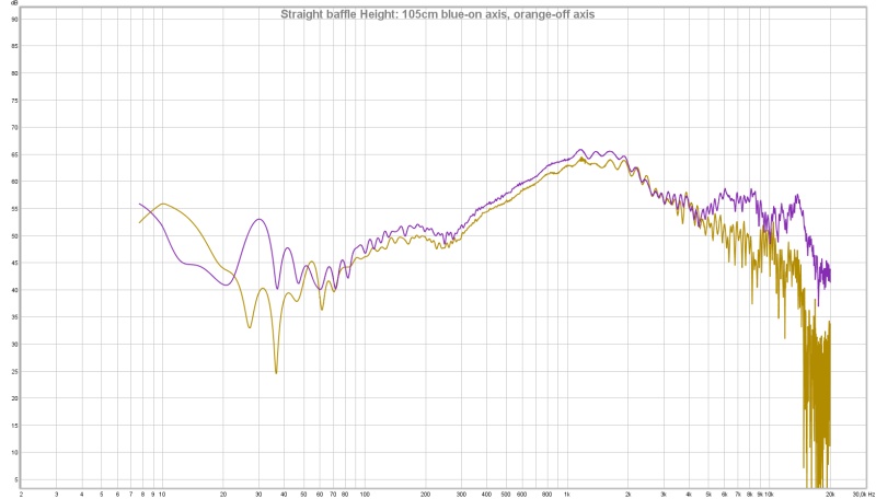

Measurements as before (UMIK-1, REW), outdoors, 3m.
0-90 degress small side:
0-90 degress broad side:
on axis+15 degress off axis on small and broad side:
Any other comments or ideas are welcome!

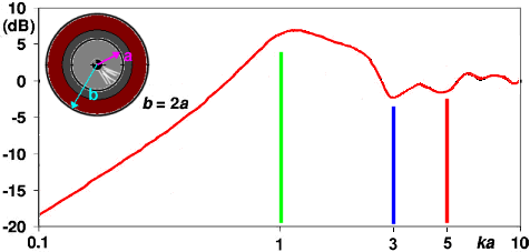

It wasn't until around 2010 that processing power allowed sims for dipole radiation on and off axis to be generated. At that point it became evident that the less baffle the better. I remember precisely when Linkwitz published the sims on his website for a driver in free air vs baffles of different widths. It was the data so many of us had wanted for many years. Figure A3-5 on this page. Linkwitz models More in depth analysis was added in the years that followed.
Excerpt A3-5 'The data are presented as frequency normalized on- and off-axis response curves for different radius of the flat baffle.
I thank Tim Mellow and Leo Karkkainen for generating the graphs, which required many hours of computer time. The graph for b=8a had to be truncated at ka = 5 because each data point took hours to calculate. The curves approach the infinite case.
Leo is still experimenting with ways to speed up the calculations for a piston in an open rectangular baffle of specified aspect ratio, which turns the analysis into a 3-dimensional problem. They have derived exact formulas, but the computational effort is immense.'
