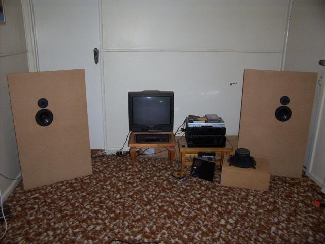

I've just recently finished my dipole speakers, I'm very impressed with the sound (as are my friends). I used Peerless HDS tweeters (810653) and a pair of Phillips PRS 602 6 1/2'' mids ,a cast frame 4 ohm ex-car audio speaker (don't laugh)
The mids were extremely co-operative in dipole and needed no x-over what so ever, and the Peerless tweeters got away with a single series 2.2uf poly cap.

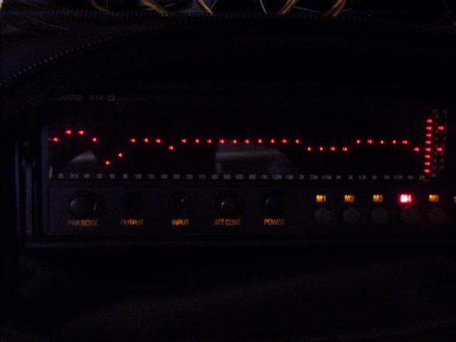

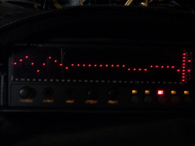

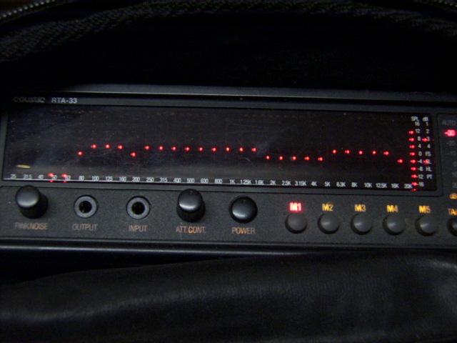

I'm getting a +-3db response from 80hz to 20k, pretty stoked with that, so I decided to add some active bottom end, and that's where the problems started.
I have an 8'' sub in a TL (can just be seen behind the electronics and under the telly in the attached pic) that's powered by a plate amp with switchable 0-180 phase (as well as gain, freq ect) but no matter which position phase switch is in I get a huge chasm at 50hz (response pics will follow)
I initally thought it was some weird interaction between the TL and the dipole speakers so I quickly rigged up a 12'' in one of my sealed test enclosures but ended up with the same result.
Now granted with just the sub alone the "room" is a bit weak at 50hz but no where near the dip that happens with the dipoles running.
Thoughts?

The response curve is typical of a wave re-enforcement/cancellation.Its primarly a room condition, but a phase change should (<--keyword) solve the problem.

I have measured the sub (both sub setups) and while there is a dip at 50hz the dipole speakers seem to make it worse, regardless of phase.

Yea, i looked again at the curve.The peaks appear to be almost 1/2 octave (first peak x 1.414) to the bottom of the adjacent null.Without exact numbers its hard to calculate.

You've got your problem solved, it seems, but if I could suggest: you've got your dipoles in corners. This is not the optimal way to run them; dipoles need room to breathe. I suspect that if you move them away from the wall and leave the sub under the TV or something, you'll get a better response.

Yea thanks, I've moved them further out from the corners, about 4' now, that's almost got rid of the slight male voice resonance that was the only other issue I had, I'll continue to experiment and probably re-arrange the listening area to give me the area to space them properly.
