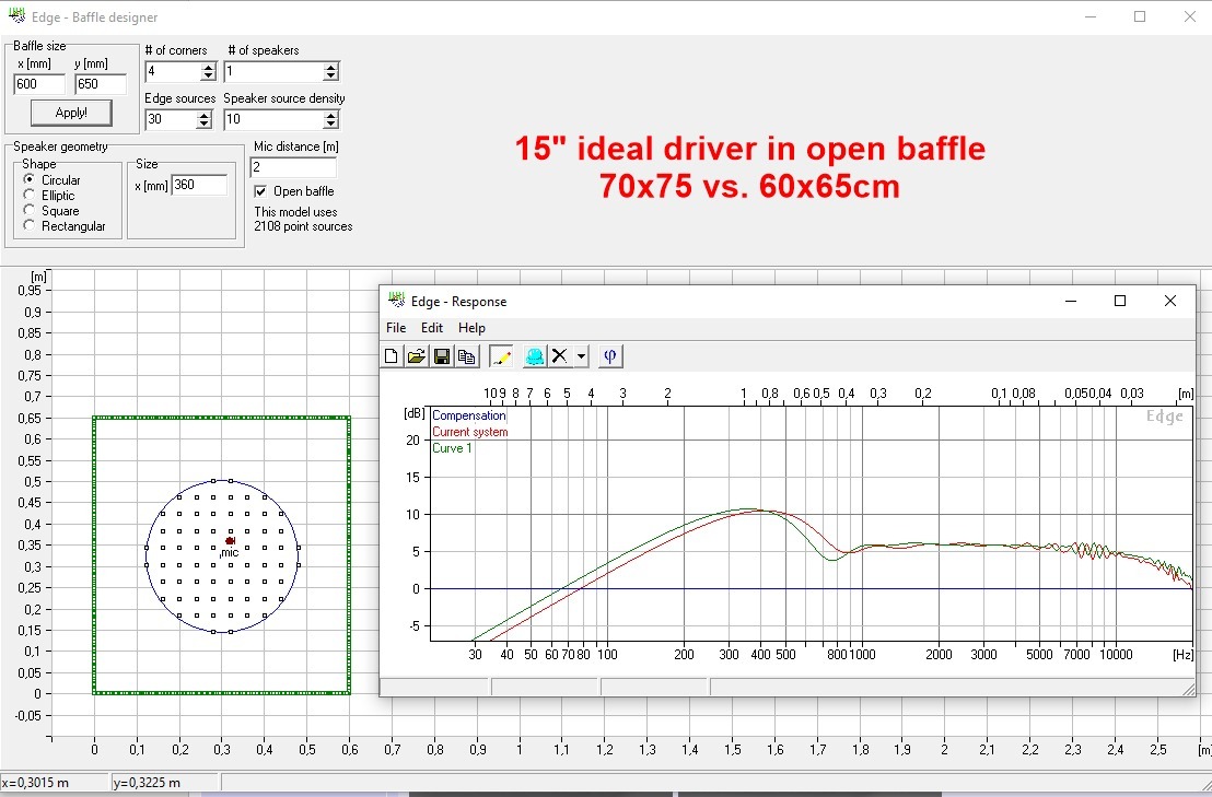

I am looking at building some open baffle speakers with the Lii audio F-15s and am trying to decide on baffle dimensions. I will be listening quite nearfield and am limited on space between the sidewalls, although have plenty above and behind me. so I was thinking of a baffle size of 70x75x4cm. Ideally this would be smaller, something like 60x65x4cm.
Would there be an appreciable difference in bass response between these two baffle sizes?

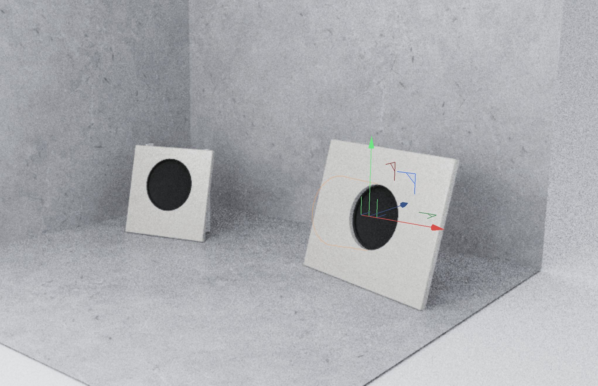

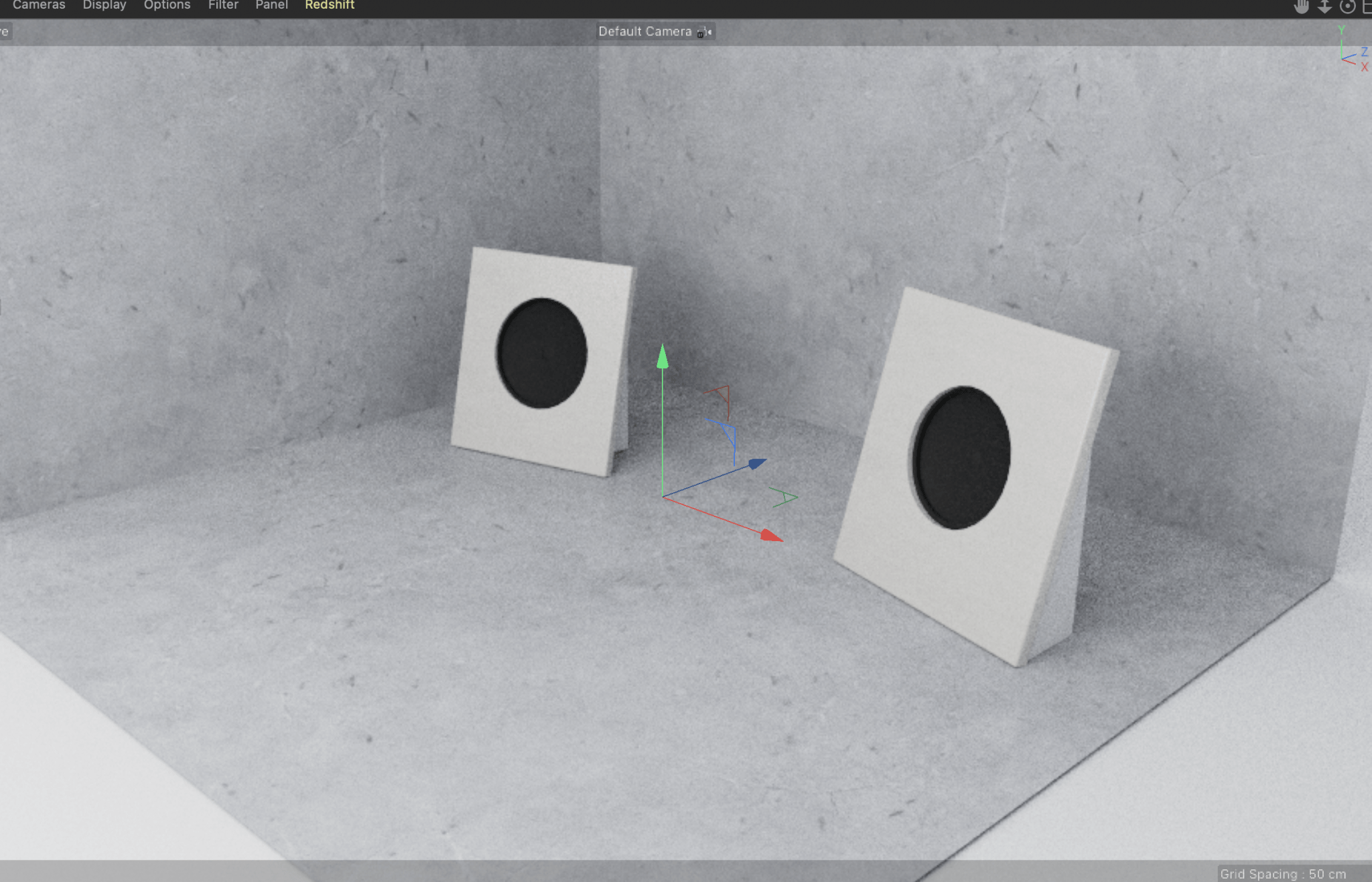

Quick mockup attached of the various sizes in relation to my listening space for comparison

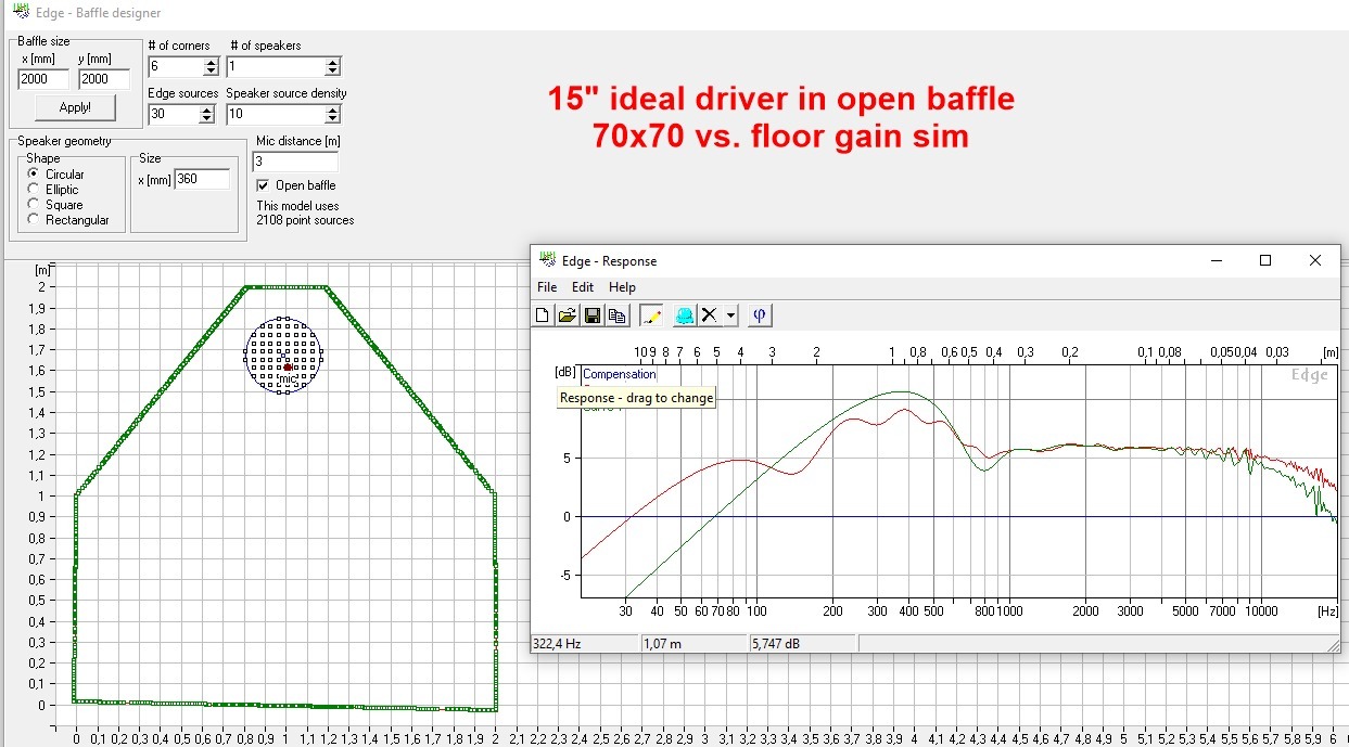

With smaller panel you will loose 1dB in bass. With doubled dimesions you will get 5dB more bass.

I attempted to simulate floor gain, when baffle is tightly on the foor. IRL one must add front wall reflection to the sim, see Kreskowsky's papers http://musicanddesign.speakerdesign.net/Boundary_reflections.html
so is that the red line with floor gain? it's about a 5db bump up at 70hz? How do we interpret that chart?

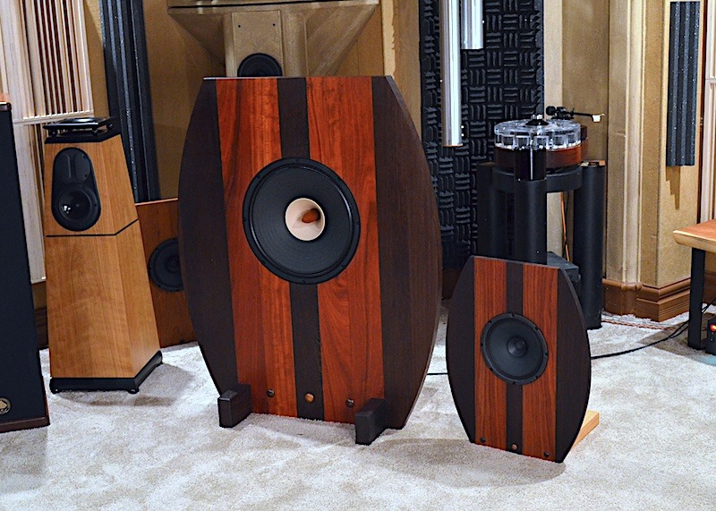

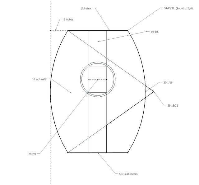

An example in that small barrel shaped baffle with 8" driver in the video above. The guy (Randy) who invented, or discovered, that size and "barrel" shape tried many different baffle shapes and sizes before settling on that one that sounded best overall for that particular driver - the Wild Burro Betsy 8".
Yes you will get higher bass output and more extension with a bigger baffle but other aspects of the sound - eg. soundstage/imaging - can suffer.

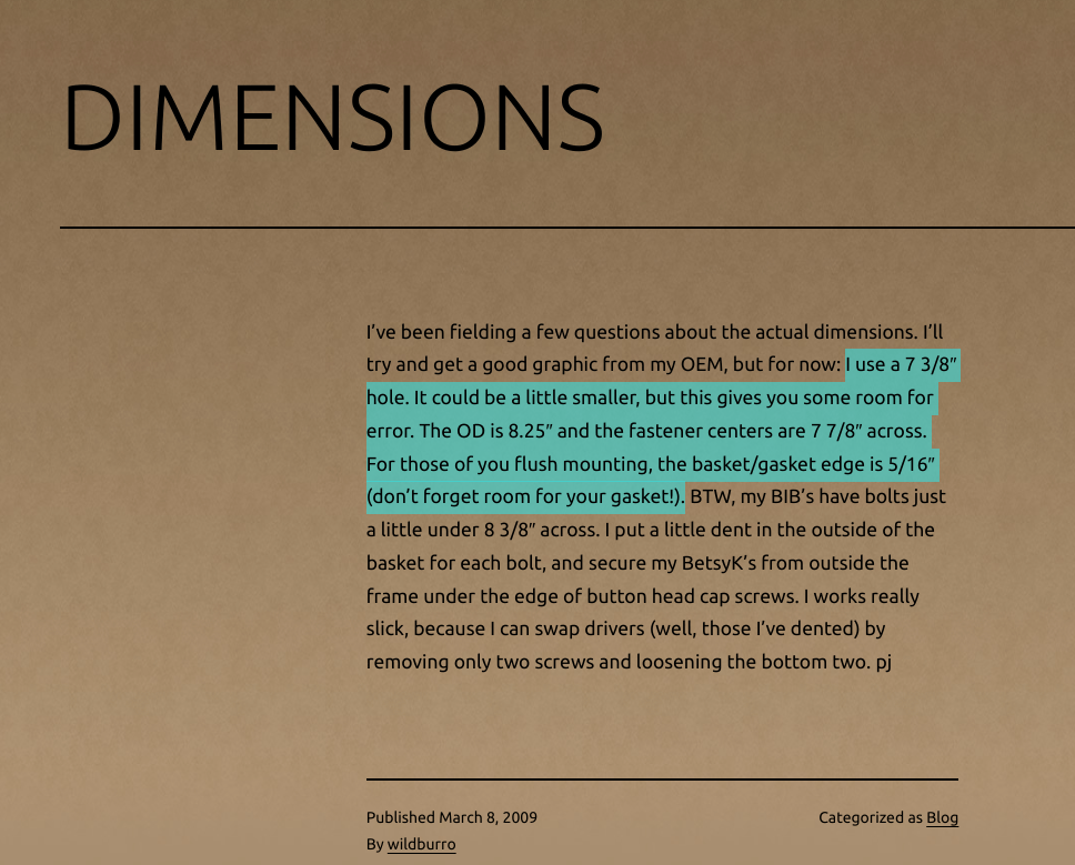

Gnat, any chance you have the 8” Betsy dimensions? Cheersa good start is prob the "Big Betsy Baffle" that Decware uses...
you can experiment with lean back (5 degrees?) with spacers under the front.
I see I completely misinterpreted what I was seeing higher up the page. I thought the baffle was for a larger driver and I was chasing the 8” Bettsy baffle dimensions. Thank you for your efforts though! Sorry for not being clear enough.
ah here's one better...Wild Burro Betsy cutout dimensions.
yeah there are two "barrel' shaped baffles, the small one "Betsy" is for an 8" driver.I see I completely misinterpreted what I was seeing higher up the page. I thought the baffle was for a larger driver and I was chasing the 8” Bettsy baffle dimensions. Thank you for your efforts though! Sorry for not being clear enough.

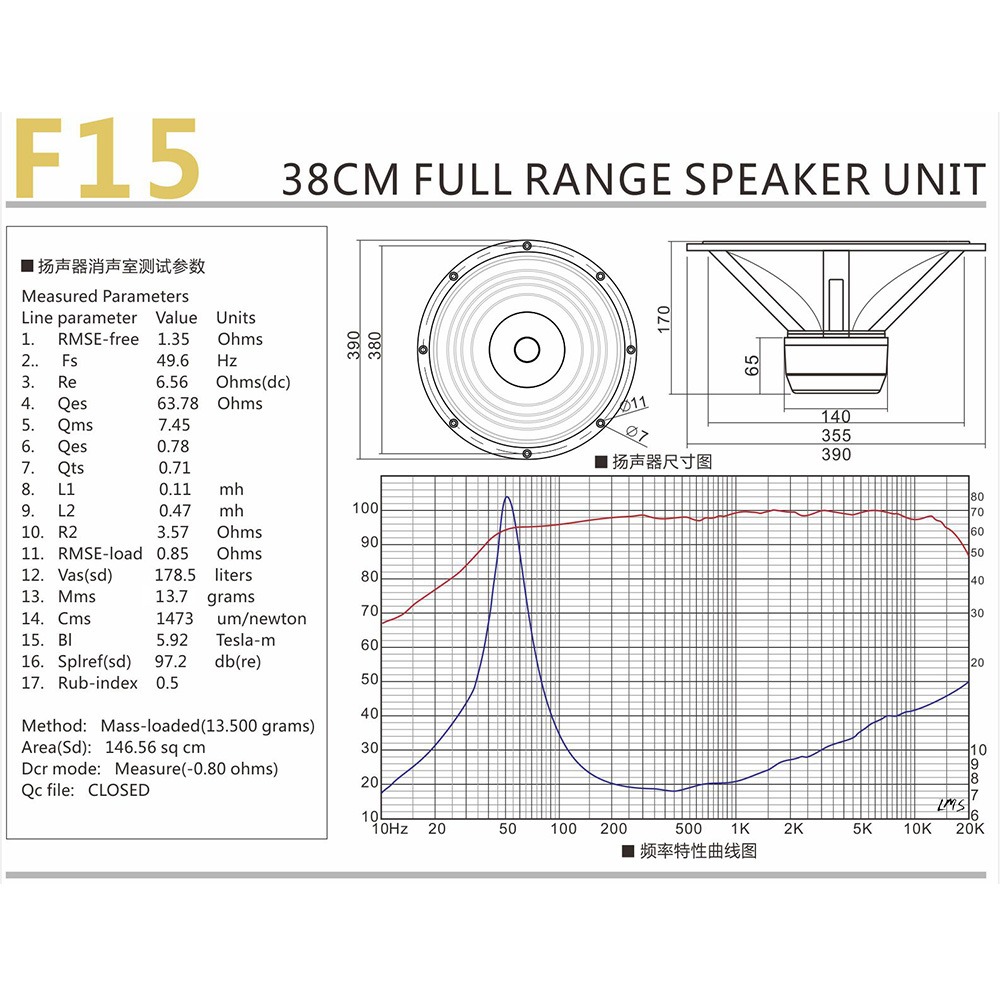

The other one that Decware sells - I think - is for the Lii Audio F15 fifteen inch driver.
Dimensions are in the spec sheet below.

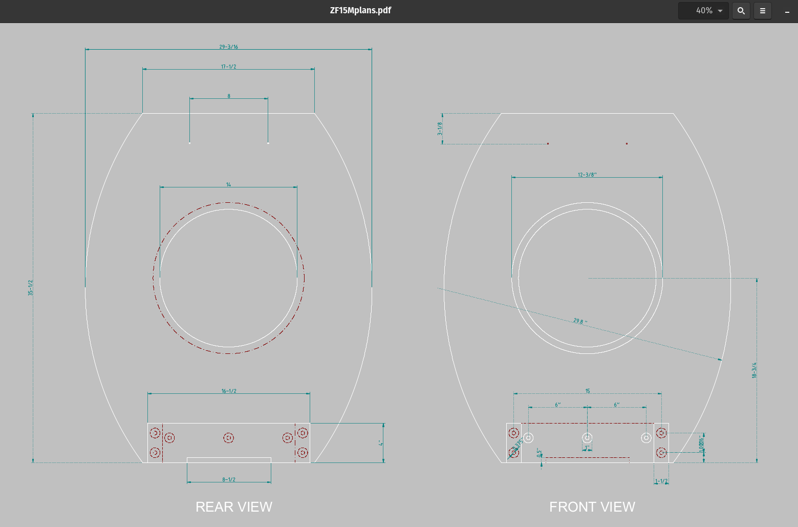

Now let me see if I can even find the drawing for the 15" barrel baffle. I'm not sure if I even have that one.
Here is the prelim plans for the Decware OB for the Lii F15 driver you can see it's nearly 30" wide at it's widest in the middle of the barrel shape, so twice the size of the driver. Btw, you can buy the final plans on the Decware site for $30 here, but I think these prelim ones I downloaded off the Decware publicly available forum is sufficient. Just so everyone knows I'm not giving away anything they are selling.

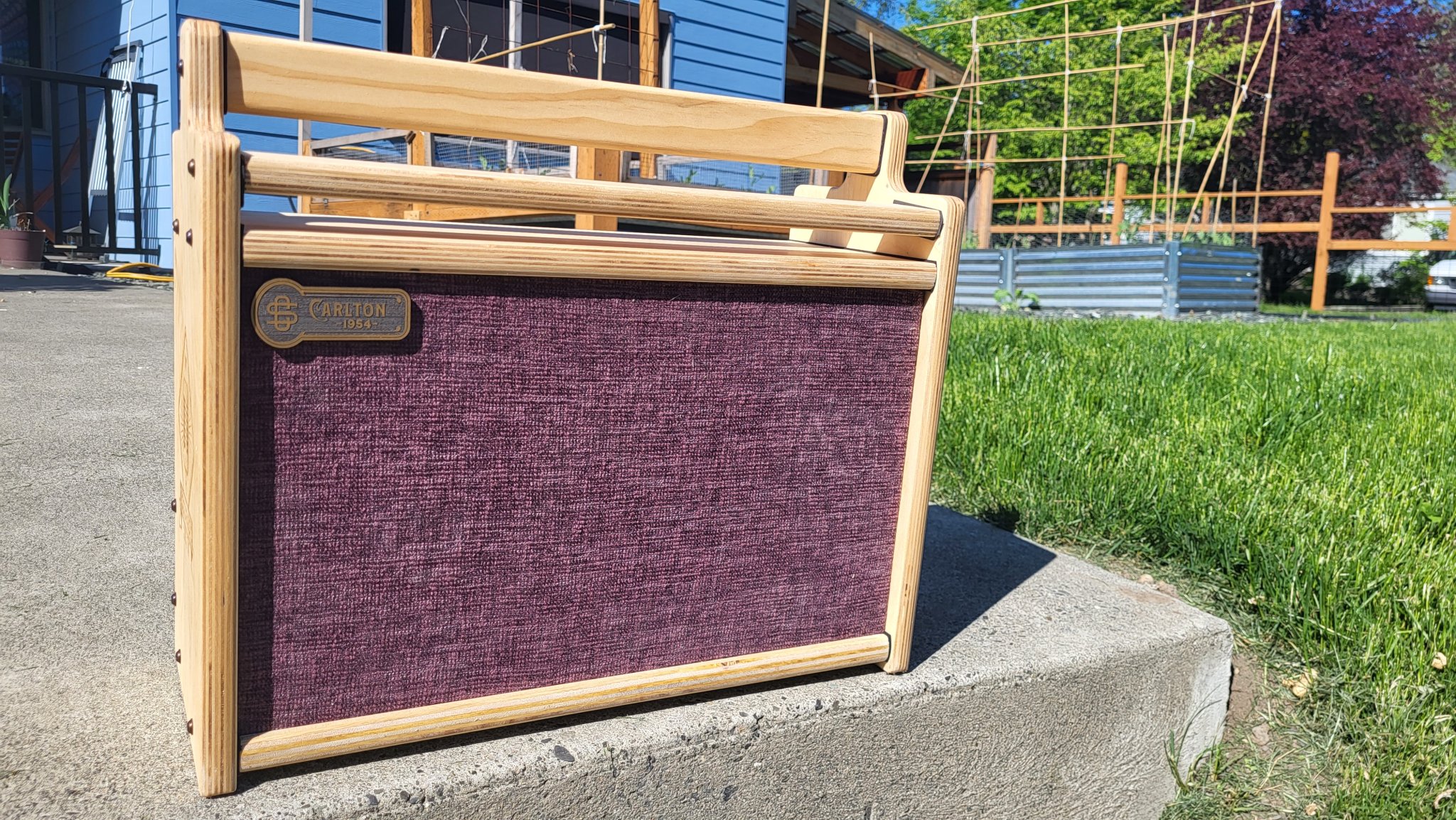

I love the Betsy driver. Here is my project.
Guitar amp, Open back box so open baffle, 1 inch dome tweeter assist, ADU1701 DSP fully equalized using Sigma Studio Auto equalization, one class D amp per driver. Frequency response is in room after equalization. Simply wonderful sound.
