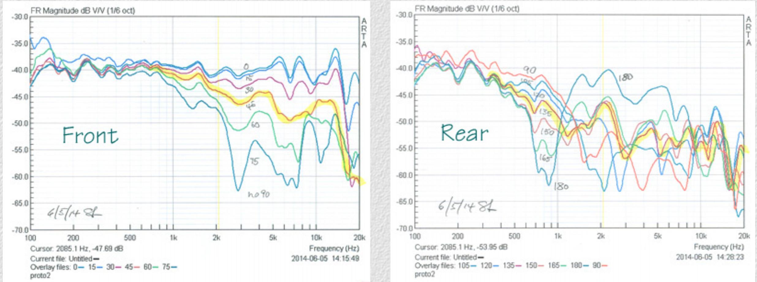

LX-minis are cardioid in the midrange bandwidth, peaking around 700 to 1,000Hz, I believe. See the Linkwitz LXmini design page.
The 4" is in phase with the 6" to the front and out of phase in the rear. The combination of the two drivers operating out of phase cancel to the rear throughout the crossover frequency range (e.g. noise cancelling.)
The destructive frequency interference also creates a narrow horizontal pattern to the front -- somewhat like a waveguide?
An open baffle radiation pattern is different. It is equal to the front and the back. Consequently, OBs can be more sensitive to room placement -- you normally pull them out in to the room away from the walls.
So, is your center channel going to be placed 3 feet in front of your TV? If not, you might not want an OB. Instead, you might want cardioid. Or you might want fully enclosed. Or you might want to mount it flush into your wall.
For a center channel, you might want to build a Linkwitz Pluto converted into a standard enclosure (aka, woofer assisted wideband or a two way with lower crossover frequency at 1,000Hz) then place it on your wall above, below, or even to the side of your TV. The Ventriloquism Effect will take care of moving the voices to the center of the screen.
