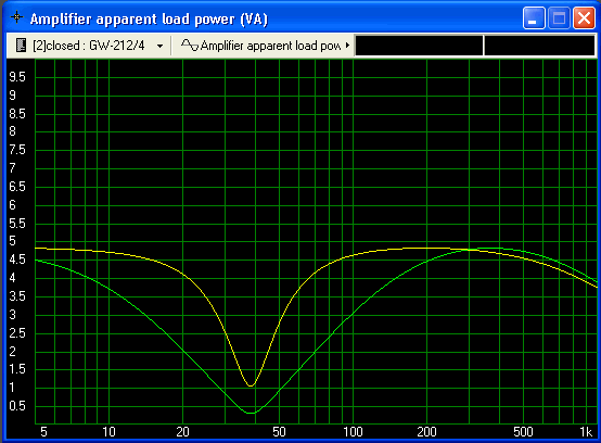

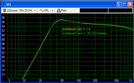

Let's take that Goldwood you linked earlier with a Qes of 1.4. The yellow line is the SPL in an infinite baffle with 5 watts nominal which is enough to push it to Xmax. The green line is an identical driver except the magnet is twice as strong giving a Qes of .35. EQ is applied and the power adjusted so the curves line up pretty well.
Now look at how much power the two drivers are actually using to put out the same SPL. The one with low Q plus EQ is using less than half the power at most frequencies. At Fs, they both use about the same power.

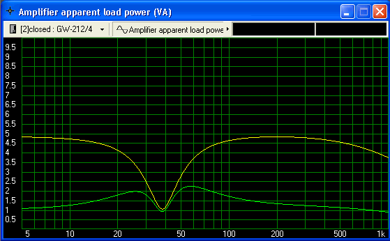

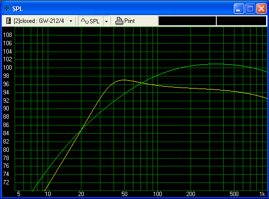

Let me try a different approach. I guess it comes down to how you define efficiency. It's true that the higher-Q driver will have higher voltage sensitivity (SPL/2.83V/m) at a few frequencies. Here are both drivers with the same input voltage and no EQ.
But let's look at the actual power being used (VA). The low-Q driver is using much less power.

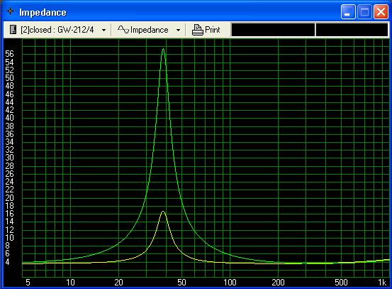

The reason is the higher impedance of the low-Q driver.
So, if you are mostly interested in the voltage limits of your amp, the high-Q driver might be better. But, if you are interested in the amp's current limits, the low-Q driver might be better. You really need to look at excursion vs. current vs. voltage as Linkwitz does rather than simplifying things too much.
