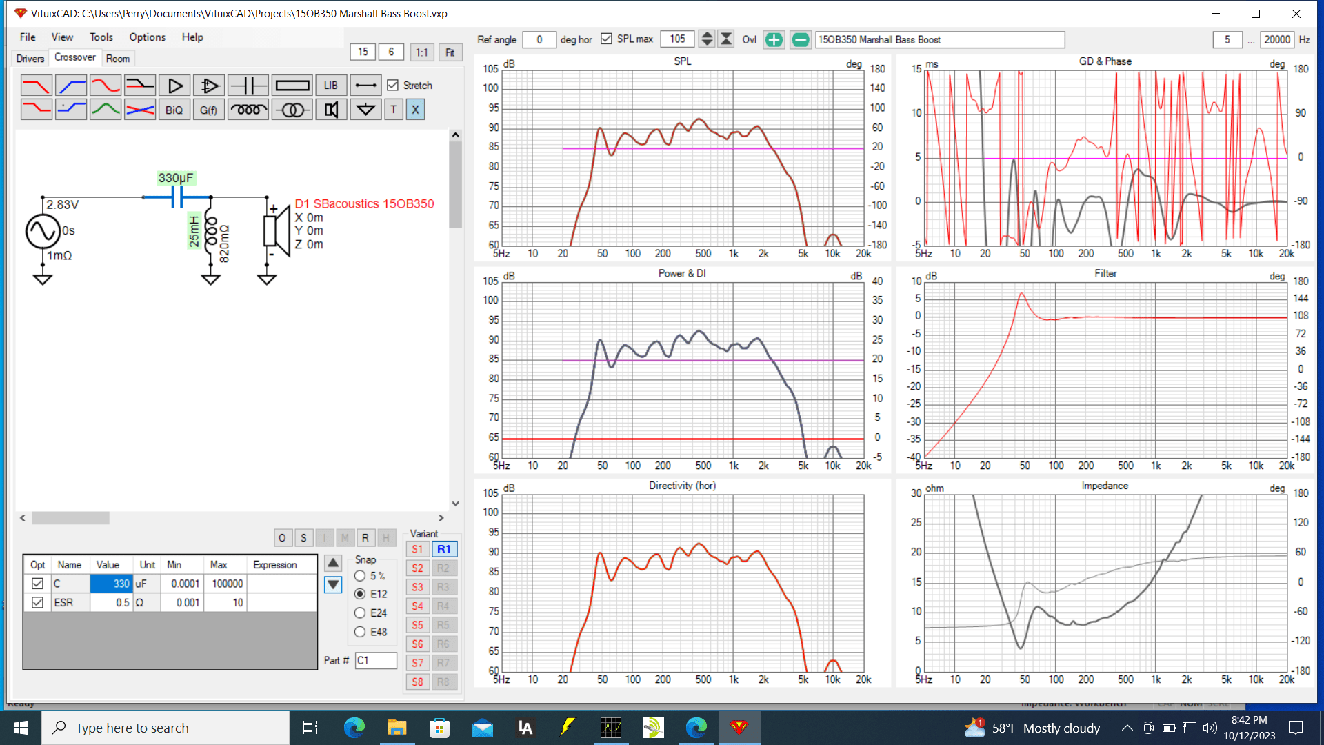

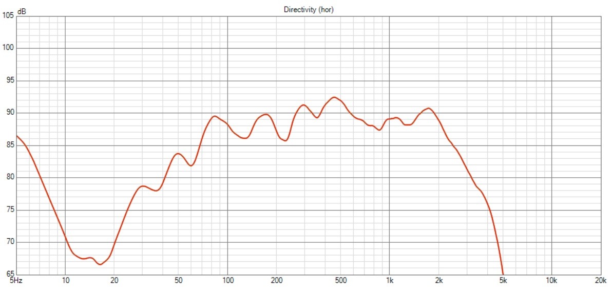

My Bitches Brew speakers use a 15OB350 woofer so I disconnected the middle woofer, measured frequency response and impedance of the middle woofer only and put that data into VituixCad. Below: There is no EQ applied to this woofer. This is crude 1/3 octave data, in my room about 1.5M away, in the Bitches Brew Open Baffle enclosure:
The main point of this graph is the dipole roll off below 70Hz. The measurement is not 2.83V/1M, so the dB SPL numbers are relative.
BELOW:
With 330uF capacitor and 25mH inductor.
This filter gives +6dB boost at 45Hz, impedance minimum of 4 ohms, and f3 of around 40Hz. The 15OB350 looks like an excellent candidate for the Passive Bass Boost circuit.
These measurements aren't exactly an apples to apples comparison with the Walnut Dipoles but they are useful. I'd have to do a lot more experimenting to know whether the 450Hz peak is "real" or if it's just an artifact of my quick and dirty measurements. In any case the SB is a very good woofer with nicely behaved midrange and no breakup problems.

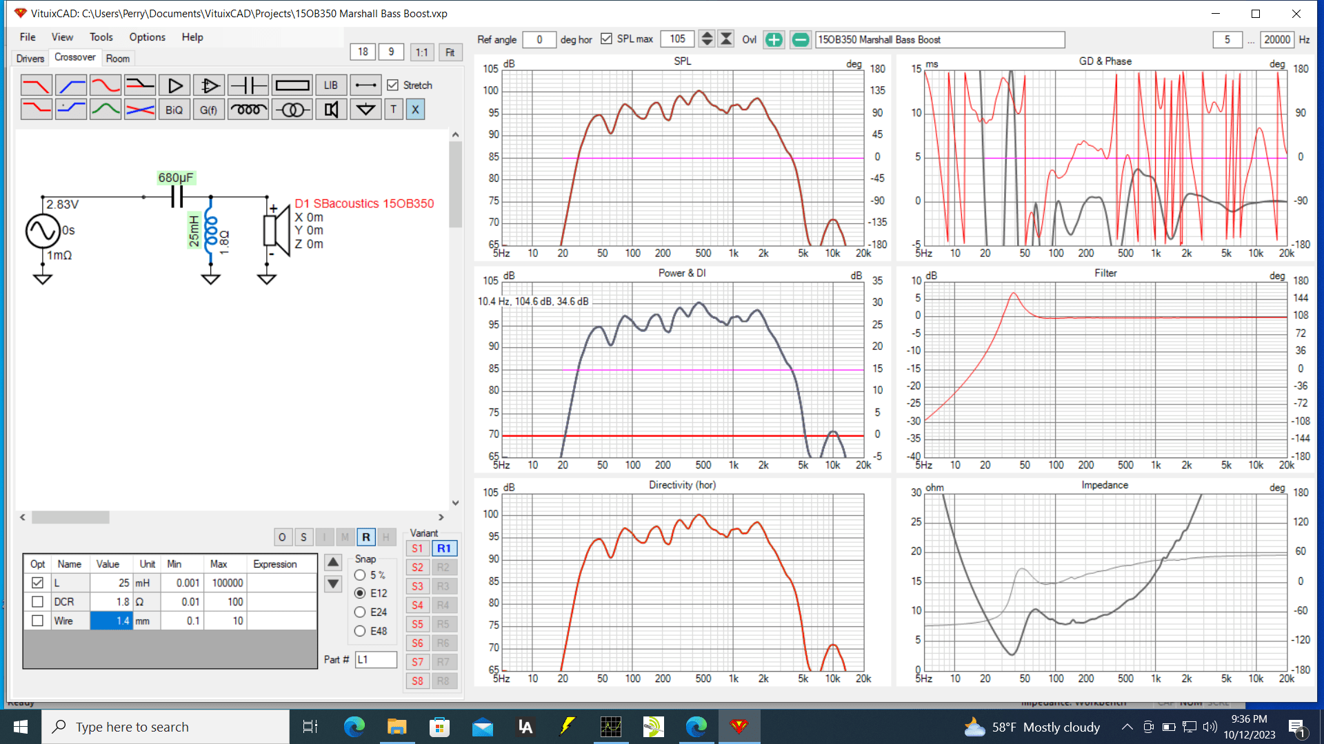

@Mitch311 The 15OB350 has a higher mechanical Q (Qm=12) which means less natural damping. Higher Qm means larger peak boost in the Marshall Bass Boost circuit and lower dips in impedance. It's not hard to get an 8-10dB peak with this particular woofer, and impedances that dip down to 2 ohms and below.
You run into that problem/opportunity with the 15OB350 when you try to push the boost frequency below 45Hz.
That's fine if your amp is OK with 2 ohm loads, but with this woofer I tried increasing the DCR of the inductor from 0.8 ohm to 1.8 ohm (which means you can buy a cheaper inductor, US Coils sells all different grades) so with a 1.8 ohm DCR I can push the boost frequency down to 40Hz with a Zminimum of about 3 ohms:
Here, the filter boosts response by 7dB. The cutoff point has moved down from 40Hz to 35Hz, and the SPL at the cutoff point drops a bit as well. Goes a little lower, and a bit leaner.
The point being that you can play with driver Qm and inductor DCR to find other useful compromises.
