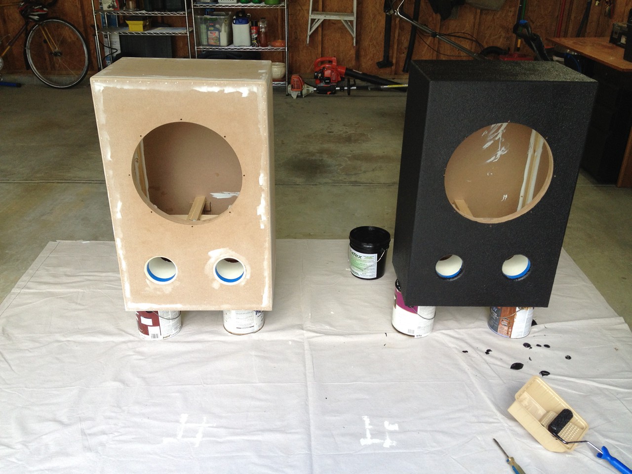

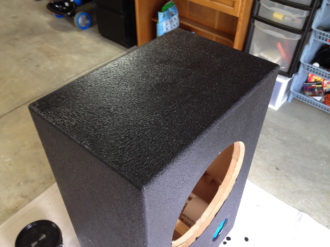

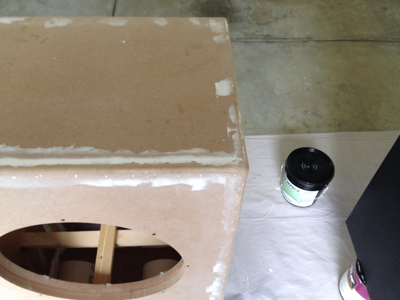

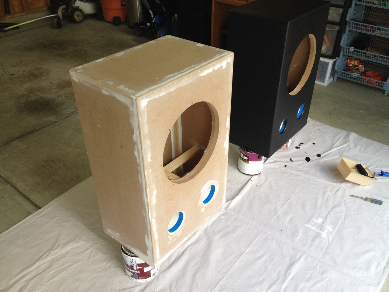

Finally getting back to these after a few months. I sanded the bass cabs down, routed the edges, filled gaps with vinyl spackle and coated with duratex. The duratex is awesome. Goes on easily, creates a nice finish and no priming required. Very highly recommended.

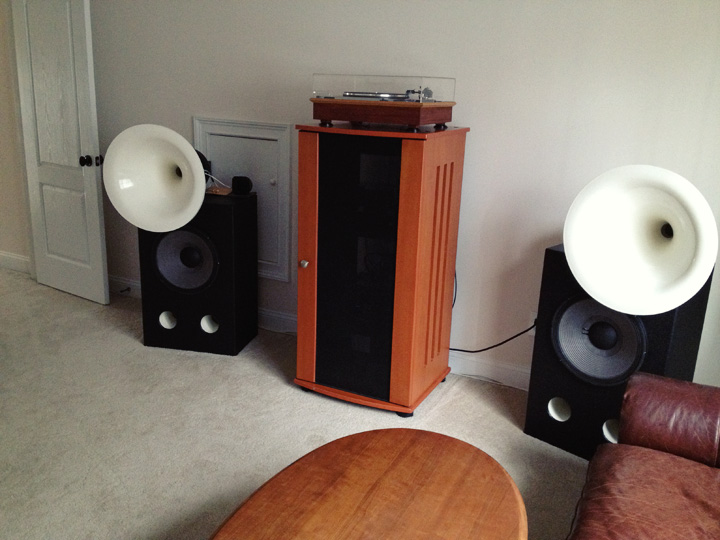

Here is how they look back up in my listening room. I still need to build a better mount for the 2" CDs and super tweeter. I want the midrange horn to be 10" or so higher and have the super tweeter mounted between the woofer and midrange. Next project...
Any ideas?
