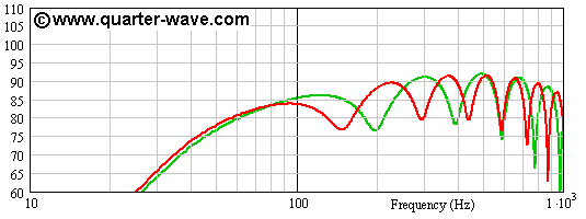

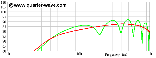

If your equalising is done there is still the room to consider. How free are you in choosing your OB-to-front-wall distance? Have a look at two sims:DAMIC said:Can anybody advise, whether U-frame or H-frame design is better for bass reproduction. Actually, I am in process to go for OB design ... and want to have deeper response as much as possible.
Red is the response of a driver on OB (working in principle like a H frame) without any front wall. Green is the same, but with a front wall at 90 cm distance. You "win" some efficiency between 40 and 130 Hz, but you loose below 40 Hz and will have to cross over at 100-150 Hz.
By varying the front wall distance you can "tailor" this response a bit:
Green line is the same as above, red line shows a front wall distance of 120 cm.
Since a U frame´s back wave is less pronounced it will have less influence on the end result.
PS: The simulations have been done with a now out-of-date version of MJKs worksheets. The trend will nevertheless still be valid.
