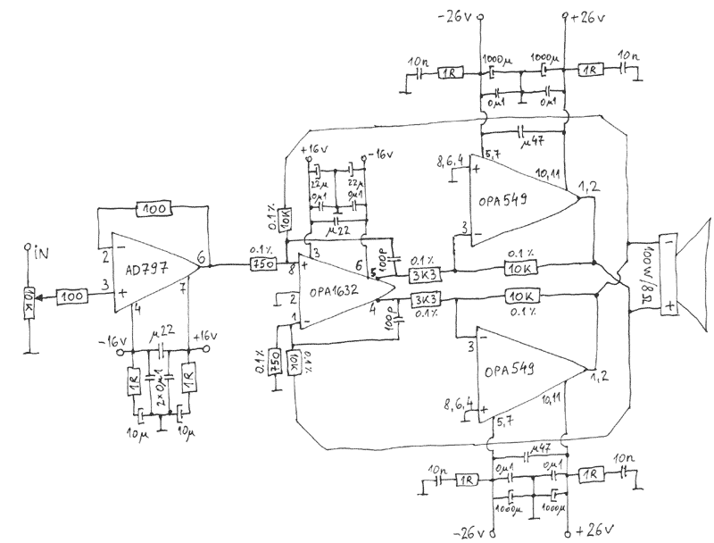

This worked great for me:
http://www.diyaudio.com/forums/attachment.php?s=&postid=980927&stamp=1155331765
A successful application:

...AD797, Is it stable in high gain applications?
Wrong question. The question is: is it stable at LOW gain applications.
Opamps get more stable at higher gains, worse at lower gains.
That is why datasheets sometimes specify a minimum gain for stability.
